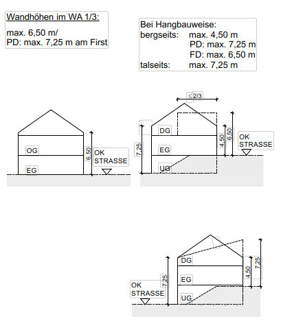

Is there a reference height for the house?The development plan states: "The wall height is defined as the measurement from the established ground level at the top edge of the street, reference point at the center of the plot, up to the intersection of the exterior wall with the roof covering, or in the case of a flat roof building, up to the highest point of the parapet."

If the original terrain drops more than 1.50 m (5 feet) at the building, measured along the slope line, then a building must be constructed as a hillside building with a basement and ground floor."
hanghaus2023 schrieb:
You seem to be planning much too high. Or did you mean the maximum wall height?
![grundriss-einfamilienhaus-155m-ohne-keller-3-kinderzimmer-1-buero-677927-1.png"]89368[/ATTACH]</blockquote><br />
So far, I have assumed that the left cross-section applies to my plot.<br />
[ATTACH type="full" alt="Architectural drawing of a house with floor plans and views of the attic, ground floor, basement, and roof](/attachments/89370/)
