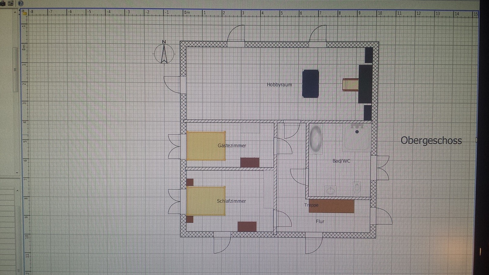

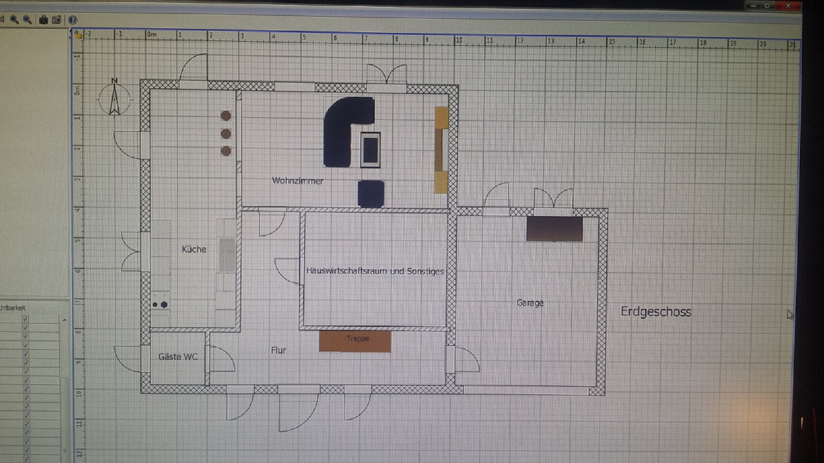

I am determined to have a turnkey house built. I downloaded the program Sweet Home 3D and played around with it a bit (photos attached).
My idea was to present these images to an architect so they can roughly implement the design and have the house built turnkey. No basement and a hip roof for solar panels on the roof.

1. What do you think of the design? Any suggestions for improvement, or are some things not doable at all?

Too much hallway space, narrow rooms, and what is happening in the kitchen with the three black dots? The staircase won’t fit like this, measurements are missing, and it’s unclear whether you can manage with a net budget of 2000 €.
Read a lot and redraw your plans at least 20 more times—or go straight to an architect (if you don’t have the time).
derstefanm2 Mar 2015 21:50How many full storeys does your design have? If there aren’t two full storeys planned, the staircase won’t work properly. Also, I noticed that all the windows open outwards in the wrong direction, as do the room doors. This needs to be taken into account during the planning phase.
derstefanm2 Mar 2015 21:53Now the ground floor can also be seen, and I have to say I don’t find the layout successful. The proportions don’t fit. The kitchen is so narrow and long. Hire an architect who designs a floor plan according to your needs and possibilities. As a guideline, with a net budget of 2000, you can expect to cover about 220,000 to 230,000.

This still looks very amateurish. The staircase doesn’t fit, the bedroom is far too small for a standard double bed with a wardrobe, and there is a long, impractical hallway leading to the living room. The kitchen can only be accessed through the living room and feels too narrow.
