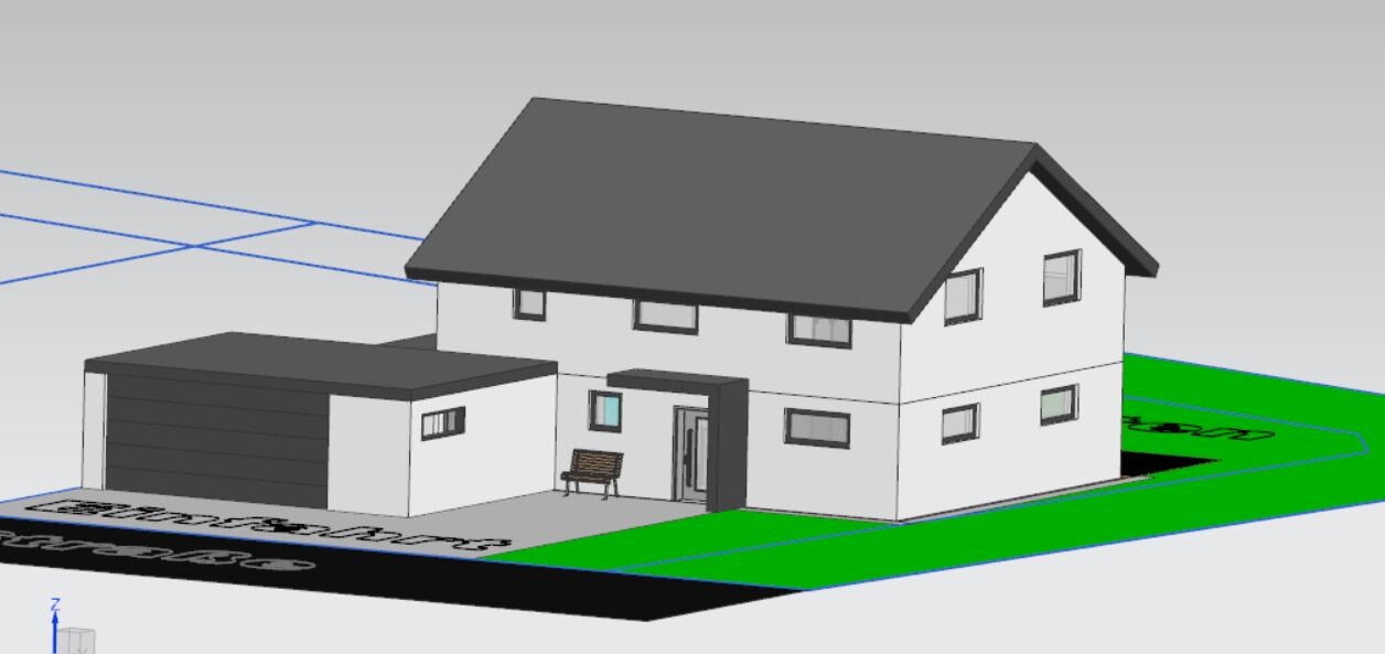

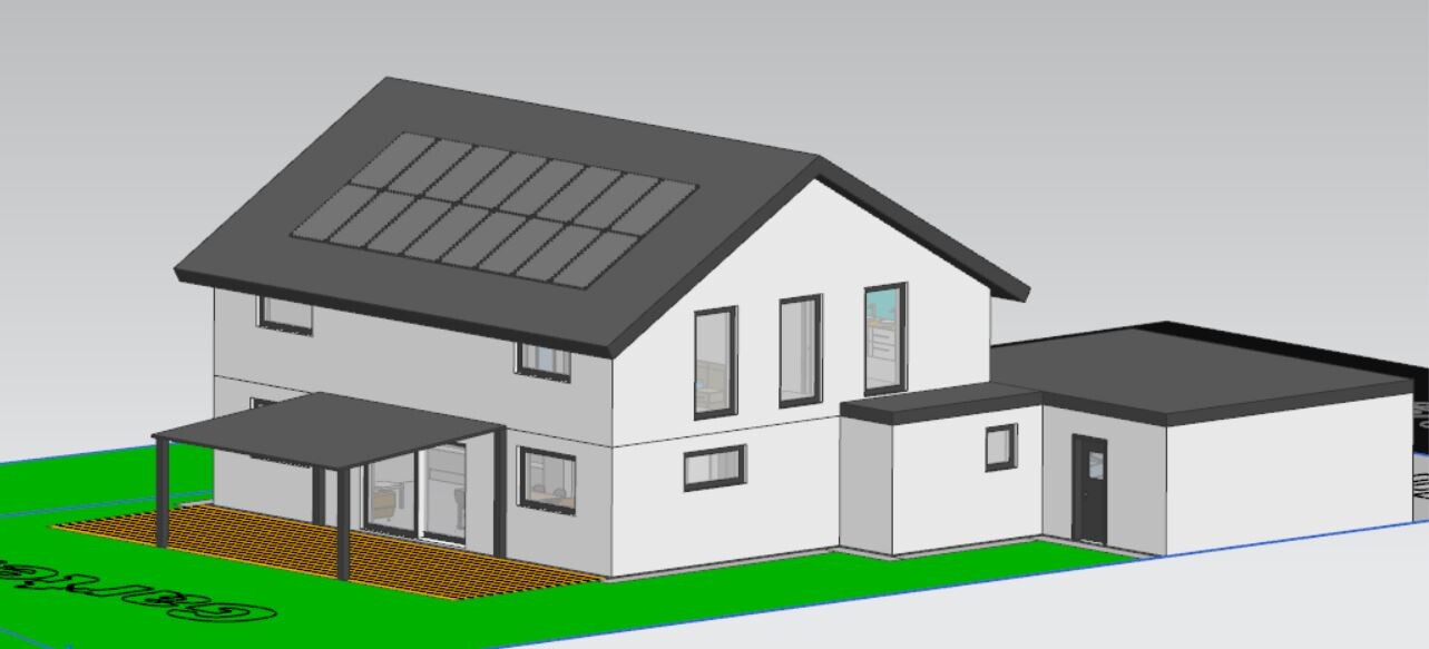

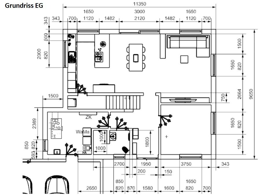

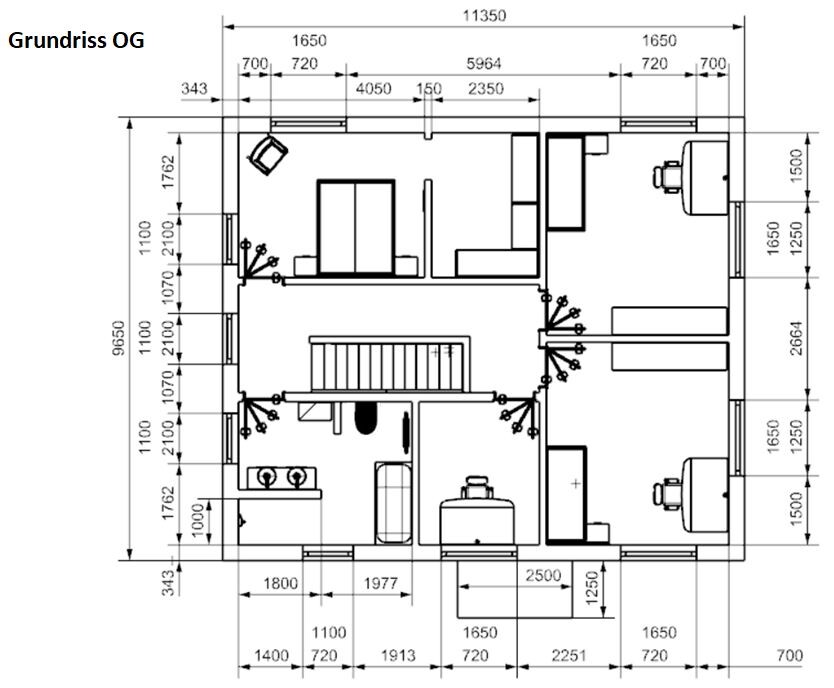

Hello everyone, I hope I completed everything correctly. Attached is our design as it stands so far. The plot will be purchased soon, and our appointment with the architect is in May. I hope we are well prepared and would like to hear your opinions, ideas, and especially any criticism.

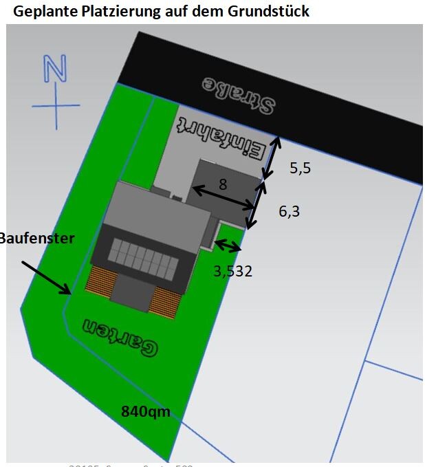

What still makes me a bit uncertain is the placement on the plot, as we placed the house quite centrally. Most houses tend to be positioned close to the street. According to the development plan, shrubs and trees must be planted in the rear area on a 5m (16 ft) wide strip, and we must also keep a 5m (16 ft) distance on the sides, as the building area ends there.

FloDerMeister28 Apr 2020 20:17The knee wall provides 2.15 m (7 ft) of usable interior height measured from the finished floor surface, which results in about 2.03 m (6 ft 8 in). The showerhead can also be mounted on the side wall, which should avoid any potential issues if they arise. By the way, the roof pitch is 25°.
I like the floor plan. It seems to be related to the Sento model. I would change a few small things, like the bathroom layout and the access to the bedroom through the dressing room.
However, the arrangement of the buildings on the plot is actually not ideal. This way, you are building on almost the entire property. Only a narrow strip remains for the garden. How wide is the plot, and what is adjacent on the left side according to the plan?
