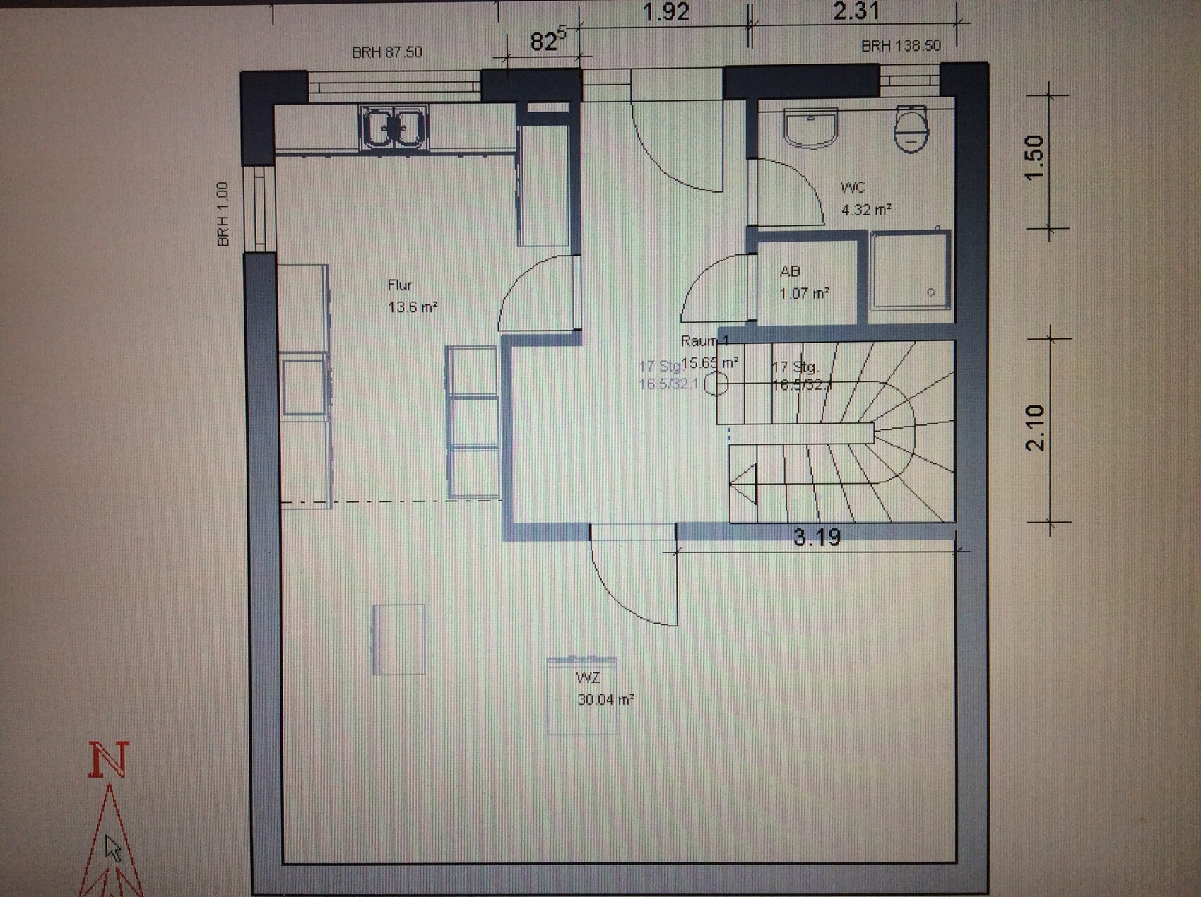

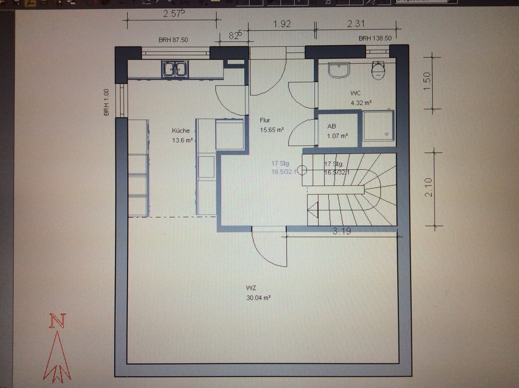

Floor plan of a house: kitchen on the left, hallway in the middle, living room on the right, WC and storage room, staircase.
I was busy working on this again.
However, my doubts about the landing staircase were confirmed: far from an optimal stair size, I had to adjust the dimensions three times just to fit it into the niche. Simply shortening the landing by 20 cm (8 inches) wasn’t enough... the staircase ended up steeper than our emergency stairway at work.
Similarly, I had to make the kitchen a bit narrower because the space between the work areas was much too large.
Now: I’m not sure which image appears first. I had in mind that the kitchen door is directly opposite the terrace door. But then I moved the kitchen door again to create a small work L-shape and to add a wall in the hallway for an impromptu coat rack. The main wardrobe is opposite the staircase, which is a two-flight switchback type. There are nice options available here, and it doesn’t have to be a yellowish beech wood finish.
The guest WC size has been adjusted... unfortunately, the doors cannot be customized in one of the versions.
Floor plan of a house: hallway, kitchen on the left, living room, WC, storage room, staircase
kbt09
6 Feb 2019 06:01
@ypg .. Yvonne
I had to design the kitchen a bit narrower because the space between the work areas turned out to be far too large.
Exactly my point... when it comes to a double-row kitchen, a room width of 280 cm (110 inches) is actually too much.
I like it. And for the “spontaneous cloakroom,” you could simply consider accessing the storage room through the bathroom. I wouldn’t see that as a big issue.
Also, the door between the hallway and kitchen could be made as a sliding door running along the hallway towards the bottom of the plan.
Possibly make the kitchen window narrow enough to fit a tall cabinet on each side, so about 70 cm (28 inches) of wall on the right and left—on the right side, this is already the case.
Then, in the kitchen, you could plan from left to right on the upper level: tall cabinet with oven, secondary storage area, and next to the chimney shaft a tall cabinet with reduced depth for standard kitchen supplies. In the recess below, place a freestanding refrigerator that blends into the sink area, and along the right side towards the exterior wall, the cooking zone. This could potentially allow for good exhaust ventilation.
That would be my spontaneous kitchen layout, with a more open lower section without tall cabinets.
