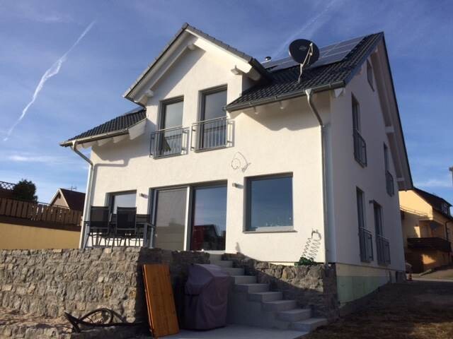

That’s how we did it:
Two-story white house exterior with stairs, large windows, and satellite dish
Our house is just over 9 meters (30 feet) wide.
Dirk
