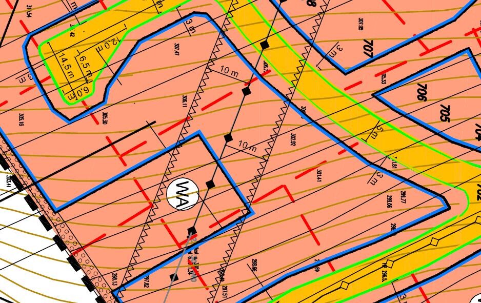

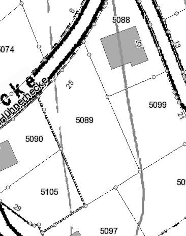

Plot Size 988 m² (0.24 acres)
Slope The plot slopes slightly downwards to the left, visible in the pictures
Site Coverage Ratio max. 0.3
Floor Area Ratio max. 0.6
Building Envelope, Building Line, and Boundary see image
Parking Spaces one, 5 m (16.4 ft) space required in front of garage
Number of Storeys max. 2
Roof Shape no restriction
Architectural Style no specification
Orientation Front door facing north, northwest
Maximum Heights / Limits eaves height on mountain side 5.50 m (18 ft), valley side 6.50 m (21.3 ft)
Special Conditions
Maximum of 2 residential units per house
Retention system in the form of a cistern with 5 cubic meters (176 cubic ft) per 100 m² (1,076 sq ft)
Style, Roof Type, Building Type
open, modern, 1.5 storeys with 1 m (3.3 ft) knee wall and gable roof
Special Conditions
