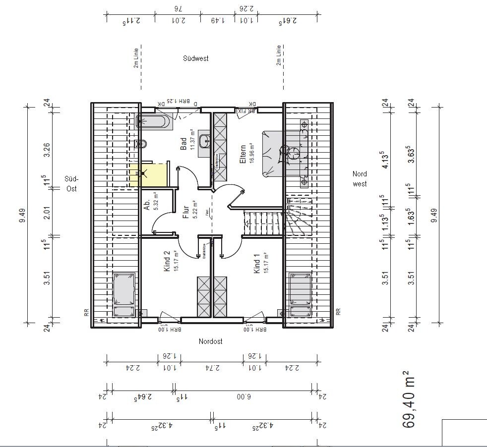

Sushisony14 Oct 2016 14:51D

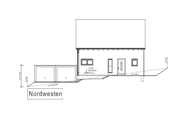

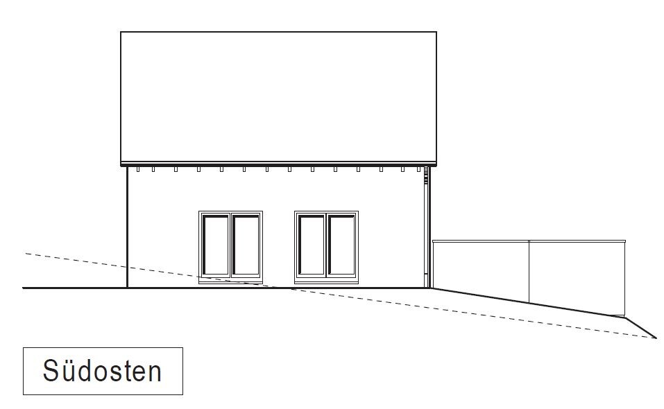

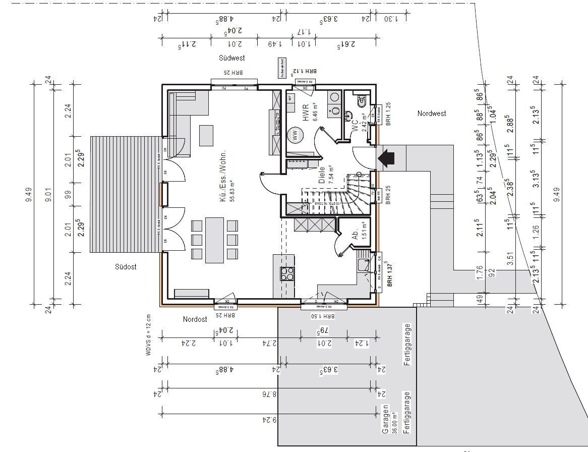

Doc.Schnaggls14 Oct 2016 14:57BeHaElJa schrieb:
But just a quick question — you have a garage in front of the kitchen window...?I assume the garage is significantly lower than the floor level of the ground floor — I infer this from the six steps between the garage driveway and the front door.
That should mean the planned window sill height of 1.5 m (5 feet) in the kitchen is fine.
I’m a bit concerned about the kitchen peninsula — if the depth of the island including the cooktop is realistically drawn, you can expect grease splashes in the dining area behind the peninsula. If you plan to install a conventional recirculating or vented hood above the cooktop, it will probably block the line of sight considerably. Alternatively, you could consider a flat ceiling-mounted hood (which would need to be quite powerful and thus more expensive) or a built-in downdraft extractor in the island (also not cheap).
The first step of the staircase is located right in the dirt zone behind the front door — it is very likely that street dirt will be carried up to the upper floor.
I also find it a bit unusual that the utility room door is directly in line of sight from the front door. Visually, that might take some getting used to.
Dirk
Doc.Schnaggls schrieb:
I have some concerns about the cooktop peninsula – if the depth of the island including the cooktop is drawn realistically, you can expect grease splatters in the dining area behind the island.This "problem" always exists with islands unless they are square-shaped. Some kind of splash guard definitely makes sense here in my opinion (now I finally understand the purpose of those attached counters 😉). What I find more annoying is the long distance between the cooktop and the sink. You’ll likely have to clean that path constantly, especially when things get hectic and a child or pet is in the way (hopefully not near a hot pot).
I would straighten the walkway between the hallway and the exit to the terrace. There are also too many terrace doors for my taste, since the space in front of and behind doors is always wasted as potential exit space. The room is only 9.49 m (31 feet) wide – how many exits facing the same direction does a person really need? I would limit it to just one door—straight ahead from the hallway onto the terrace. No one really benefits from a door further to the left, for example from the kitchen to the terrace, because the dining table is in the way anyway. That would save quite a bit of money.
I would definitely recommend a green roof on the garage; otherwise, the kitchen view will be spoiled. Who wants to look at roofing felt?

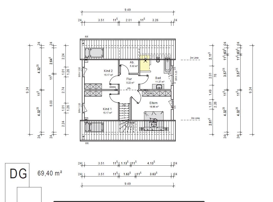

I took the time to create JPGs from the plans. They are attached below.
Here are my observations:
Ground floor:
Ground floor:
- Narrow entrance and hallway leading to the open-plan living/dining/kitchen area
- Pantry is outdated in the corner, and if the kitchen layout is as shown, you should reconsider it. The distance between the stove and sink is way too long
- The kitchen windows will feel like basement windows. Both windows have very high, but different, sill heights... why? One side is because of the garage, but why isn’t there a standard sill height on the front?
- I think the open plan area should be slightly smaller to create more practical storage space in the hallway area.
- Shower head at 2 m (6 ft 7 in) height? Definitely at the 2 m (6 ft 7 in) mark. There’s no real space above the shower head, and water will splash directly onto the sloping roof when washing hair.
- Northeast children's room... that’s a shame; I would place it more towards the southwest.
- The children’s room with the relatively small single window doesn’t quite fit the overall concept.
