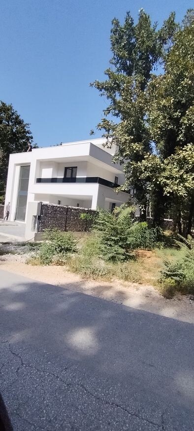

Buchsbaum7 Nov 2023 12:12Such modern houses often look expensive but are actually quite affordable to build.
I have been considering taking on a project like this again for some time. Currently, I just don’t have the right plot of land for it.
I saw a house like this while on vacation in Bosnia. It probably costs only a fraction there, but you can see many of these new houses. I find them very stylish. I don’t understand why you don’t see more of them in Germany.
