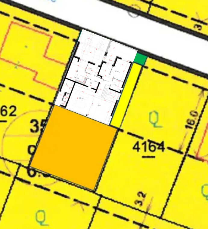

Schorsch_baut8 Nov 2023 09:10hanghaus2023 schrieb:
I have roughly sketched the house onto the plot.
As I mentioned before, I strongly recommend consulting an architect who is familiar with the local building regulations and/or planning permission requirements.Nearby, there is a similarly sized new villa (a divorce property) close to the town center that has been on the market for over a year. So far, the sale has failed due to the price being too high for such a small plot. The price has recently been reduced again. It’s a bit like Cinderella’s shoe on the stepsister’s foot.H
hanghaus20238 Nov 2023 09:13Building areas of 16 m (52.5 ft) are not unusual but are rarely fully utilized. The block on the east side should not be taken as an example.
Respecting the setback distances makes it somewhat more efficient. Whether such a building directly on the street complies with the Vienna building code/planning regulations should also be clarified.
Your friend is not doing you any favors with such a design. 🤨
fanutaco schrieb:
Since we don’t have a basement and need three children’s rooms, I don’t think the size of the house is unreasonable. Well, there is still no storage space. Storage without a basement usually means a slightly larger living area, for example an additional 10sqm (108sq ft) of basement replacement space, but that’s not the case here.
The overall size of the house is not really being criticized; everyone is free to design as they wish.
What is criticized is that the house doesn’t fit on the plot. Maybe the architect has his tricks so that it is approved by the building authority/planning permission office (we’re not familiar enough with the regulations in Austria for that), but in my opinion, it is your own responsibility to make sure it fits somewhere. This isn’t about personal taste: you can aggressively push through an extreme position in society, but you shouldn’t be surprised if people turn away from you. You don’t need to bend yourself for that.

haydee schrieb:
And are you really allowed to build so close to the boundary? fanutaco schrieb:
We would really appreciate any constructive criticism. Overall, going back to the (internal) size, meaning the living area: the rooms themselves are not generous, just slightly above average. Everywhere is 1-2sqm (11-22sq ft) larger, bedrooms and living spaces somewhat more so, but nothing remarkable. The main feature is the spa area at over 25sqm (269sq ft) and the open space (although I’m not sure if that is included in the total).
There is a lack of storage and utility space.
Since the children’s rooms are quite dark anyway (the small corner window offers practically no view), I would say the architect should implement some changes, especially since there is the possibility to give the cube a more appealing shape.
Secondly, I would also consider whether you really want to build a terraced house character for over one million.
