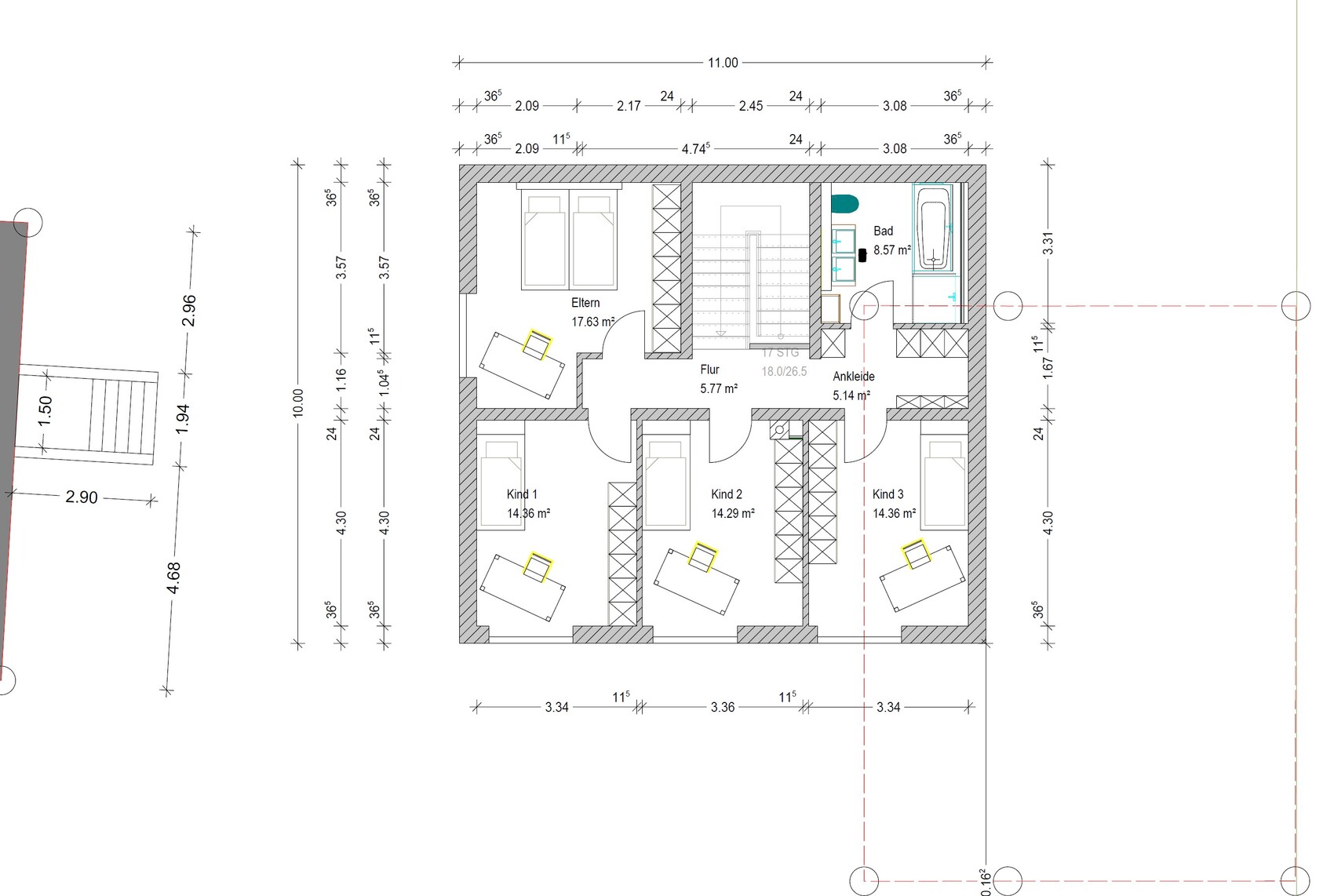

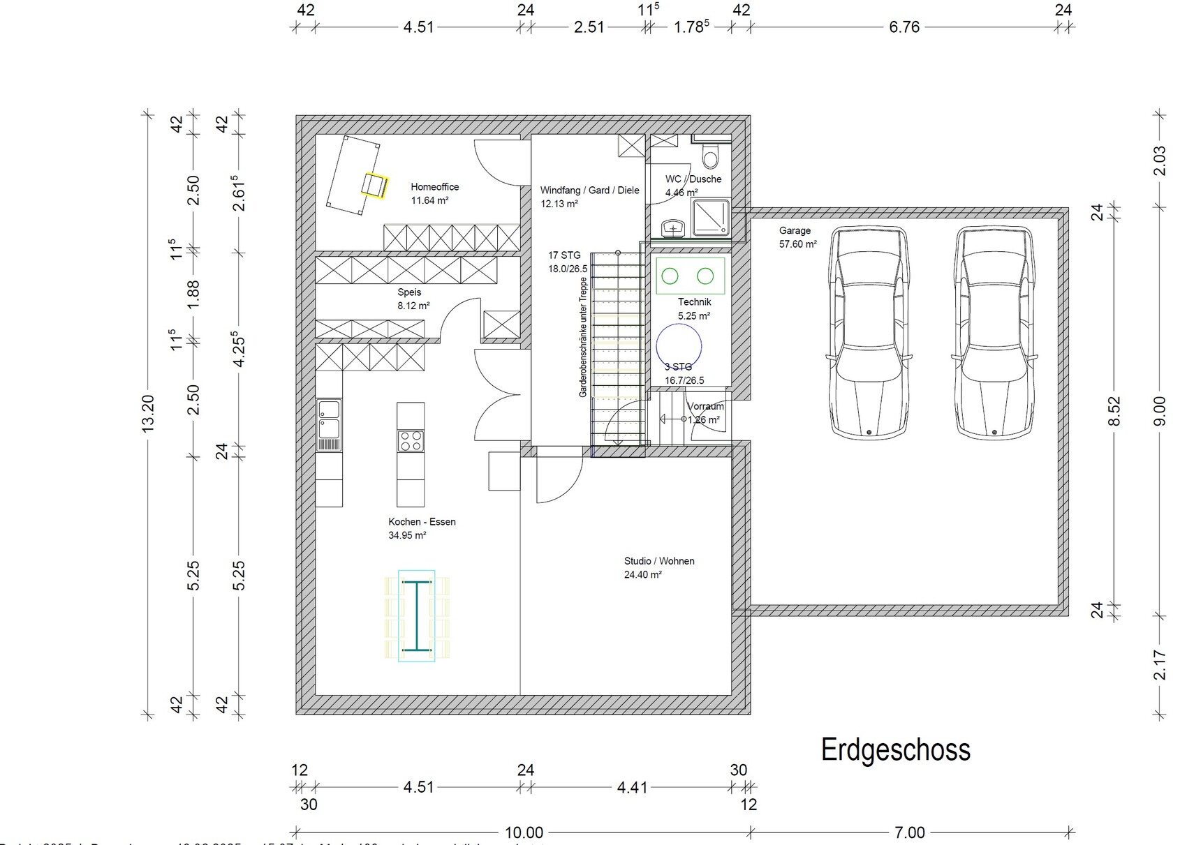

He finally agreed to shorten the extremely wide path as suggested, but he didn’t want to make the house smaller and pointed out again that orienting the longest side to the west makes much more sense... And then his design with three children’s rooms on the west side would also be much better. I don’t find his design very successful.
Otherwise, we finally understand why the long side should face south, but only after we marked it multiple times on the property and walked everything through. It’s a shame our architect didn’t come up with the idea himself, and we only got the tips from you...
Thanks for your persistence.
Attached are his plans for the interior finishing. He completed these even though we had already brought up K a t j a’s idea and requested changes. He said he preferred the original approach and wanted to convince us with his plans.
Also included is the calculation of the setback areas for the way too large house.
Upper floor: Stairwell with hallway; master bedroom and three children’s rooms; bathroom, utility room, terrace on the right.
Ground floor plan: Kitchen/dining, studio/living, pantry, entrance hall, technical room, WC/shower, garage.
Ground floor plan: Kitchen, living room, stairwell, storage room, and garage for two cars.
K a t j a3 Mar 2025 06:39
Basically, the layout often comes down to the personal taste of the homeowners. However, what is shown here simply does not work or only works very poorly. This is where my understanding ends. For example, there is no space left under the stairs for a coat closet. The 5 square meters (54 square feet) allocated for the technical room are also unacceptable. You can see that you already have to squeeze past the heating system and storage tank. The same applies to the master bedroom. The wardrobes can’t even be opened when standing in front of them. A bathroom with 8 square meters (86 square feet) for five people is also far from ideal.
Ultimately, you are responsible for your own decisions. We can only offer advice here. But I would not continue planning with this designer. It’s possible they might perform well on site, but on paper, this plan is not acceptable to me.

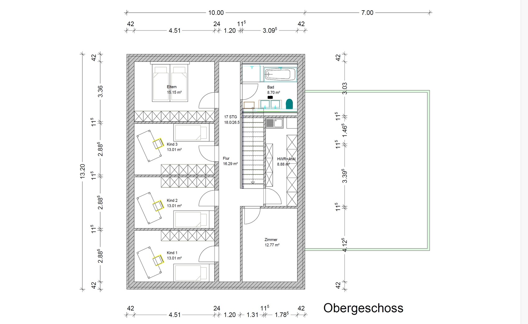

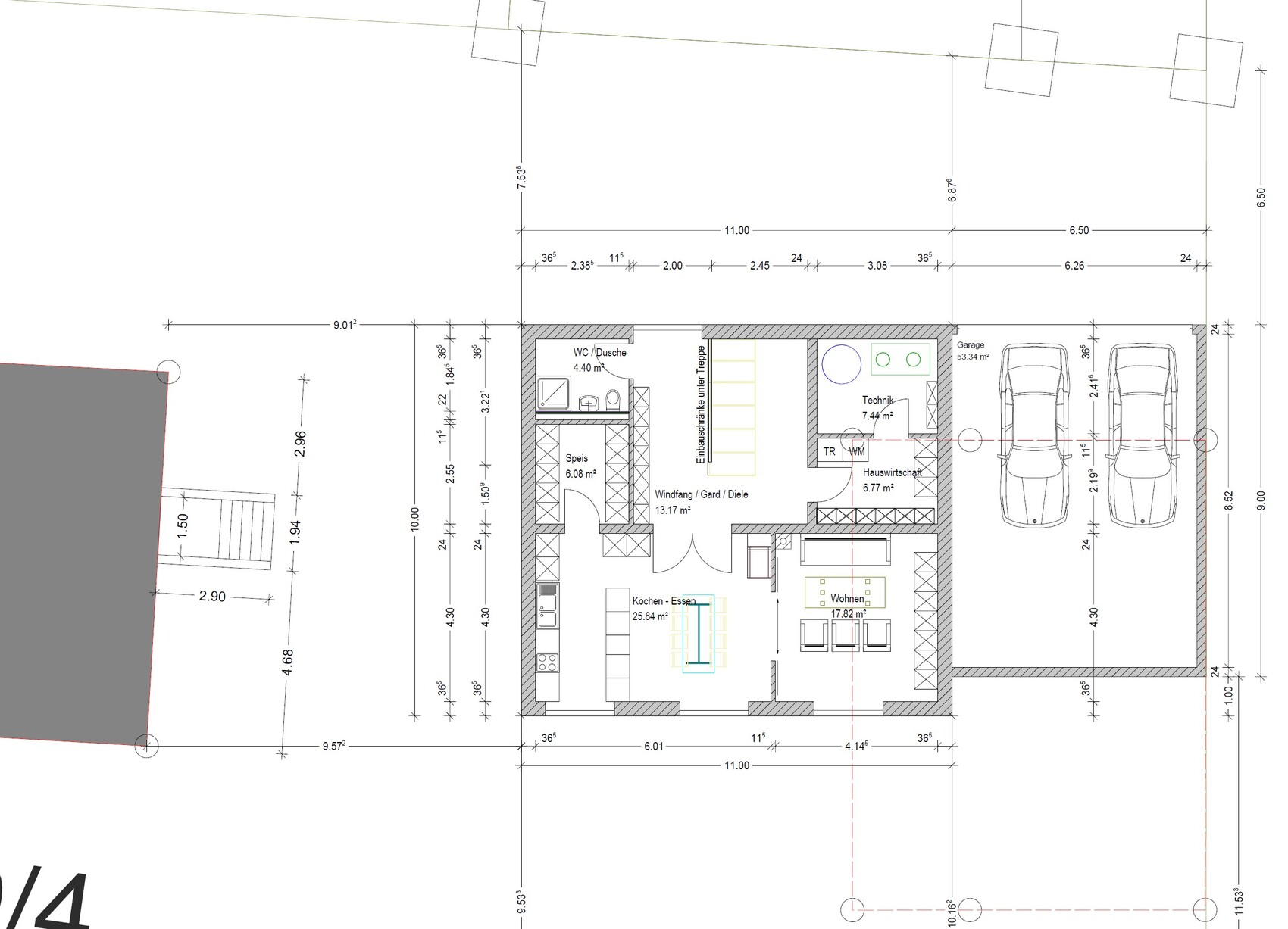

We have received a new design from the architect. I made it very clear to him over the phone how dissatisfied we are with his designs, why he cannot stick to our suggestions, and why he always feels the need to be creative on his own.
Now we have these designs, with the note that he has used a 36.5 cm (14 inches) exterior wall this time because we need to save money; otherwise, the house would be too expensive. He even managed to fit everything into two full floors, so we don’t need the attic at all. If this design works for us, he would proceed to finalize it.
We gave him a slightly modified design from "K a t j a". In his design, he increased the floor area again, simply integrated the home office into the master bedroom, which practically doesn’t work, and positioned the dressing room in front of the bathroom, which is too small. There is also no laundry chute. The children’s rooms are below the required minimum size, but I could have accepted that if the rest had worked.
I still don’t like the kitchen on the ground floor, but that can be adjusted. Otherwise, I definitely liked the ground floor layout.
But without a home office and with the small bathroom, the upper floor just doesn’t work either.
On to the next round, with the warning that I will pull the plug if this doesn’t work out. I’ve heard that he only takes on projects that interest him now... he’s lost motivation.
Do you have any ideas on how to solve the staircase to the upper floor differently? I suspect this is where he struggled and why he ended up going with two full floors.
