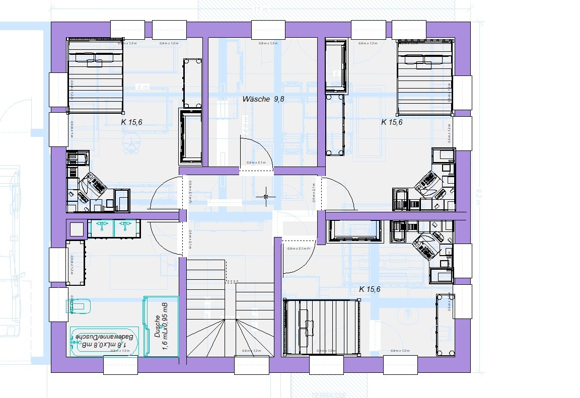

Gustav578919 Mar 2025 09:35K a t j a schrieb:
Well, I wouldn’t do it myself, but as I said, that’s a matter of personal taste. If you like it, you should consider whether you’re willing to give up a bit elsewhere for it. Also, it depends on the story heights, which we don’t know, and whether it really has to be such a mega-monster right away.
Yes, as I mentioned, the tip is to install loops in the pantry and put a control switch there. That’s one thing I wouldn’t skimp on.
Basically, I’m also in favor of a covered entrance, but this one is quite unusual, isn’t it? Is there something nicer? (Just joking.) Seriously though, it’s a matter of taste. You have to like it. I have requested the story heights and received them, see attachment. Maybe this helps you a bit with evaluating the story heights and the stairs.
Yes, the covering is quite special... it was his idea, but we’ll have it changed, we just don’t have a better idea yet 🙂
Many landing stairs have a bit of an office floor / office corridor vibe. If you choose the wrong flooring, you’ll never really feel relaxed at home.
What really cancels out any (nice) stair design and basically ruins the effect are the built-in cabinets underneath. In my opinion, you can get the nicest furniture for those special installations from an expensive furniture boutique. I also can’t imagine anyone wanting to reach into those pharmacist-style cabinets (if we’re talking about the hyped APO cabinets: even a well-stocked 40cm (16 inch) cabinet in a kitchen sometimes makes you sweat just opening it).
But of course, it’s a matter of personal taste.
I find it nicer if the stair runs are changed/mirrored, so that when you enter you’re not immediately confronted with the side wall — meaning the railing is visible. You can still put storage under the landing at a lower height, which doesn’t have a negative visual impact.
Yes, it is getting better! Just because there’s still criticism doesn’t mean it hasn’t improved. Well, it’s not about the criticism, I’m still thankful for that. But it’s frustrating to get such information externally when we are paying someone a lot to consider these things for us.
Yes, he recommended the APO cabinets. He said they are super practical and has used them often, so we trusted him back then.
What do you mean by “AP under the height”?

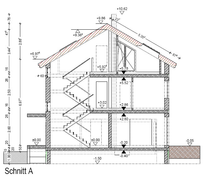

I requested and received the floor heights, see attachment.I just noticed that the 2-meter (6 ft 7 in) height is actually marked in the previous planning drawing. I would probably cut the roof slopes down to at least 150cm (5 ft) in height. I would have initially adopted the roof pitch from the other house as well. The stair landing might already make sense, because otherwise it will be tight with the roof and headroom.Gustav5789 schrieb:
But it’s frustrating to get this kind of information from external sources,Gustav5789 schrieb:
