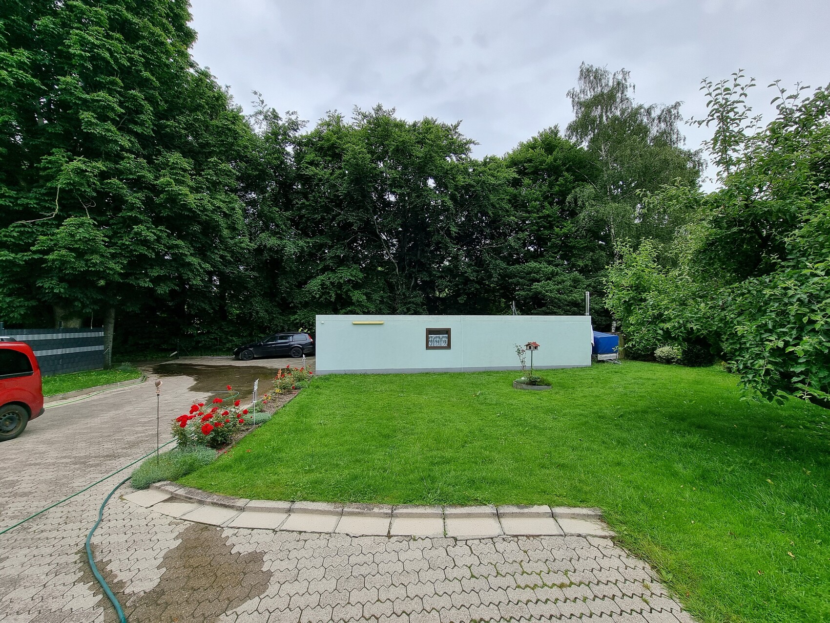

The plot plan originally anticipated reusing existing prefabricated garages; however, these have been sold, so we have a free hand.

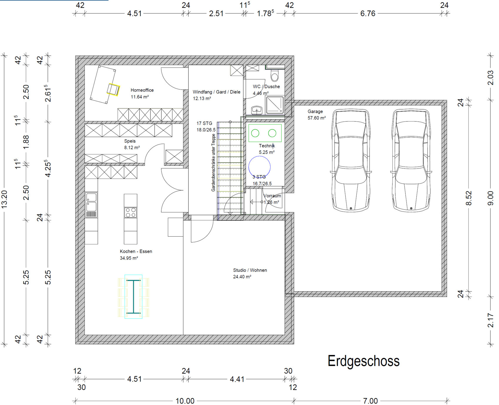

We have also received his first draft.
For the ground floor, he almost completely adopted our design. For the upper floor, he used an old project as a basis.
What bothers me on the ground floor: we don’t have a proper wardrobe space. He suggested putting cabinet drawers under the stairs to store clothes there. I don’t think that will work in practice.
I would reduce the pantry width slightly and add the gained space to the home office.
No kitchen island because it’s too expensive, and placing the fridge between two doors seems quite pointless to me.
The door to the living room isn’t needed, but then how else would light enter the corridor?
The utility/technical room is aligned with the garage, but it needs to be aligned with the house, meaning the stairs would extend into the garage. I’m thinking of adding a landing and then turning the stairs 90° (degrees).
The utility room also seems a bit too small. You can’t fit a water tank, controlled ventilation system, photovoltaic inverter, softening system, and battery in there... I considered removing the passage between house and garage and adding that space directly to the utility room.
What bothers me on the upper floor:
Small bathroom, no real space for cosmetics or shelves for towels.
Master bedroom is too short. With my extra-long 2.2m (7 feet 3 inches) bed, I only have about 50cm (20 inches) walkway, if I read that right.
All three kids’ rooms are too small.
A room of 12.77m² (137 sq ft) isn’t really necessary.

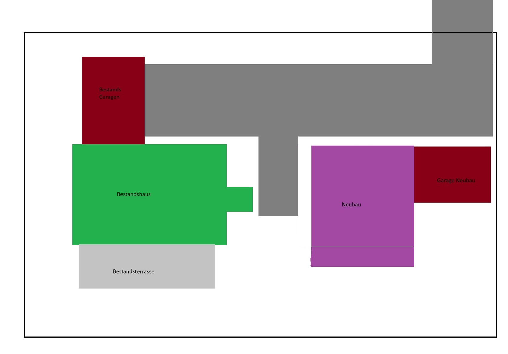

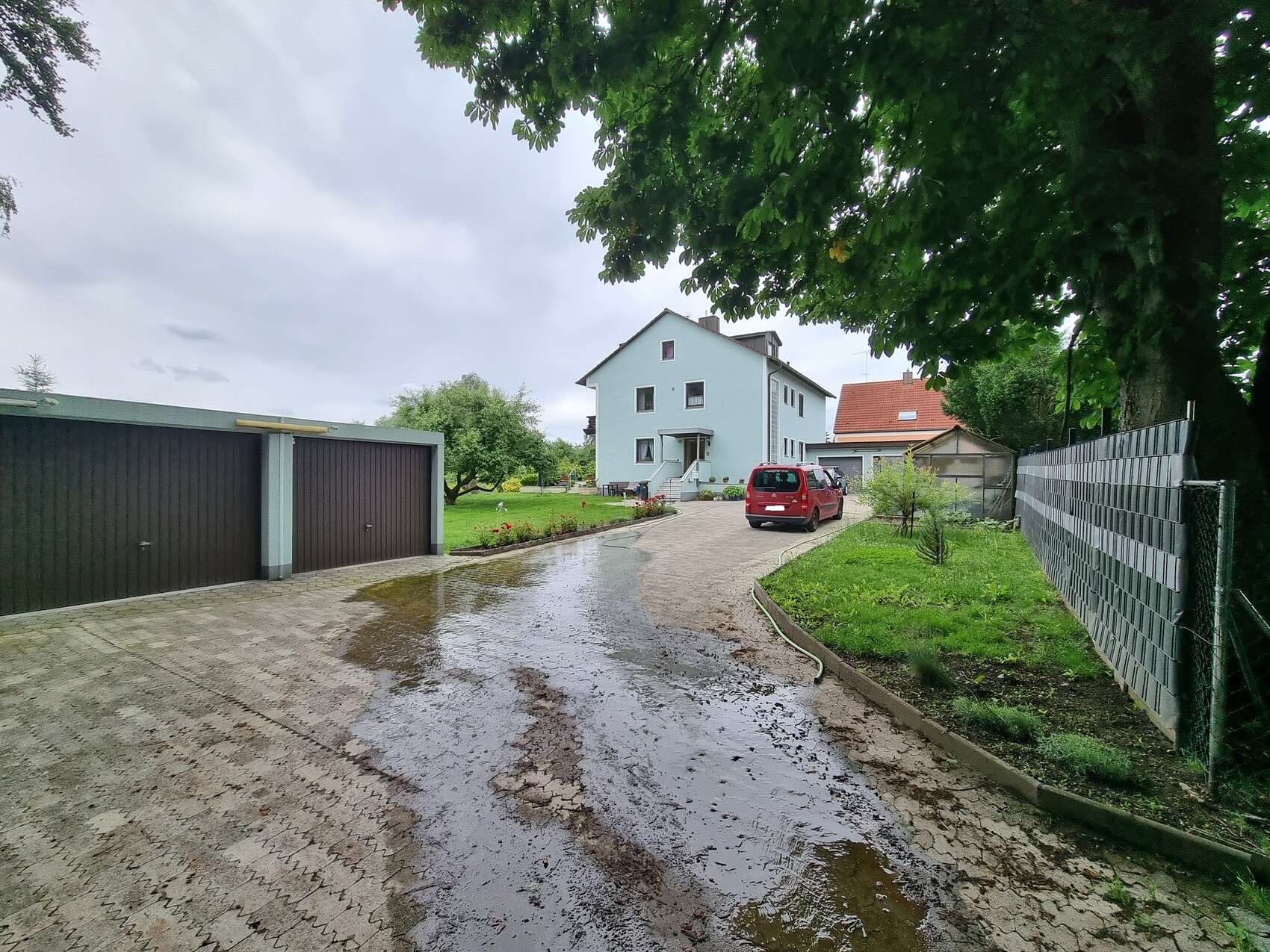

Otherwise, I attached two images to help visualize the plot better.
Gustav5789 schrieb:
House orientation: The short sides facing north and south, the long sides facing west and east. I agree and also have the same question as Katja: why?
Gustav578917 Feb 2025 11:59I am not fixed on this, there are other ways to do it, but the original ideas were as follows:
1. Greater distance from the existing building
1.1 Terrace on the west side
1.2 Lower temperature exposure, since our current balcony on the south side gets too hot during the day to stay there comfortably
1.3 Warmer in the evening because the sun shines on the terrace for a longer time
2. The remaining lawn area is more square-shaped, which makes it more usable than a long, narrow strip
3. Since people are usually home in the evening, the rooms receive sunlight for a longer time because more area faces west
We have also commissioned the local engineering firm to survey the property; hopefully, I will receive not only the elevation data but also the property dimensions.
However, they probably won’t be available until March.
Gustav5789 schrieb:
My architect didn’t provide an answer to this question, even though I asked 2-3 times; he always skipped over it.Then he hasn’t completed design phase 1, otherwise he would be able to answer this off the top of his head or at least quickly find it in the project files. Gustav5789 schrieb:
We are just hesitant because we don’t want to waste the money we’ve already invested. We will only continue working together until design phase 4, and I hope that with your help I can still somehow come up with a good floor plan design.
For the ground floor, he almost copied our design. For the upper floor, he used an old project as a base.2. What is the architect’s profession? 3. Why are you showing redrawn plans instead of the original ones? And
1. Have I really written too few posts (search term: Gerddieter) about why one should avoid designers who only do design phases 1 to 4?
Gustav5789 schrieb:
No cooking island, too expensive You want to build 200m² (2,150 sq ft) and then it fails because of the money for a cooking island?
