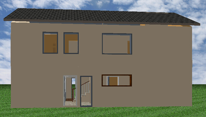

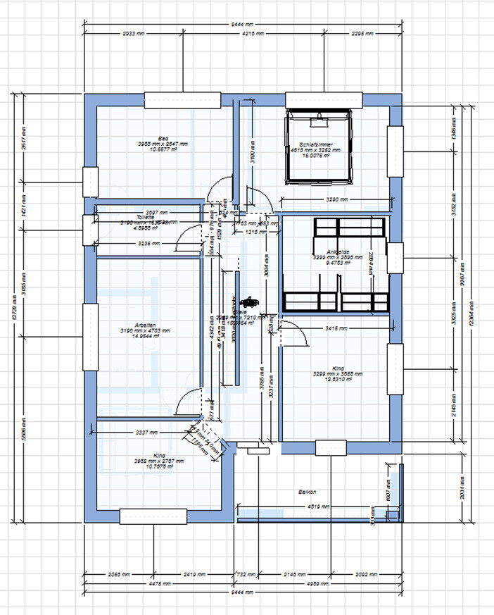

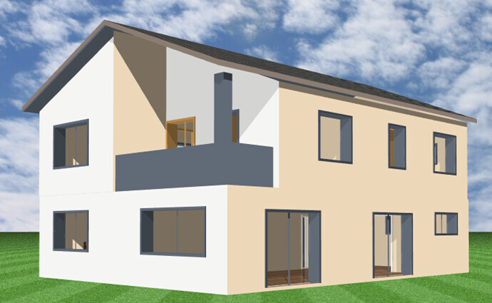

I also find a south-facing bedroom less than ideal. Swapping it with the bathroom makes sense. I would move the bedroom/walk-in closet to where the office/bathroom currently is, place the bathroom on the south side, and put the study where the small child's room is now, giving that child a bit more natural light. Additionally, the children's bedrooms should be the same size. If possible, I would consider adding a small bathroom for the children, and definitely plan for a bathtub in the main bathroom.
Am I correct in understanding that you have a very long driveway to the garage? Would it possibly make more sense to position the garage closer to the front? I’m thinking about snow removal in winter before leaving the property. The driveway to the house itself is fine, but I would position the garage somewhat nearer to the street (says someone who still experiences proper snowfall).

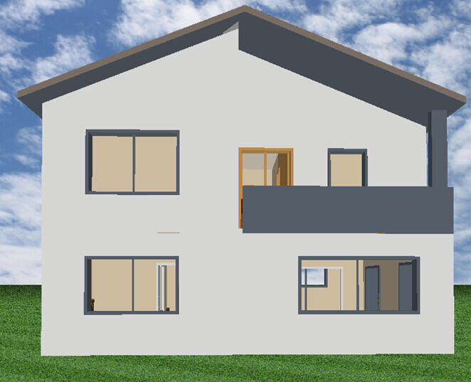

__Markus__4 Dec 2016 11:31Hello everyone
Thank you for all your replies
@kbt09
Based on your suggestions, I have made some changes
Thanks in advance for your replies.
@kbt09
- The bedroom is now facing north
- There is a separate toilet
- Wardrobe and entrance area --> I now see this as a problem too, I need to discuss it again with the architect
- Switching the storage room and entrance is not possible. The entrance must remain on the north side. Therefore, the staircase can only be viewed from the side
- Long driveway: that is correct. But we still want the garage close to the house
- We have now also added a balcony. This will bring much more natural light into the hallway
- These changes still need to be discussed with the architect
It is always helpful to include a north arrow on the floor plans, so you don’t have to search again to figure out the orientation of the house, and it’s easier to visualize mentally 😉 .. Thanks 😉. Or always set the floor plans oriented to north 😉.
Why is the study larger than both children's rooms?
Walk-in closet facing south? The bedroom is more likely facing east – isn’t it?
I’m not a fan of windows above the headboard of beds. They’re hard to clean and you usually don’t open them because of drafts near the head.
I find especially the upper floor now looks quite patchwork.
The staircase drawing doesn’t fit either.
