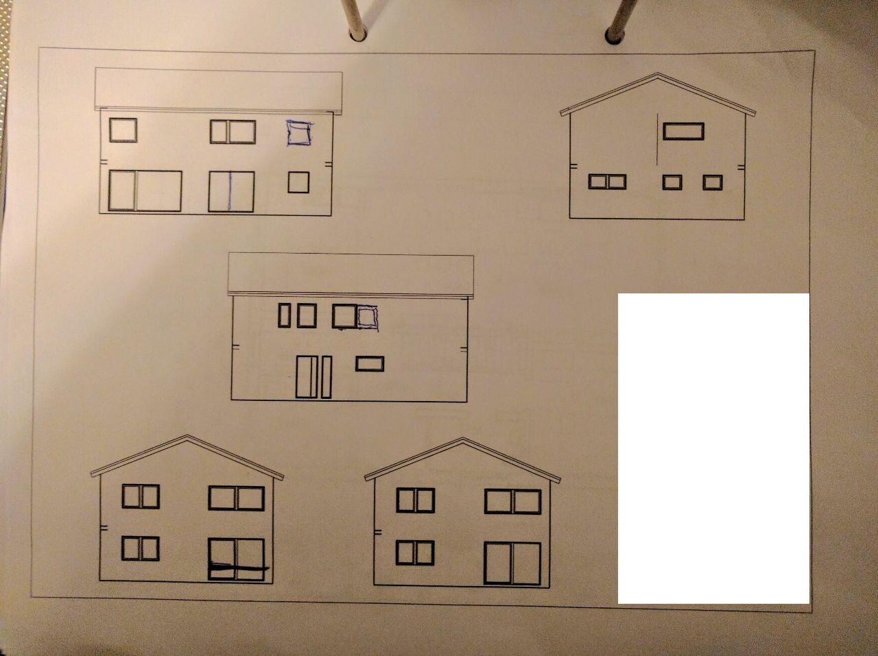

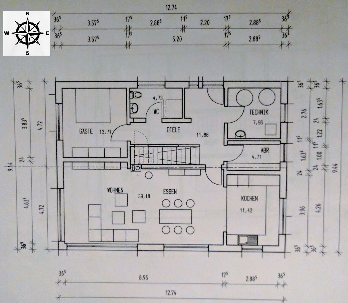

It works. At least for the ground floor. I would miss space for a proper wardrobe closet. I don’t like the elevations because of the window arrangement. There are too many sizes used: a simple small window comes in six different sizes...

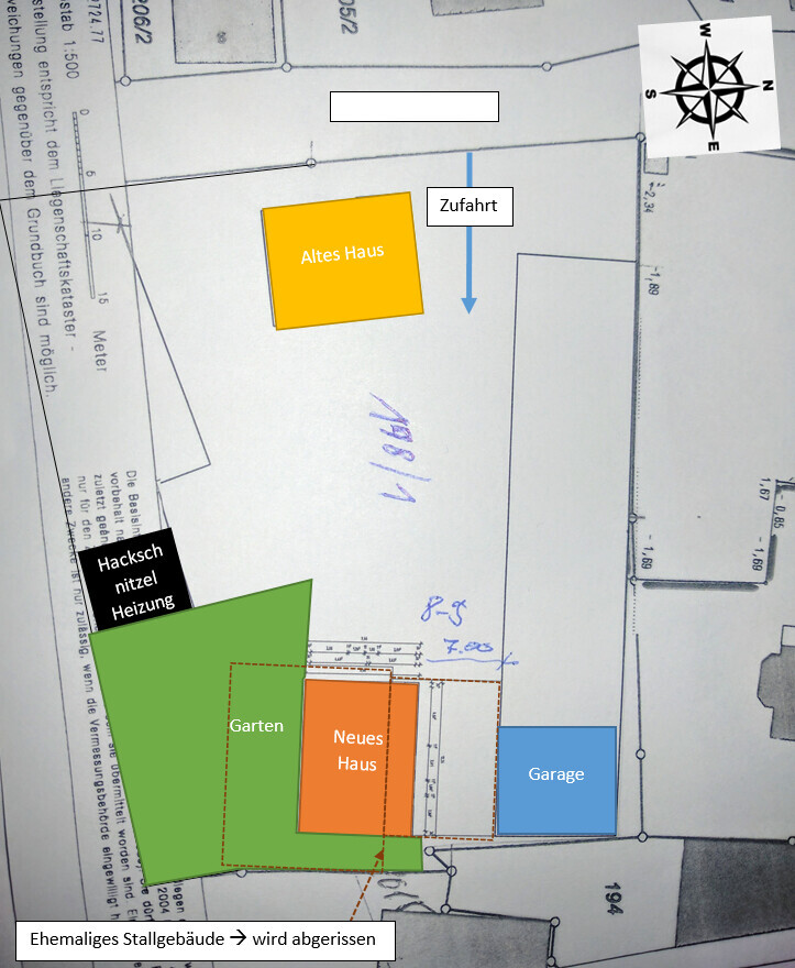

__Markus__27 Nov 2016 22:11What exactly is being demolished here:
Otherwise, I don’t quite understand where the new house is supposed to be built.
Together with the window next to the front door, the niche intended for the wardrobe isn’t really practical:
Why is the sofa placed so far to the right of the plan? And why is it positioned fully in front of the floor-to-ceiling window (sliding door?)?
The kitchen layout is not supposed to be like this, right?
I would make the window in the storage room narrower, so that cabinets with a depth of 60cm (24 inches) can fit along the bottom of the plan.

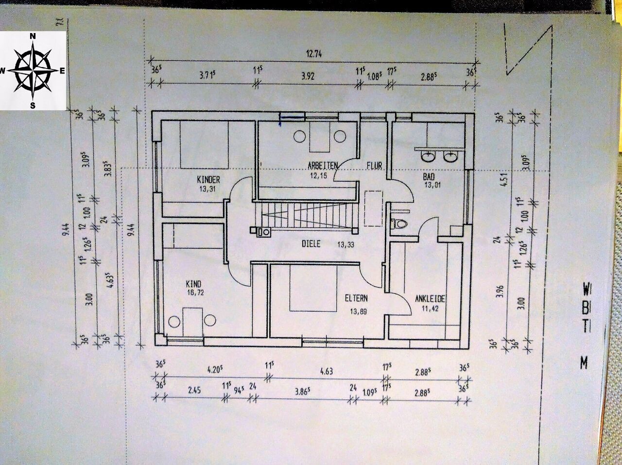

Bathroom on the upper floor with 13 sqm (140 sq ft) and no bathtub? I would skip the access from the dressing room and instead access the bedroom through the dressing room. Although having the bedroom facing south is also something to consider.
Why are the children's rooms so differently sized?
