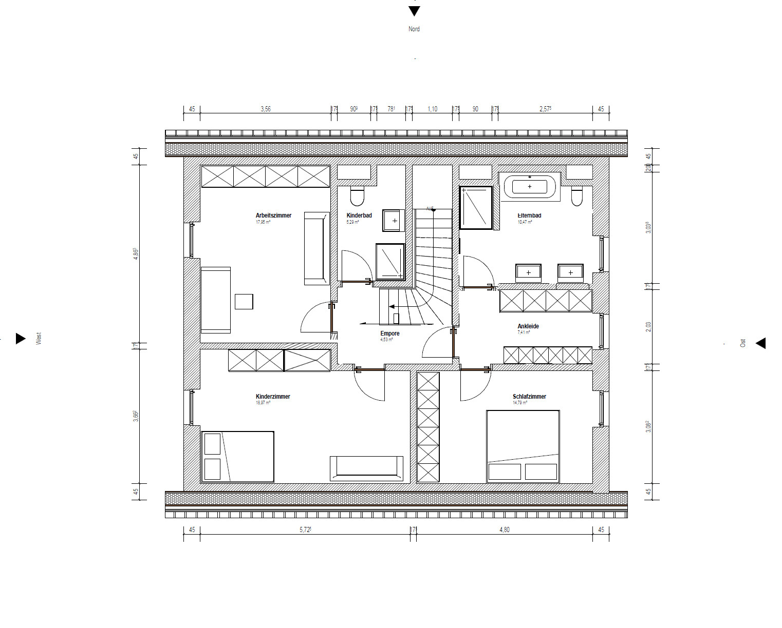

We already like the floor plan quite a bit. The walk-in closet upstairs is still not ideal. Possibly the entrance could be through the bedroom, which would create more space in the closet.

Floor plan of an attic with bedroom, children’s room, office, bathroom, walk-in closet, stairs.

Also tight is the dressing room with a 2-meter (6.5 feet) rough structural dimension. If you account for 60 cm (24 inches) wardrobe depth, it will be very cramped to get dressed in there.
Do you plan to have only one child? Does the child definitely need a separate bathroom, or could the situation upstairs possibly be eased by having a large family bathroom instead?

I think it's quite good overall, with a few issues:
1. Is that supposed to be the fireplace on the ground floor? If so, please extend the chimney all the way up to the roof. That could cause problems. Also, the chimney is usually not placed on the eave side of the roof.
2. I would move the door to the home office upstairs a bit further toward the top of the plan to allow for a straight wall.
3. Move the doors leading from the walk-in closet into the bedroom and bathroom forward so you don’t have to walk through the closet first. This should improve the situation. Also, have the entrance door to the master area swing the other way. The window in the walk-in closet might need to be a bit narrower. (I hope that was clear.)
4. All the windows upstairs are too small. The windows on the ground floor are probably not ideal for the exterior appearance – there is definitely room for improvement.

Also tight: the walk-in closet with 2m (6.5 feet) raw dimensions. Consider 60cm (24 inches) wardrobe depth – it will be very cramped to get dressed in between.
Yes, as I said, actually only one wardrobe fits there, and that’s it.

Do you plan for only one child? Does that child definitely need their own bathroom, or could the upstairs layout maybe be simplified with one large family bathroom?
Actually just one, but you never know what might happen. That’s why there are two similar rooms upstairs, so the office could move to the guest room on the ground floor.

kaho674 schrieb:
3. Consider moving the doors from the walk-in closet to the bedroom and bathroom forward, so you don’t have to walk through the closet first. That should ease the situation. Also, reverse the entrance door swing into the master area. The window in the walk-in closet might need to be a bit narrower. (I hope this came across clearly.)
Yes, I see that too. But then the bathroom gets very tight. How best to design the shower then? The window might get in the way.

4. All windows upstairs are too small. Windows on the ground floor may not be ideal for aesthetics – improvements are probably possible.
They are all 1 m (39 inches) wide. What do you mean regarding the ground floor?

Yes, I understand that too. But then the bathroom will be very tight. How is it best to build the shower in that case? Since the window might get in the way.
My standard solution under a sloped ceiling is this:
Floor plan attic: staircase, study, children's room, bedroom, dressing room, bathrooms.
The dimensions fit exactly:
100 cm (40 inches) shower + 175 cm (69 inches) bathtub + 90 cm (35 inches) toilet = 365 cm (144 inches).
LukeLuu schrieb:
They are all 1 meter wide.
That’s not sufficient. Best to at least double or maximize the width. Knee wall height and roof slope are unknown—so no precise advice is possible.
