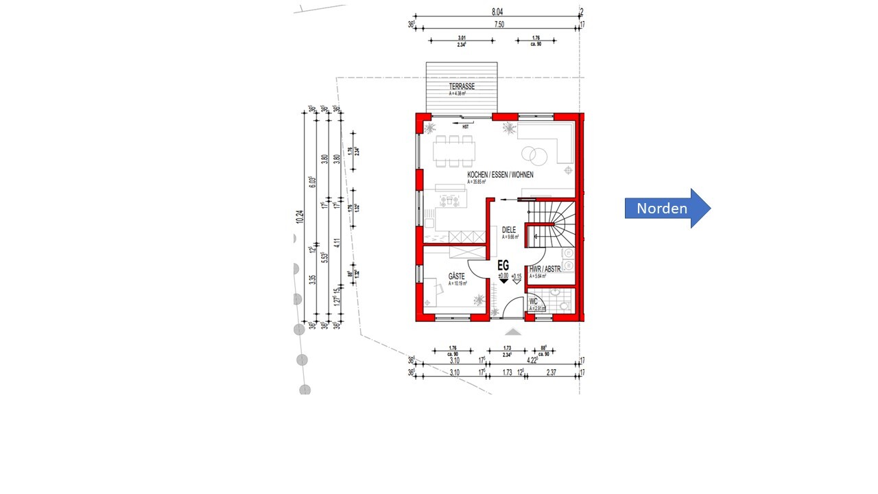

we bought a plot last week that will be developed with a semi-detached house. Our building partner owned the land, and we are working on the planning together. (We agreed on a general contractor, etc.)
We have now received the first architect’s draft, but we are not completely satisfied with it. Of course, we have looked at what feels like a thousand floor plans and would like to be better prepared for the next meeting.
Maybe someone here has a great idea.
Here is our “self-disclosure”

2 large bedrooms
What do you not like? Why?
Bathroom on the first floor—that is being worked on!
Where to put the washing machine and dryer?
Utility room/storage without window
440,000 including KfW 40+

MelW2024 schrieb:
We purchased a plot of land last week, which is planned to be developed with a semi-detached house. Our building partner owned the plot, and we are working on the planning together. (We agreed on a general contractor, etc.)
We have now received the first architectural draft, but we are not really satisfied with it. Of course, we have looked at what feels like 1,000 floor plans and would like to be a bit better prepared for the next meeting.
Development plan/restrictions
Plot size: 330 sqm (3,552 sq ft)
Slope: NO
Site coverage ratio: 0.25
Floor area ratio: Eaves height 5.5 m (18 ft)
Number of parking spaces: 1 (Preliminary building permit for garage at property boundary is in progress)
Number of floors: 2 (Knee wall on first floor at 1.8 m (6 ft)) It is very wise that you are at least handling the planning and shell construction of the semi-detached house together; and apparently no longer based on the 50 cm (20 in) knee wall plot. For us, about three floor plans (including upper and attic floors) and a sufficiently detailed extract of the development plan would be enough to come up with more ideas (although a site coverage ratio of 0.25 is quite tight).
hanghaus202313 Aug 2024 17:32Is there only a floor plan available here? The site plan is still missing as well. An eaves height of 5.5 m (18 feet) is a bit tight for two full stories.
A garage at the property line is usually allowed. What does the zoning plan say about it?
Well, no offense, it’s a standard design without any visible copyright. Also, it’s not a church, town hall, or a grand palace – so you could, if you wanted to. That’s what I thought too. But now my husband somehow stressed me out about it. Does it make sense to “recreate” our floor plans using software and post them online again?
