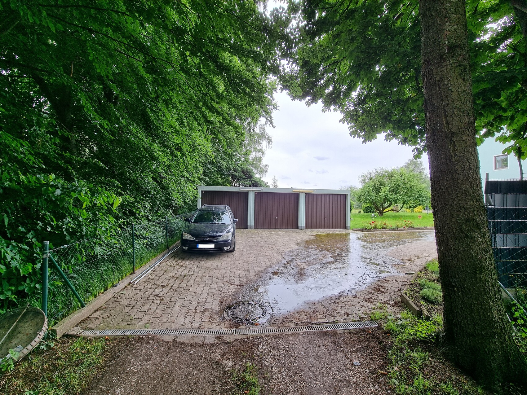

Due to flooding events, the house should be built 1 m (3 ft) above ground level; garages may remain at ground level
Existing building requires more parking than the existing double garage, at least 3 spaces
Garages on the east side because parcel 1560/6 has a continuous 10–12 m (33–39 ft) tall tree/bush line on the boundary

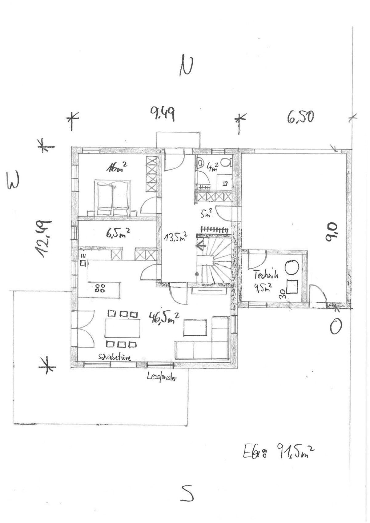

Ground floor: Open living and dining area; kitchen is directly integrated into life at the table
Ground floor: Pantry between work area and kitchen serves as an acoustic buffer

Ground floor: TV with stereo should ideally face the table to fill the whole room with sound

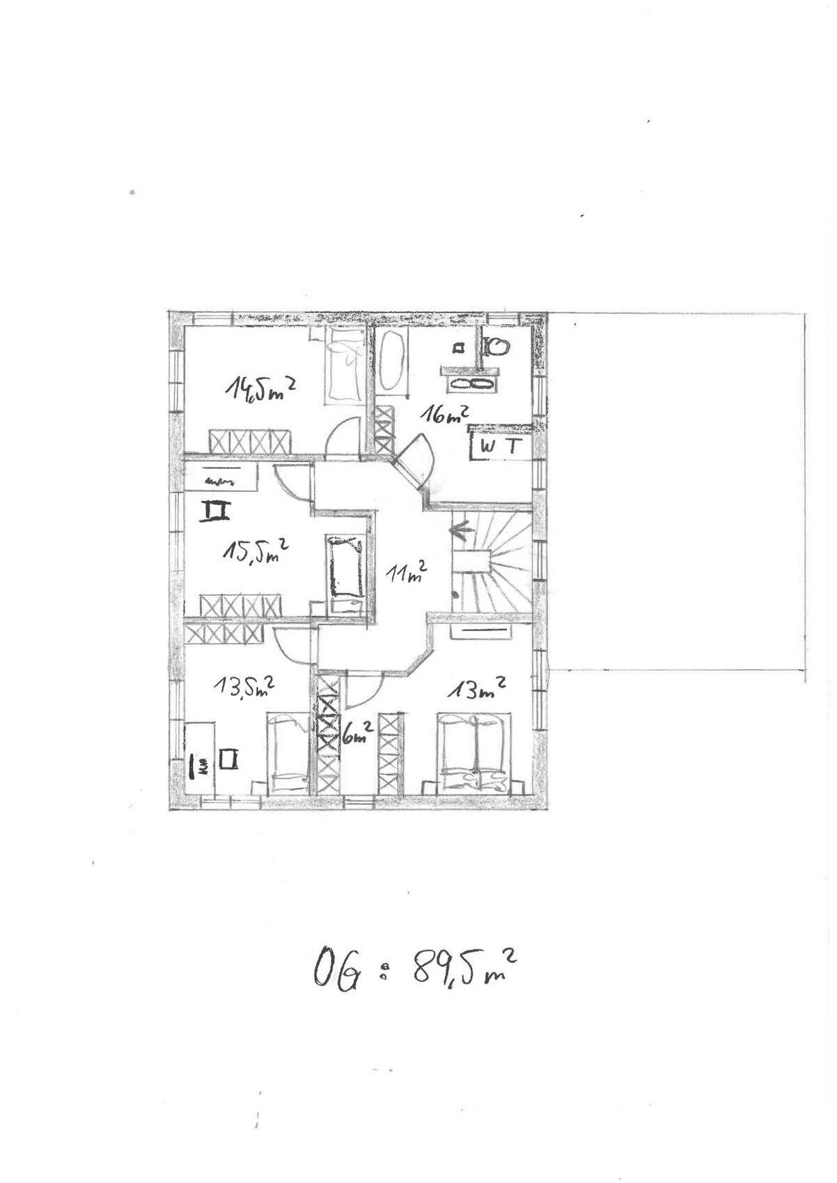

Upper floor: Too convoluted; children’s rooms are under 15 m² (160 sq ft)
Upper floor: No space for drying/ironing laundry

- 15 m² (160 sq ft) per child’s room

We like the ground floor layout; technical areas cause little noise inside as they are separated.

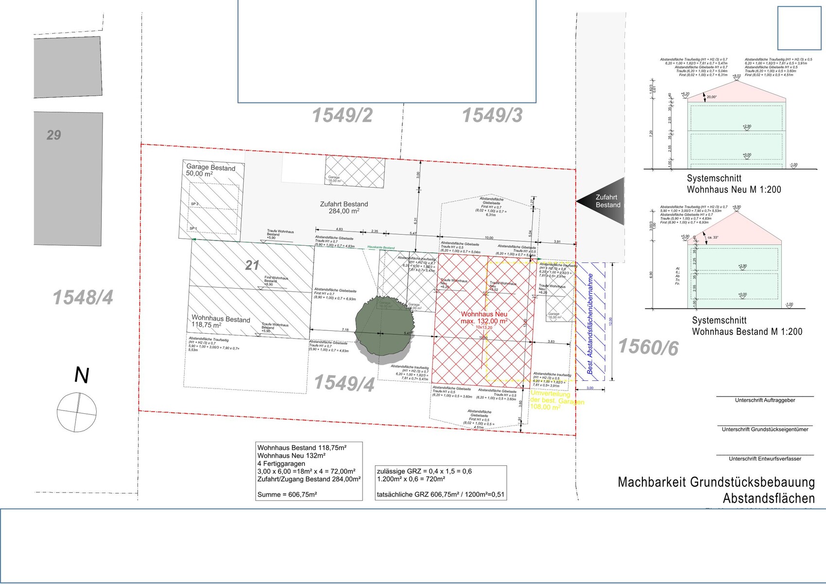

The plot plan originally anticipated reusing existing prefabricated garages; however, these have been sold, so we have a free hand.

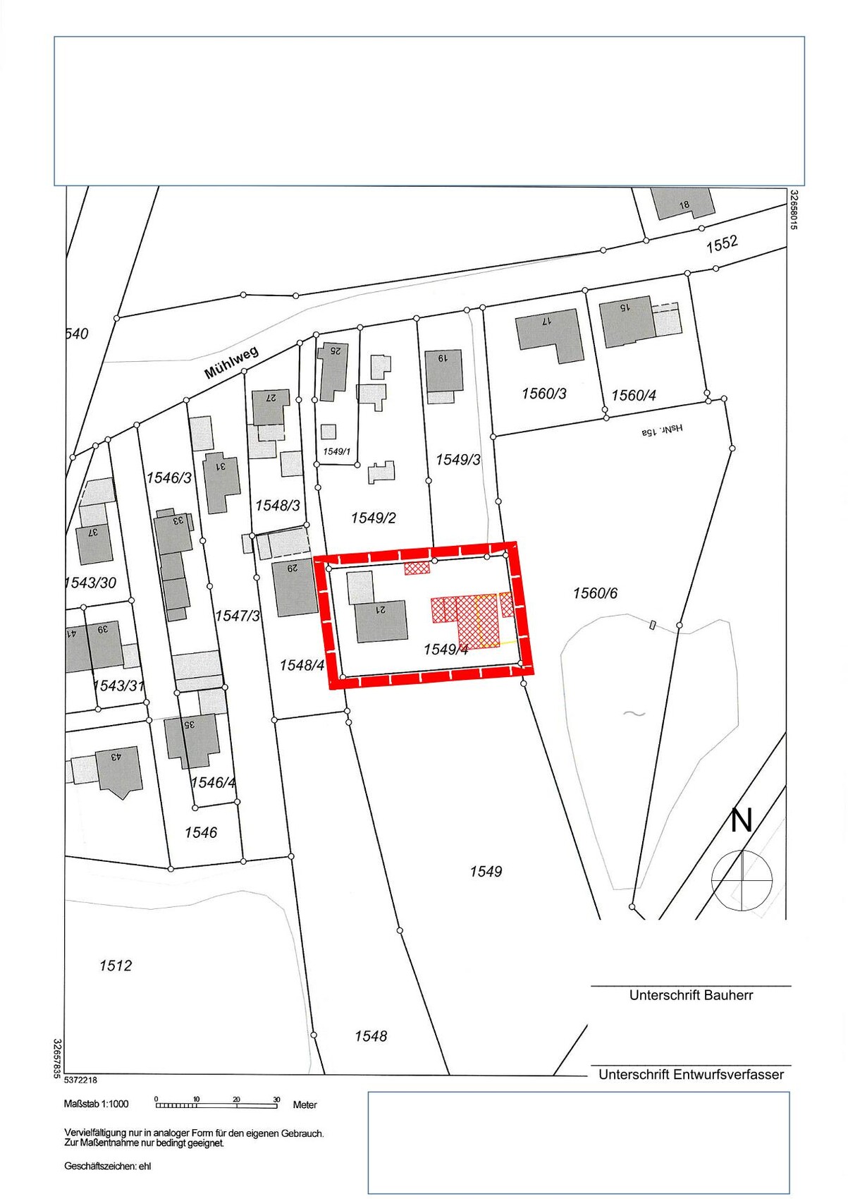

Site plan of a plot with red dashed outline around building plot 1549/4.
Site plan showing existing and new building areas, red outline and measurements, north arrow.
A black car parked in front of three brown garages, wet paved driveway, surrounding trees.

With the existing garage, we already have about 6 meters (20 feet) of boundary construction.
I had the impression that the northern neighbor might agree to an easement. Therefore, I don’t see the problem here, but rather that the width of the driveway, planned at a substantial 9 meters (30 feet), takes up too much of the lot’s depth compared to the existing situation.
The advantage of building in the rear part of the lot is that you generally don’t have to include a front yard — you can even plan an open space to sit in front of the entrance, whereas properties facing a street need to be separated by a front yard.
But cutting 9 meters (30 feet) from a 26-meter (85 feet) deep lot is painful. That leaves little or no garden space. Additionally, a double garage stretches the allowed 19.5-meter (64 feet) lot width to its limit.

I had the impression that the northern neighbor was willing to grant an easement.
I missed that. It should be put in writing first before any further planning.
But to take 9 meters (30 feet) from a 26-meter (85-foot) deep plot really hurts. That leaves little to no garden space. Besides, a double garage would stretch the 19.5-meter (64-foot) width of the lot to its limit.
Phew... and all this just for a large fleet of vehicles.
But the street is already there. Are you planning to remove it? That wouldn’t be my biggest concern.

A dedicated space for closets and therefore additional usable area in front of the closets, separate and not integrated into the bedroom – just as you yourself have drawn it. That adds about 3m² (32 sq ft) more compared to conventional planning.
I would tend to agree with that. A space for extra usable area in front of the closets, as I initially sketched. But we can also offer it as an optional feature 🙂
But you didn’t really address that.
Hmm, then I must have forgotten. I liked the idea, especially if it simplifies the room layout. Also, it would create guest parking spaces in front of the garage. The space behind the garage probably won’t be used much anyway.
You are quite rigid with your parameters. Nothing seems open for discussion or compromise on your side. First it was the utility room that absolutely had to be half-height, then it was the roof pitches and house orientation, then the terrace positioning. I’ll leave out the part about the children’s rooms, which shows how inflexible the thinking is.
Well, the children’s rooms are important to me because too often they feel like prison cells. Bed, desk, closet, a little space to turn around, that’s it. No room to change the layout much or areas where kids can play alone or retreat. But if I’m supposed to plan without square meter figures, then at least you now have a rough idea of how I envision children’s rooms.
This rigidity, for example insisting on nice children’s rooms or the office with minimum square meters, is a big mistake. Either you can afford it or not. There are very nice and spacious 12m² (130 sq ft) children’s rooms that easily outperform some badly planned larger ones. A good plan, a good design, works without needing exact square meters; just 3 to 4 must-have dimensions are enough to make a house or room functional. But even those measures are not set in stone if a compromise leads to a nearly 90% perfect house design.
If I seem too specific or inflexible with my ideas, I’ll try to explain it differently further down.
I have another issue: The current property has a double garage/carport of 6 meters (20 ft) set back from the boundary. Then there is a garage in the middle, but it's unclear if it will be rebuilt or already exists.
As the preliminary planning currently stands, at least in the plans presented to us, the site width used here is 9 meters (30 ft). That leaves you approximately 17 meters (56 ft) for garden and house. For me, that’s another reason to try rotating the house layout.
The garage in the middle can be disregarded; that was the architect’s suggestion to reuse the old garages. The garage length along the property boundary is indeed a problem. But there is an existing easement for setbacks on the east side; this was lost when the existing garages were removed. However, upon inquiry, the neighbor indicated willingness to re-grant this easement for the new building, as that area currently only has bushes and trees.

You need some space for the driveway curve alone to get from the entrance to the garage, but yes, 9 meters (30 ft) is tight. On the north side, you could gain some space, but I don’t know if the parents would agree because then they wouldn’t have a convenient approach to their garage.

Well, then you just don’t build. Otherwise, the lot would be more driveway than buildable land. In the end, you will probably be better off and have an easier time buying another plot where flooding is less of an issue.
Because your 507sqm (19.5 x 26) minus 117sqm (19.5 x 6) driveway leaves 390sqm. And you want to cover that with 100sqm ground floor area plus a double garage plus additional building area. That just doesn’t leave much. Sorry, almost nothing.

Well, then you simply don’t build. Because in that case, the lot would be more driveway than building plot. Ultimately, you’ll probably be better off and it will be easier if you buy a different plot where flooding is less of an issue.
Your 507 sqm (19.5 x 26 m; 217 x 85 ft) minus 117 sqm (19.5 x 6 m; 217 x 20 ft) for the driveway leaves you 390 sqm. And you want to cover that with a 100 sqm building footprint plus a double garage plus an additional building. There simply isn’t much space left. Sorry, hardly any.

Even without intentions to subdivide, you should mark out virtual claims as to which parts of the plot are intended for which types of use. Physically, you might want to avoid fences, but mentally you need to draw boundaries. Just as every building has to be structurally sound on its own, it also needs to function on its own. Usage restrictions can also harm mortgage valuations.
Yes, we planned that. Once the building permit / planning permission has been granted, the plot will be subdivided according to those claims. I will have to take care of both plots anyway, so that gives us a good starting point. But that will only come into play once we have a plan for how it will look in the end.
