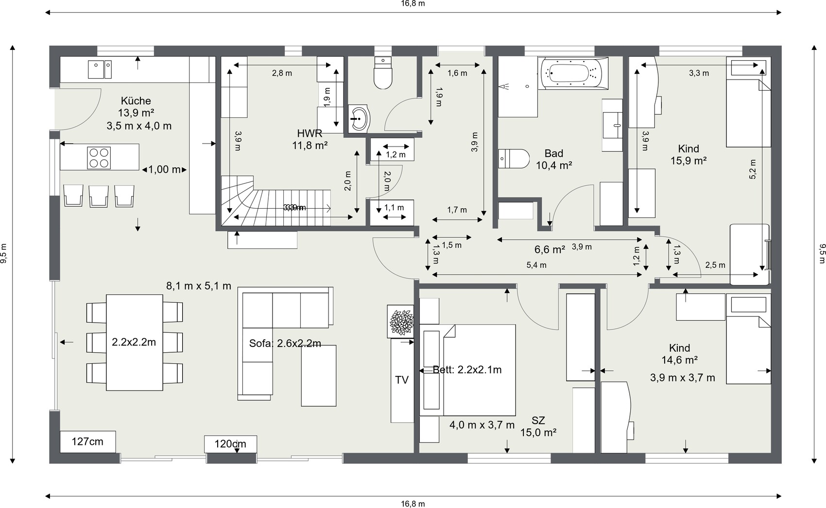

we have finalized the floor plan for our project and tried to incorporate feedback/criticism from the previous thread. A new thread was also necessary to include relevant information in the initial post.

My last post, because I really don’t want to continue: think about what kind of kitchen you want, not how to fit your old kitchen into the space.
Again: ergonomically, a two-row kitchen with about 120cm (47 inches) of space between is best. There are four of you, so the kitchen shouldn’t just be for show cooking—it needs to be fully functional. You don’t have unlimited square meters available (nordlys lives on a similar amount of space with two people—that’s a different situation than for four).
So decide NOW what your kitchen should be like, what your requirements are, and what matters most to you. If you want the ballroom you planned at the beginning, go for it—I’ll keep quiet and won’t point out the lack of storage anymore.
Saying “I’ve now drawn in our current kitchen” is simply not helpful.

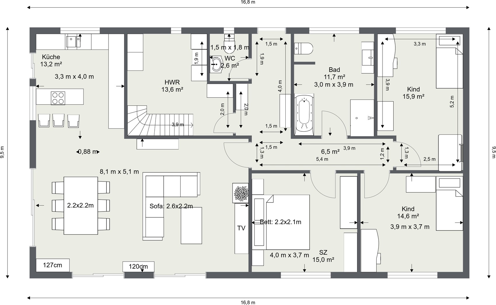

@Climbee we just can’t get excited about the two-row kitchen layout.
- It will be an open or semi-open kitchen (depending on whether a lintel needs to be installed, according to the structural engineer/architect)
- The kitchen width is currently kept ‘flexible’ between 3.00m and 3.50m (this will be finalized with the architect)
- Kitchen style: L-shape with peninsula
- Freezer will be placed in the utility room
- This allows us to roughly plan the water connections and electrical setup

In this final plan, the distance between the sink in the main workspace and the cooking island looks very large, about 150 cm (60 inches) or so. Personally, I find that much too much.
In the guest bathroom, I would place the toilet and sink next to each other on the left wall.
If the distance between the sink row and the peninsula is only 100 cm (39 inches) according to your measuring tool, then the kitchen cannot be 400 cm (157 inches) long either. Measure properly; the issue is not the patio door there, but the distance between the kitchen cabinets. I would have also estimated the peninsula width to be 180 cm (71 inches).
