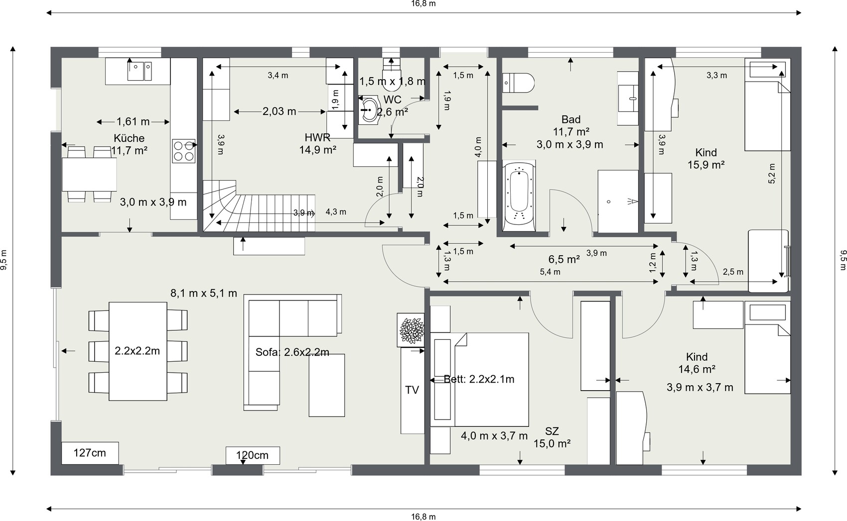

we have finalized the floor plan for our project and tried to incorporate feedback/criticism from the previous thread. A new thread was also necessary to include relevant information in the initial post.

I have accurately drawn our current kitchen layout (without wall cabinets and additional shelves). The dimensions of about 3 x 4 m (width x depth) seem like a good compromise to me; any narrower, and it would feel too 'corridor-like' or the entire room, with its 2.40/20 m width, would look like a narrow extension to the living room.
If we choose an open U-shaped kitchen, the walking/turning space would be about 160 cm (63 inches), which should still be acceptable or not too problematic thanks to an ergonomic arrangement of the "workstations."
By "solution with the peninsula," are you referring to your drawn Variant 2?
Thank you.
One question regarding space-saving stairs: what is the maximum incline angle it should have to still be 'comfortable' to use when carrying items with full hands?

kbt09
18 Oct 2019 20:59
Now there is a table in the kitchen again.

Nice plan. Leave it as is and build.

19 Oct 2019 07:44
kbt09 schrieb:
Now there is a table in the kitchen again after all.
Good morning, please read carefully! I have drawn in our current original kitchen to get a practical sense of the space, and based on that, I can say I don’t want to set the width below 3m (10 feet).
@Nordlys Do you also have a space-saving staircase? If so, what is the slope and what are the dimensions? We need about 2.60m (8.5 feet) (see #168).

19 Oct 2019 07:45
Currently, it is an L-shaped layout with a table, which is not the same as a two-line layout without a table... in that case, 3m (10 feet) is simply too much.

19 Oct 2019 13:45
Our kitchen would be EXACTLY like that. That way, you don’t have to go to the dining table for every sausage on a plate or a quick hot cup. You can also sit down wearing work pants and drink a beer with dirty hands.
Stairs. In my opinion, your plan shows a standard staircase in an L shape. We have a U-shaped one. Don’t use a space-saving staircase. It’s unnecessary given the space you have. A regular staircase simply allows comfortable walking, even when carrying a chair under your arm or a box in front of you. K..
