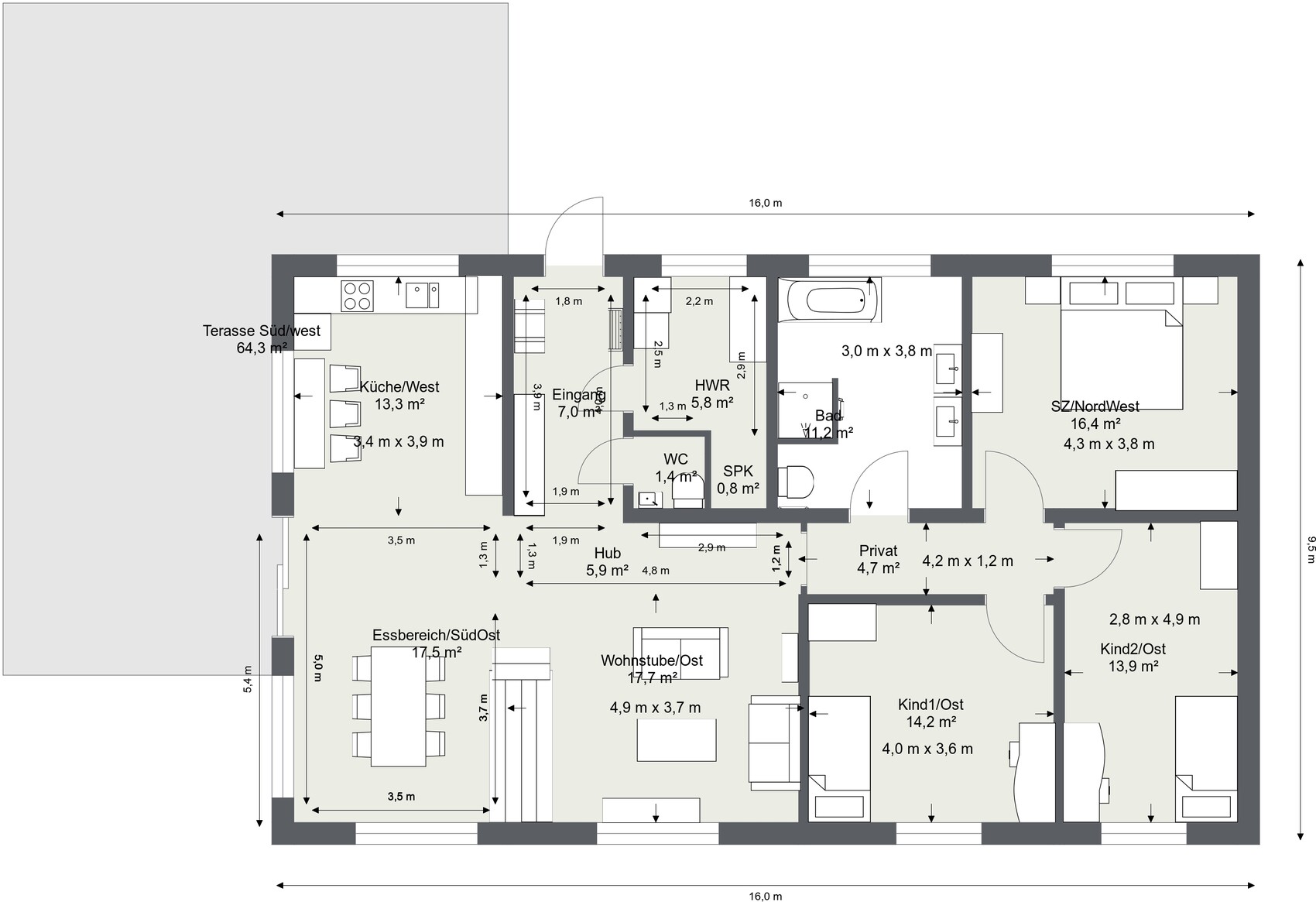

we have finalized the floor plan for our project and tried to incorporate feedback/criticism from the previous thread. A new thread was also necessary to include relevant information in the initial post.

Hand-drawn floor plan of a building with rooms, doors, and dimension lines.
Floor plan of a house: living, dining, kitchen, bathroom, bedrooms, terrace.
3D floor plan of a house with living room, dining room, kitchen, bathroom, bedrooms, and terrace.

As mentioned, I do not see this as a loss of comfort; rather, the positive aspects of the floor plan outweigh this for us if we place the entrance on the east side. Attached is the mirrored version.
Positive/Neutral:
- Entrance on the west side
- Children's room on the east side
Negative:
- Rooms not used for living/leisure are oriented toward the garden (west) [utility room, bathroom, bedroom]
- Living rooms face a white wall belonging to the neighbor [yes, it will be greened, but the viewing depth is only about 2.50–3m (8–10 feet)]
- The air-to-water heat pump requires an outdoor split unit, which is now visibly and possibly audibly placed in the garden (west side)
- The terrace no longer surrounds the entire dining area but now only the kitchen
As mentioned, it would be

micric3 schrieb:
As mentioned, I don’t see this as a loss of comfort; rather, the positive aspects of the floor plan outweigh the negatives for us if we place the entrance on the east side. I have attached the mirrored version for reference.
Positive/Neutral:
- Children’s room on the east side
Negative:
- Rooms not used for living/leisure are oriented towards the garden (west) [utility room, bathroom, bedroom]
- Living rooms face a white wall of the neighbor’s property [yes, it will be covered with greenery, but the viewing depth is only about 2.50–3m (8–10 feet)]
- The air-to-water heat pump requires an outdoor split unit, which will now be installed visibly and possibly audible in the garden (west side)
- The terrace no longer surrounds the entire dining area but now surrounds the entire kitchen
What if you swap the kitchen and living room? Then the kitchen would be the first room you enter and serve as the dining and kitchen zone, while the living room would be nicely positioned on the west side, which would be quieter... provided the room sizes meet your needs.
24 Jul 2019 08:10
Reluctance schrieb:
What if you swap the kitchen and living room? Then the kitchen becomes the first room you enter, making it the main living area, while the living room is nicely positioned on the west side and a bit quieter... if the room sizes work for you.
We discussed this at the beginning, and the original poster doesn’t seem to agree. If anything, the living room should be large and representative. The kitchen is better kept hidden, etc. Even visiting teenagers won’t hesitate...
micric3
24 Jul 2019 08:50
Hello Yvonne, with all due respect, but to put it bluntly, that is nonsense!
Our focus is on a nice open floor plan with optimal room sizes. Just because you might want to retreat to your ‘small’ living room doesn’t mean others will automatically do the same.
I have taken a lot of your advice seriously and am grateful for the tips. Yes, the kitchen turned out a bit smaller than desired, but it connects seamlessly to the dining area, so it’s not excluded as a “center of daily life.”
What’s important to us is that we don’t just have a rectangular living room/kitchen space facing south (which is quite common to see).
@Reluctance: The idea itself isn’t wrong, but in practice it’s not suitable because the kitchen is oversized (almost 35 m² (376 sq ft) including the dining area). Also, since the light comes only from the west (in the evening), the dining area and kitchen should be separated by a wall.
I am aware that the floor plan design is not easy due to the requirements regarding orientation, access, and the existing building, which is why I’m here.
haydee
24 Jul 2019 09:06
Why do you have to be 9 m (30 feet) away from the western boundary?
A terrace next to the kitchen is more practical than one by the living room.
micric3
24 Jul 2019 09:42
I don’t have to, but it makes the most sense to me. What are your thoughts?
