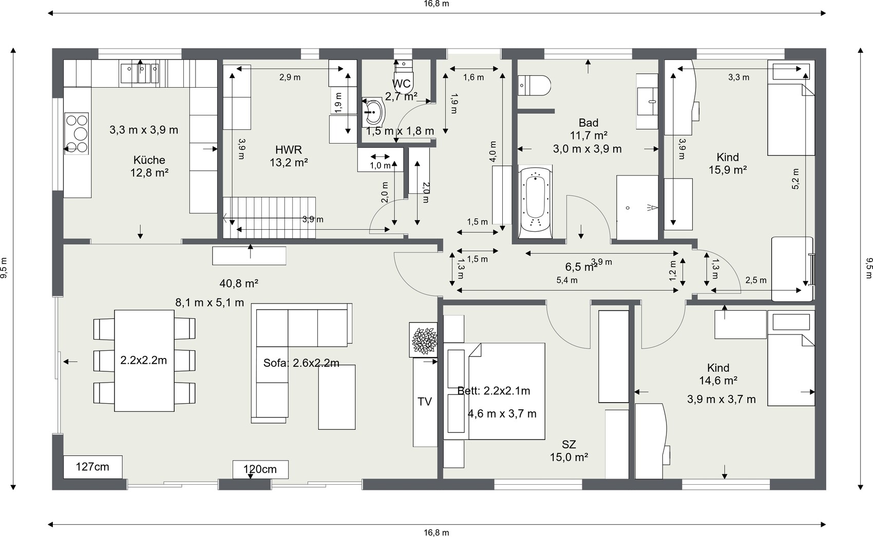

I have now focused [only] on the topic of "storage space."
- Kitchen reduced in width accordingly
-- changed from L-shape to U-shape with a window facing south instead of a door
- currently designed as a closed kitchen
-- ideas for an open layout are welcome
Added utility room
- space-saving staircase (needs to cover 2.60 m (8.5 ft))
-- drawn in the floor plan with a length of 2 m (6.5 ft), but will likely be 2.5 m (8.2 ft) at a 44.5° angle
-- experience-based advice is appreciated
- additional space for: freezer, bottles/drinks, coat storage, laundry
- guest toilet widened
- entrance narrowed to 1.60 m (5.2 ft)
