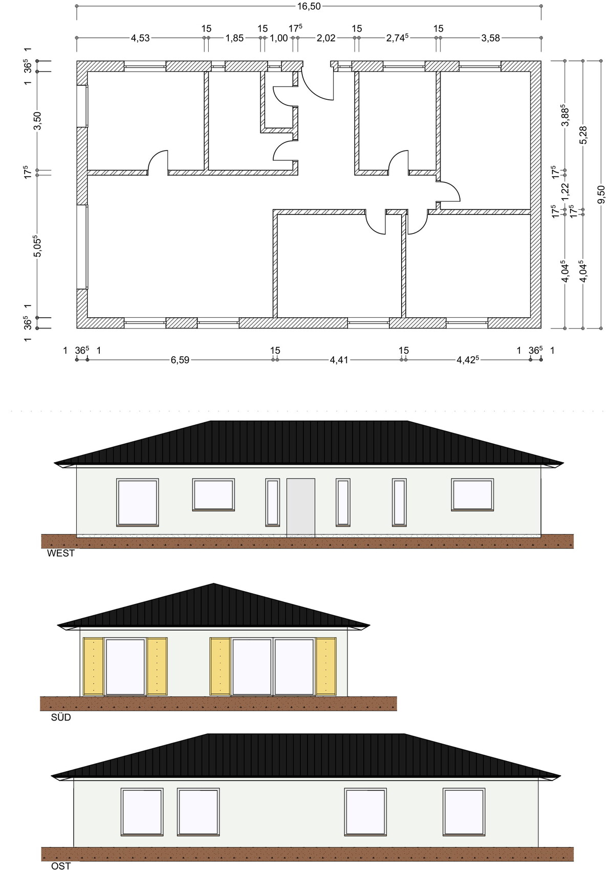

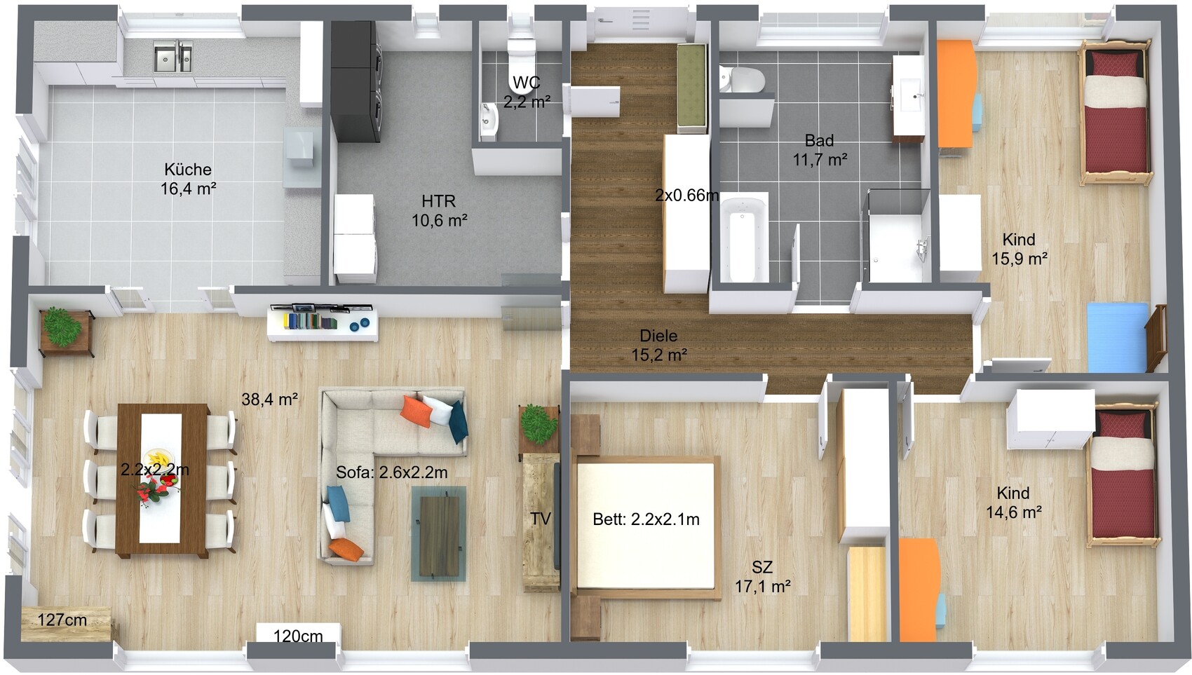

we have finalized the floor plan for our project and tried to incorporate feedback/criticism from the previous thread. A new thread was also necessary to include relevant information in the initial post.

micric3 schrieb:
Having multiple partners is tempting, but .. with only one kitchen, there can only be one woman. Haha ... are we dealing with a macho household here?
micric3 schrieb:
The "dining table" in the living room is more for social purposes: crafting, games, guests, special occasion meals. In my opinion, this table will remain, and if anything, the one in the kitchen will disappear. Yes, of course, when reducing redundancy, you remove the duplicate.
Yes, of course, when eliminating redundancy, you remove the duplicate.Makes sense, two women at one table fit easily...Zaba12 schrieb:
I’ll send you some photos of the ground floor via private message tonight.
Please don’t forget
Thank you
kaho674 schrieb:
Having light from two sides in a room creates a very different spatial feel. If possible, I would never give that up. It also gives you a much better chance to bring natural light into the room (even on the north side – light can bend around corners!). The size of the windows is less important in comparison. Also, windows are usually not more expensive than walls.Honestly, I’m not sure anymore if children’s rooms really need windows facing north because of furniture placement.
In addition, we will extend the house by 1 meter (3 feet 3 inches) compared to the standard.
The roof will have a prefabricated truss construction designed as a dry attic with a load capacity of 200kg/m² (41 lb/sq ft), which provides enough storage space for various stuff.
All windows will be fixed glazing, placed 40cm (16 inches) above the floor, 180cm (71 inches) high, and 190cm (75 inches) wide.
Regarding the bathroom window:
- Prefer floor-to-ceiling with optional privacy glass (“frosted glass”) in the lower half
or
- Smaller and matching the kitchen window?
--> Actually, no one (outsiders) can look directly inside since there is no public walkway.
Are the general window dimensions well chosen in terms of "furniture placement/window sill seating," daylight admission, and space?
Good luck
micric3 schrieb:
The windows will all be fixed glazing, 40cm (16 inches) above the floor, 180cm (71 inches) high, 190cm (75 inches) wide. One hardly wants to question the oddity of your planning approach. Aside from the Frankenstein-style design, I would never, even with the best mechanical ventilation system, consider completely excluding traditional ventilation in sleeping areas. I hope your pride of ownership will be strong enough to help you get over the unsatisfactory result. Sometimes even a standard design from an experienced professional is better than the unique work of an apprentice.
