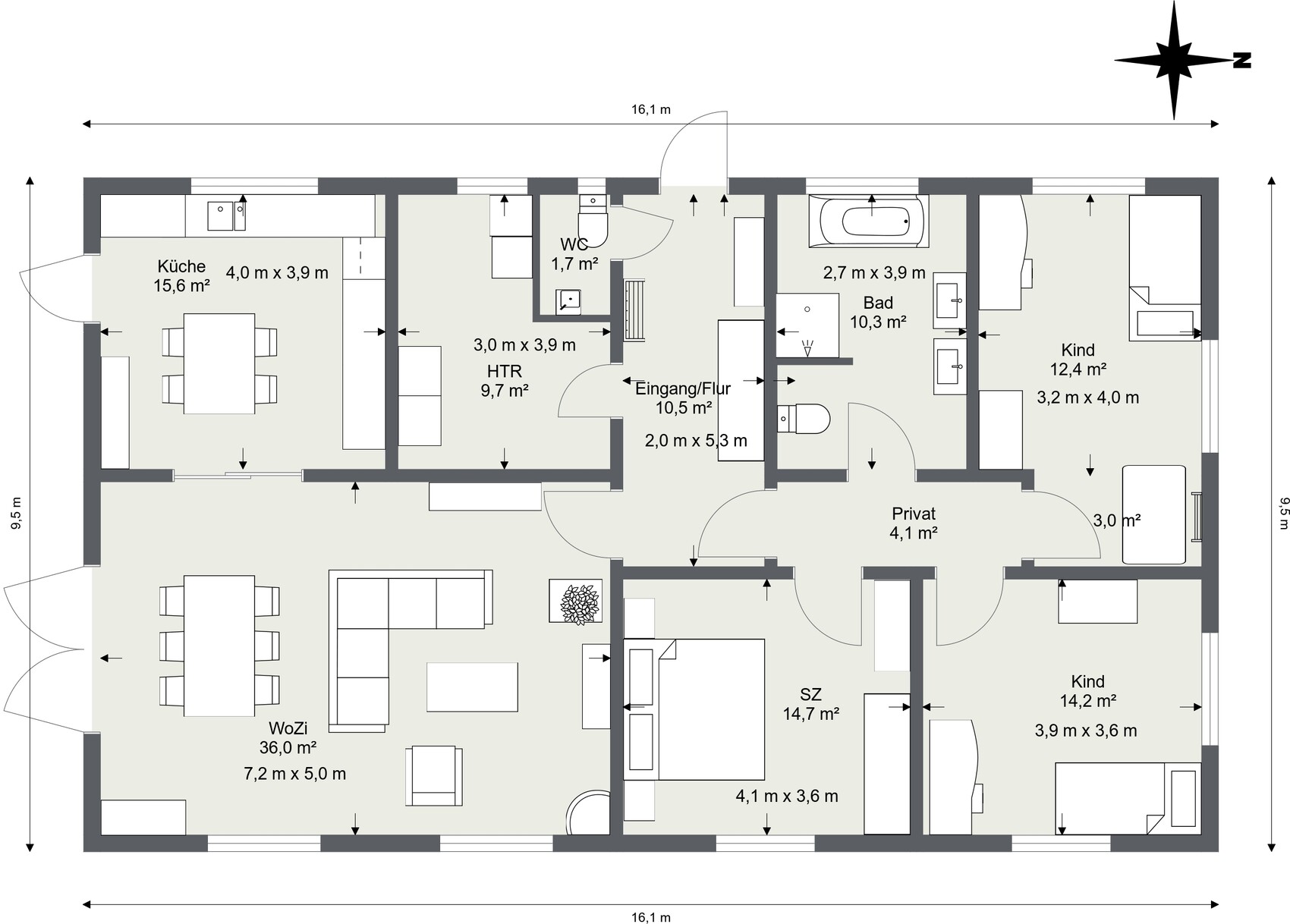

we have finalized the floor plan for our project and tried to incorporate feedback/criticism from the previous thread. A new thread was also necessary to include relevant information in the initial post.

- Based on the bungalow 131 floor plan from Town & Country
- Design planned independently using RoomSketcher
- Room layout (size)
- Room divider between kitchen, dining room, and living room (L-shape)
- No hallway
- Open area as a transition space between kitchen and living room
Cost estimate from architect/planner: 215,000
Personal budget limit for the house, including fittings: 250,000
Preferred heating system: Air-to-water heat pump (either Vaillant aroSplit or Vaillant FlexoCompact)
- Dissatisfaction with the designs created in the old thread

.. so effectively you don’t get more space than in a 95 m² (1023 sq ft) apartment, only the kitchen is larger. And there’s no basement for storing all sorts of stuff either!We currently live in a 90 m² (969 sq ft) apartment. There are hallways here too. Although the utility room is an addition, it will ultimately just house the washing machine and dryer. At the moment, the dryer is in my office. My office is in the outbuilding, which is 80 m² (861 sq ft), where a small apartment including storage space is being created. There will also be another shower there, which makes up for the lack of one in the bungalow. There is plenty of storage space in the attic as well. Otherwise, all the closets follow the layout we currently use.
Current changes:
- Guest toilet
- Children’s room widened by 10–15 cm (4–6 inches) (taking space from the living room and utility room)
Further planning needed:
- Main bathroom
- Kitchen layout
- Windows in general (size and position)
The hallway is much too narrow, there is no adequate storage space for clothes in the bedroom, the guest toilet is not accessible, the children's room at 12m² (130ft²) is borderline small and narrow, there is no pantry and the kitchen is small, and the dining area feels very cramped alongside the living room.
There are really shortcomings everywhere.

There are really deficiencies everywhere.And your advice is? .. to just add 30m² (320 square feet) at a stroke?
