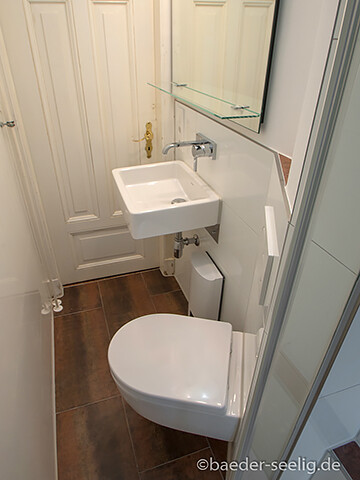

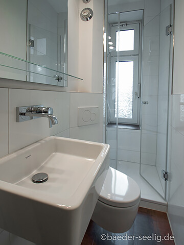

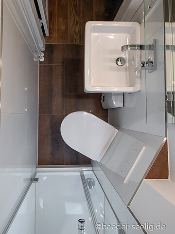

this generally doesn’t work either, or do you find a bathroom functional if you fall over the toilet???
here is a scale drawing but still with rough construction dimensions (so you still need to subtract for plaster and tiles). and do you really want to shower here???? washing your hands will cause flooding, you can hardly fit a towel in either. but at least if you have stomach flu you can throw up from the toilet into the shower (the sink is too small)....
It’s a good start, if somewhere you still need 10cm (4 inches) more, that’s not a big deal. This is about the guest bathroom, which is not used daily. The towel will be hung on a hook on the door.
Matthew036 Aug 2019 15:38You urgently need to try to recreate this using objects you have nearby... you can’t even enter properly, have you closely looked at the drawing by @j.bautsch? This simply isn’t sufficient for a shower...
kaho674 schrieb:
And you want it like that??? I didn’t say that. This is generally about the feasibility and planning of small bathrooms in my current floor plan.
