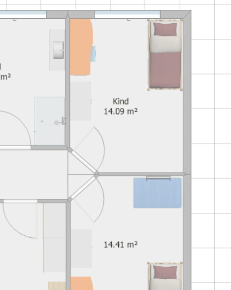

Hello Yvonne, welcome back.
We have already discussed the topic of sloped ceilings before.
As a purely theoretical exercise, I have drawn two rooms with doors set into the sloped ceilings. Both are positioned almost at right angles to each other. Most likely, the doors would need to open inward (that is, opposite to the way shown in the drawing) to avoid cramped space. The idea behind this is simply to adapt both rooms and reduce the walking area.
micric3 schrieb:
As a pure thought experiment, I have drawn two rooms with slanted entrance doors. Both are positioned almost at a right angle to each other.In my mental cinema, I hear Jochen Malmsheimer pronouncing the word "substances."https://www.instagram.com/11antgmxde/
tempestas14 Oct 2019 01:55micric3 schrieb:
Honestly, I'm not sure if the children's rooms still need windows on the north side...
All the windows will be fixed glazing, 40cm (16 inches) above the floor, 180cm (71 inches) high, 190cm (75 inches) wide. Um... windows that can be opened for ventilation? What happens in case of a technical failure of the mechanical ventilation system or a power outage? Then no window in the house can be opened? Is something like that even allowed under building regulations?
Tell your wife you want to install fixed glass windows almost everywhere, and you’ll probably get a slap.
I hope by now you’ve realized yourself that this is a bad idea. Make a pros and cons list, and you’ll quickly see there are many disadvantages.
I’m curious to see the outcome.
Actually, it’s almost ridiculous to even use resources for a design and ideas like this (all fixed glazing – I’m still gasping for air from laughing).
