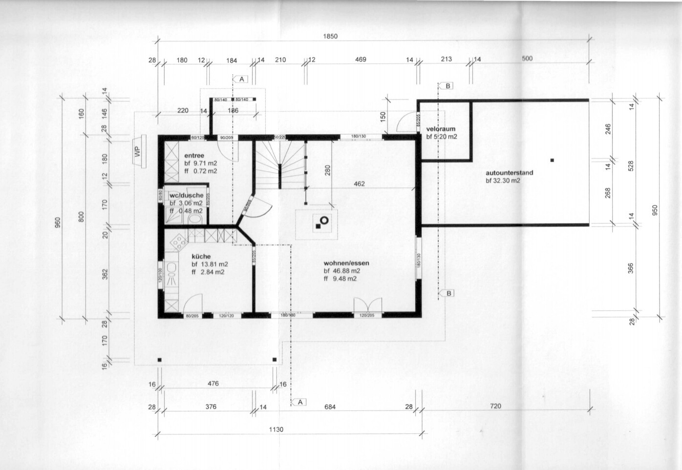

A floor plan of the existing structure including the window is also helpful.

Attached is the current floor plan. The wall is non-load-bearing, but this will be confirmed in detail.
