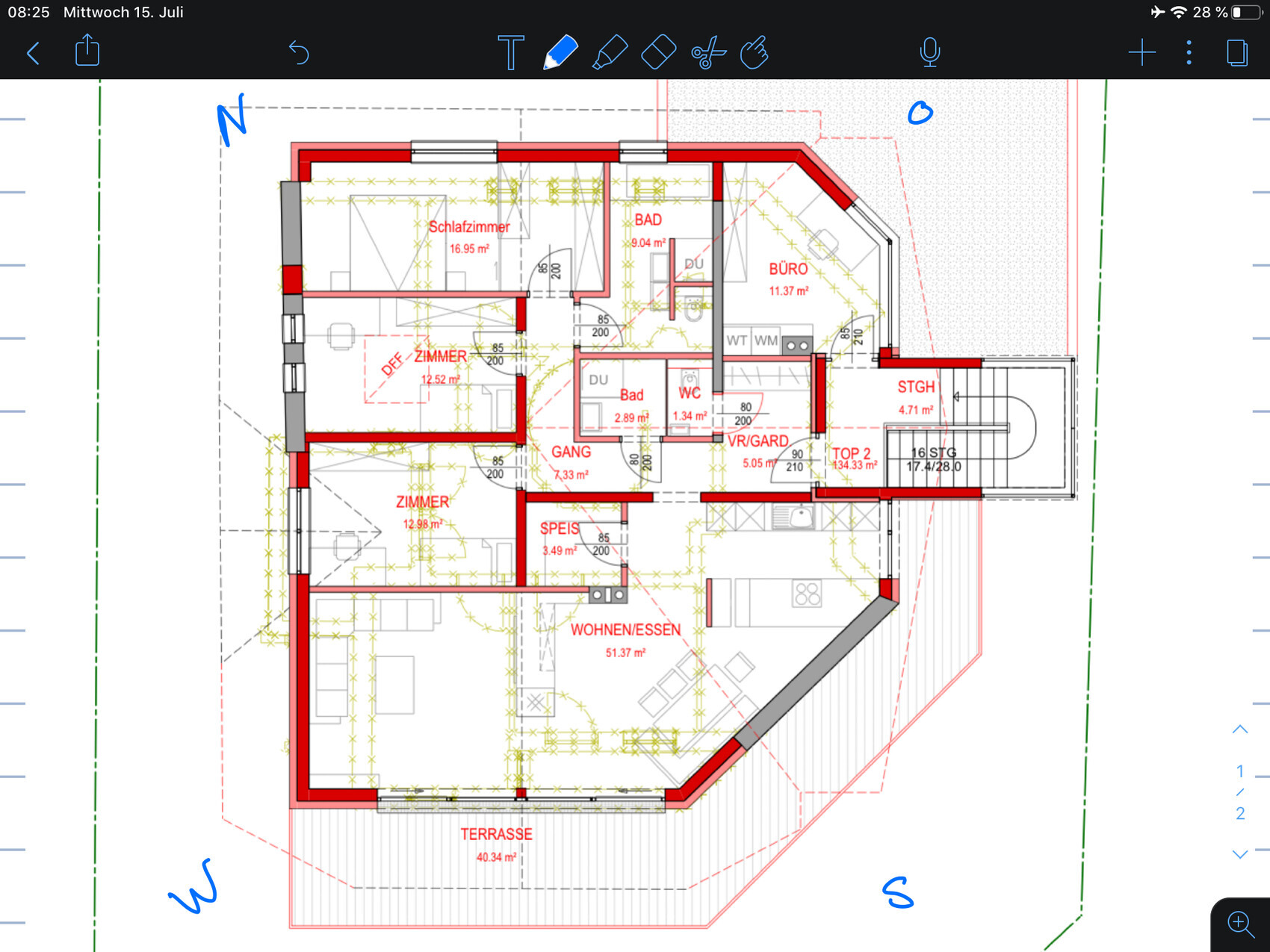

Hello dear community!
I am new here, so please forgive me if I have not included all the information right away. I can gladly provide more details if needed.
We are currently remodeling the upper floor completely to create a separate apartment for ourselves. My parents-in-law will remain in the ground floor. Everything will be fully separated, meaning a separate staircase, cellar partition, etc.
I have followed the guideline somewhat. I hope the information is sufficient; otherwise, I can provide more as mentioned.

What do you particularly like? Why? I really like the plan. But maybe I’m wearing rose-colored glasses?
What do you not like? Why? Possibly a small children’s bathroom
Personal budget limit for the house including fittings: 500,000

- So far, I am very satisfied with the plan. It basically reflects what we envision. Still, I’d love to hear opinions—perhaps we are a bit biased.
- The children’s room door will be moved down so that the parents’ area can be fully separated with a door in front of the master bathroom.
- The only concern is the children’s bathroom and guest WC—I don’t see how to make them larger. Do you think this will work and look good?
Orientation:
The master bedroom and bathroom are located NE
Living room and kitchen SW
Upper Floor
Gray walls are existing structure
East and south sides face municipal roads
I am aware that the possibilities are relatively limited due to the existing structure. Nevertheless, I look forward to your suggestions and tips.

lise84_bauherr16 Jul 2020 17:28Grillhendl schrieb:
Have you considered combining the children's bathroom, the toilet, and the planned wardrobe into one room? You could then add a window to the hallway (next to the office) and at least avoid having a pitch-black "bathroom."
The open-plan living, dining, and kitchen area is quite large at 51m² (548 sq ft). You could move the kitchen wall inward a bit and create a wardrobe area. Not a bad idea. What do you think about combining the children's bathroom and toilet into one room with a washbasin, shower, and washing machine? Then I would take some space from the office to create a more spacious guest toilet?

Grillhendl16 Jul 2020 17:38I would rather place the guest toilet where the current children’s bathroom is. Then, convert the guest toilet and the cloakroom into a children’s bathroom, and take a portion of the office space to integrate the laundry area with washing machine and dryer into the bathroom.
This way, you’d also avoid the issue of fitting appliances into the office.
Personally, I find a bathroom without a toilet somewhat impractical... (or you could separate it with a sliding door).

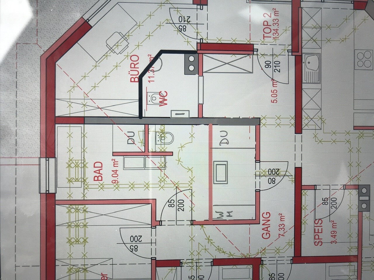

lise84_bauherr17 Jul 2020 09:10Grillhendl schrieb:
I would rather place the guest toilet where the children's bathroom is currently located, convert the guest toilet and the wardrobe into the children's bathroom, and then take a portion of the office to create a space for the washing machine / dryer within the bathroom.
That way, you’d also get rid of the built-in equipment dilemma in the office.
I have now tried to make some changes to the plan myself by drawing. What do you think? I believe the wardrobe wouldn’t be lost either.
Otherwise, I wouldn’t know where to put it.
