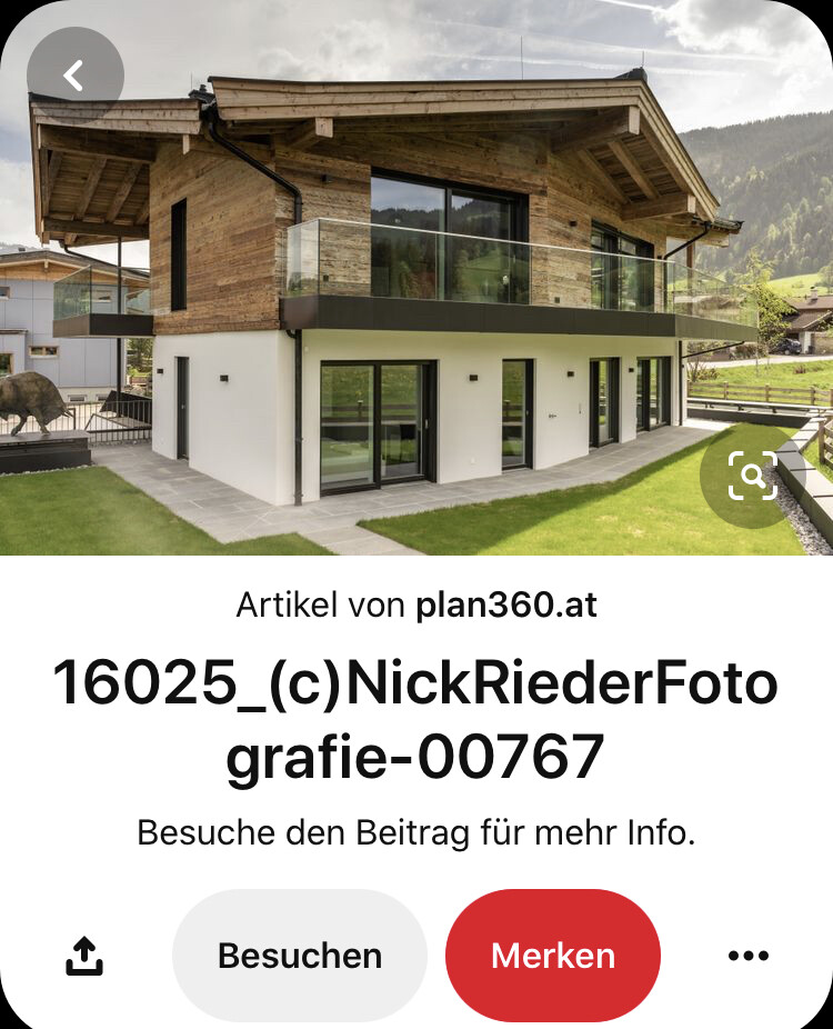

lise84_bauherr17 Jul 2020 09:25haydee schrieb:
How is the roof designed?Just as an example, here is a picture.
It is not planned as just a gable roof.
Do you see the shadow cast? It will be even larger on your side, which will significantly darken the area below.
It’s a pity. There’s no possibility to store anything under the roof.
Have you ever considered a complete demolition and building a new structure all in one go?

lise84_bauherr17 Jul 2020 11:20haydee schrieb:
Do you see the shadow? It will get even bigger on your side and will significantly darken the area below.
It’s a pity. No possibility to move anything under the roof.
Have you ever considered a complete demolition and building a new house as one single unit? Yes, but the roof on the main southwest side is already existing. If anything, it will get darker because of the balcony. But the roof itself doesn’t make that much difference since it has been that way so far. Or am I mistaken?
No, not the roof itself. Only the entire upper floor extension, whether it’s a balcony or the leveling.
Have you ever considered a demolition? You are investing a lot of money into a, to put it politely, less than ideal renovation. A lot is changing downstairs as well, and it doesn’t really fit. So why not start fresh and get it right for everyone?
L
lise84_bauherr17 Jul 2020 11:45haydee schrieb:
No, not the roof itself. Only the entire upper floor extension. Whether it's a balcony or the leveling.
Have you ever considered demolition? You are investing a lot of money in what is, to put it mildly, a suboptimal renovation. The ground floor is also changing quite a bit and doesn’t really fit. So why not start fresh and do it right for everyone?Yes, the balcony will darken it a bit. But my parents-in-law want to build a covered terrace underneath.
Yes, it is a lot of money. But significantly cheaper than building new. I could also buy an apartment nearby – but then I would only have 80 sqm (860 sq ft) for €550,000.
The layout is exactly how we imagine it. A few small changes still need to be made. I also think it looks very good from the outside.
But demolition costs a lot more than this.
