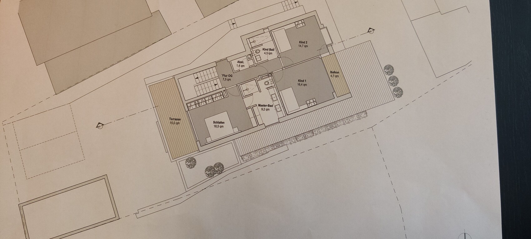

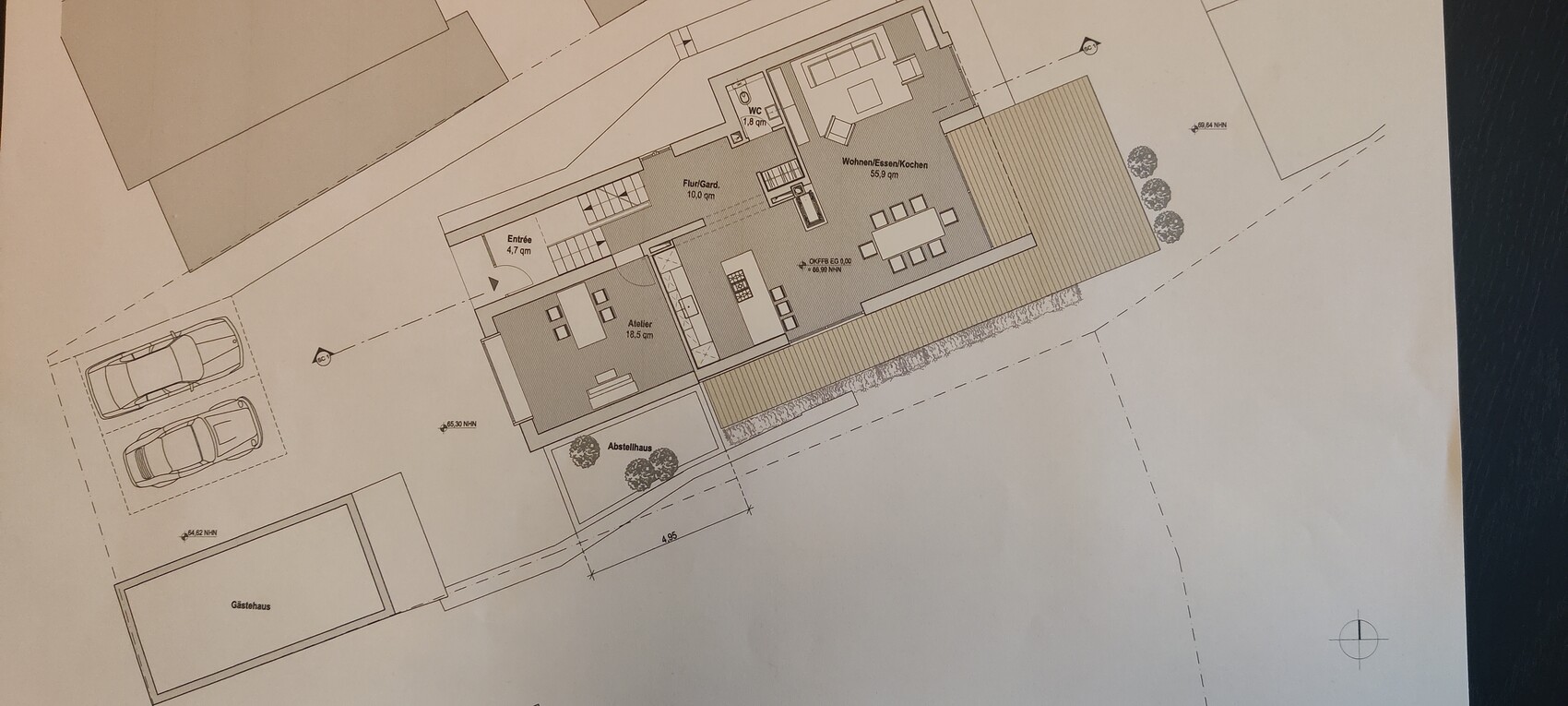

Here is the next update from us. The architect had already taken some things from our last meeting. The balcony was not yet a topic then, so the current adjustments do not yet include your ideas.
We had pointed out that the living room feels a bit like a corridor, the unequal children's rooms could be problematic, and our children love window seats. Also, the shed for bikes and garden tools was a bit small.
The plans were changed as follows for now:
1. The staircase has been moved slightly forward – so you no longer have to enter the studio through the living room but can access it from the hallway.
2. A cloakroom has been added on the ground floor entrance in addition to the one in the basement.
3. The kitchen and living area have been swapped. To keep the living area spacious, the bay window is now planned slightly larger than before.
4. The storage room next to the kitchen was removed. However, according to the architect, there is sufficient storage space due to the depth of the kitchen island.
5. The fireplace is now open on three sides, acting as a room divider (this is still completely open).
Now for the first floor:
6. Thanks to the larger bay window, the second children’s room has become bigger and now includes a window seat.
This slightly changes the garden-side facade.

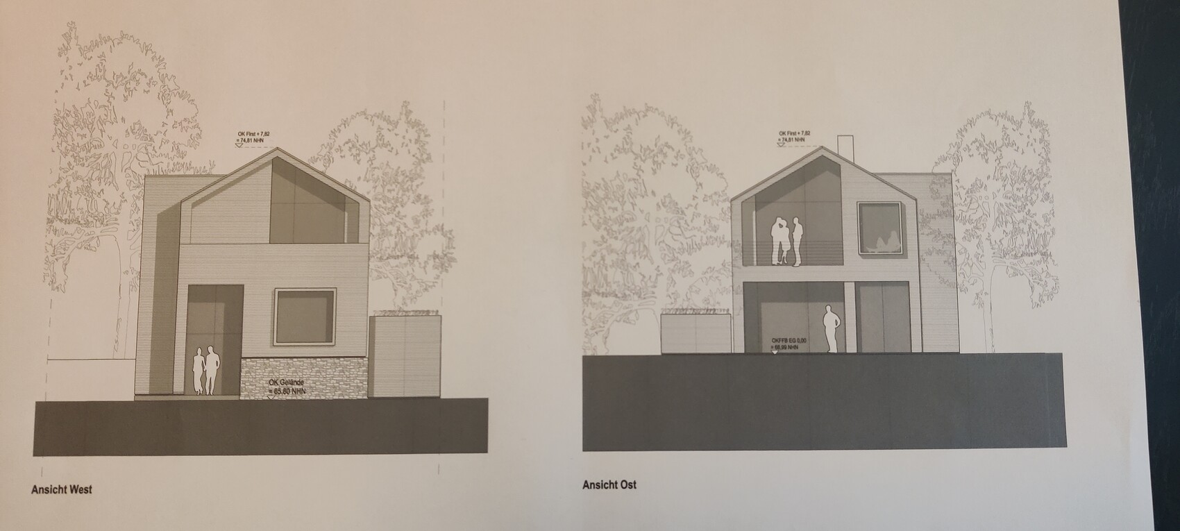

For the next round, we brought up the balcony in front of the bedroom for discussion. The architect is considering it but had very good arguments in favor of the balcony:
1. It’s the place to watch the sunset.
2. It faces the street. The balcony allows for floor-to-ceiling windows in the bedroom. With the parapet, the bedroom cannot be seen from outside; without it, you would need smaller windows.
3. The house is quite tall (from the valley side). To avoid the house looking like a disproportionate block, she wanted to give it some steps with the balcony.
What do you think? Costs are not being considered right now...
My concern is the walking space in the kitchen. Currently, there is about 1 meter (3 feet 3 inches) between the row along the back wall (3.50 meters (11 feet 6 inches), 80 centimeters (31.5 inches) deep) and the island (2.50 meters (8 feet 2 inches), 100 centimeters (39 inches) deep). I have read that you need at least 1.20 meters (4 feet), ideally 1.50 meters (5 feet), if two people are cooking together.
Regarding the structure: we are planning a timber frame construction with a wooden facade (larch). The cladding will be horizontal slats to avoid a stretched appearance. The roof has not been decided yet. What would you choose? Tiles? Zinc roof? Extensive green roof (is it even possible with the slope)?

Architektur-Grundriss eines Hauses mit Entrée, Atelier, Wohnen/Essen/Kochen, Terrasse, Garten.
Grundriss eines Obergeschosses: Schlafen, Kind 1, Kind 2, Bad, Terrasse, Balkon.
Zwei moderne Haus-Skizzen: West- und Ostansicht mit Personen am Eingang

buttyhome schrieb:
At the moment, there is one meter (3.3 feet) between the row along the back wall (3.50 meters (11.5 feet) wide, 80 cm (31.5 inches) deep) and the island (2.50 meters (8.2 feet) wide, 100 cm (39 inches) deep).
Why is the wall row planned with a depth of 80 cm (31.5 inches)? The standard for tall cabinets is 60 cm (24 inches)... depending on the countertop choice, you could also plan for 65 cm (26 inches).
If the island is supposed to offer enough storage space, I would suggest increasing its depth to about 110 cm (43 inches)— 60 cm (24 inches) standard cabinet depth on the kitchen side and a reduced 50 cm (20 inches) depth on the living room side. This way, the distance between the rows can be increased to around 105–110 cm (41–43 inches), which is sufficient. A recommended guideline is to be able to move smoothly between work areas without a large intermediate step by rotating from one work area to the other.
Depending on what kind of tall cabinet is planned for the lower left corner (for example, an oven cabinet), I would consider adding a window or a narrow patio door between the rows for better accessibility. This also provides elbow clearance near the window reveals.
In general, consider placing the cooking area along the wall (see Kitchen Planning opalau, also searchable via Google), with the sink on the island. This depends on your cooking habits.
EDIT:
Plan a cabinet and also a desk specifically for Child 1, then adjust the balcony access accordingly. I think the window area there could be somewhat narrower.
