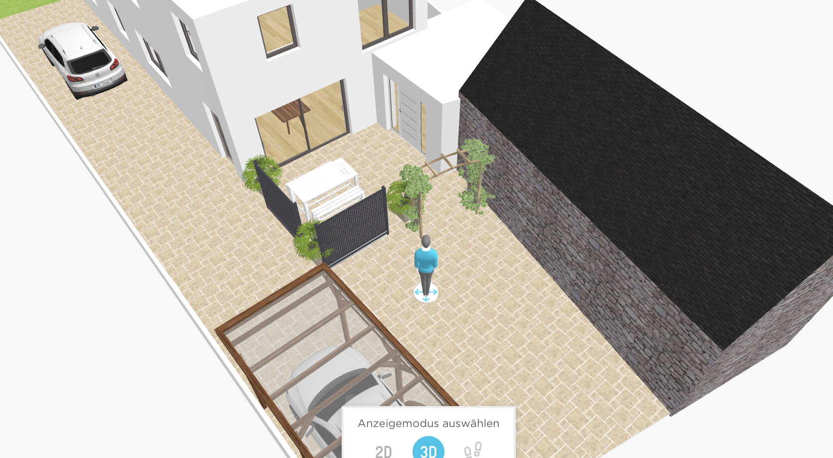

I’m curious if it’s legally possible to extend the connection between the listed building and the main house, and thereby raise your terrace one floor higher onto the roof. I can imagine that’s possible, but I don’t see the point: a) sitting on a platform right next to the neighbor’s garden, and b) enabling all kinds of access from the upper floor. You have the accessible slope to the north. So what’s the need for an additional terrace on the ground floor?
buttyhome schrieb:
If the courtyard is nicely designed, for example paved with large pots framing the seating area, it could really look great: Yes, I can definitely imagine that. How important is parking space for cars on your site?
