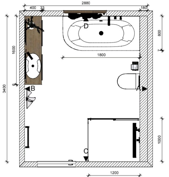

Floor plan attached.

K1300S schrieb:
That’s how it looks. That pipe is for the overhead shower. Can’t you put the shelf in the side wall? At the moment, it’s unnecessarily high.That would look a bit odd, since drywall also needs to go there. Would a narrower but longer shelf work with 18cm (7 inches) drywall? I’ll add the measurements.
Acof1978 schrieb:
We will probably just go for a bathtub that is 10cm (4 inches) shorter. I wouldn’t recommend that, not only because bathtubs in shorter sizes can be significantly more expensive. You get clean in the shower; the bathtub should provide a wellness experience.
May I say something? 😀
The wash area will also have a pre-wall installation… so I would rotate the bathtub toward the wall and place the toilet by the window next to the wash area. Visually shielded by the cabinets… and there would still be space for a shelf next to the tub 🙂 We are still considering. Thank you :-) (five and six)
If I may say something? 😀
The wash area will also get a wall-mounted installation… so I would turn the bathtub toward the wall and place the toilet by the window next to the wash area. Visually protected by the cabinets… and there would still be enough space for a shelf for the bathtub 🙂 We implemented it exactly like that and the planner is adjusting it.
So:
- Toilet under the window
- Bathtub on the right wall
- Shelf slightly above the height of the bathtub
- Base cabinet will be extended
- Very large mirror above the base cabinet.
