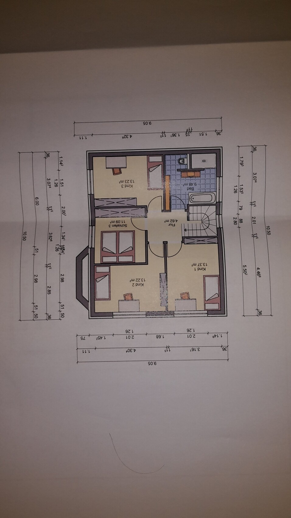

ᐅ Townhouse with 1,500 sq ft and three children's bedrooms – thoughts?
Created on: 1 Aug 2018 22:54
E
Eny85
Plot size 590 m² (6351 sq ft)
Number of floors 2 without basement
Roof style hip roof
Architectural style classic
Number of occupants, ages 4 (35/33/3/1)
Family use
Guest stays per year rare
Open or closed architecture: preferably open
Conservative or modern construction method
Open kitchen, kitchen island
Number of dining seats 6/8
Music/stereo wall
Garage, carport
Designed by:
- Do-it-yourself
Preferred heating system: air-to-water heat pump
2D floor plan of a house with bedrooms, bathroom and staircase.
2D floor plan of a house with living room, dining area, kitchen, hallway and staircase
E
Eny85
2 Aug 2018 19:12
Is that a normal door for a bathroom?!
E
Eny85
2 Aug 2018 19:16
There is also the idea of having the bathroom door open outwards. This would allow for a different bathroom layout!

Okay, so an 80cm (31.5 inch) door. Then take a look at your floor plan: the opening to the bathroom is half as wide as the door.

Eny85 schrieb:
We like the upstairs
How old are your children?
When they’re around 13 and older, you might feel uncomfortable if their friends stay overnight, and/or if the 17-year-old’s girlfriend spends the night.

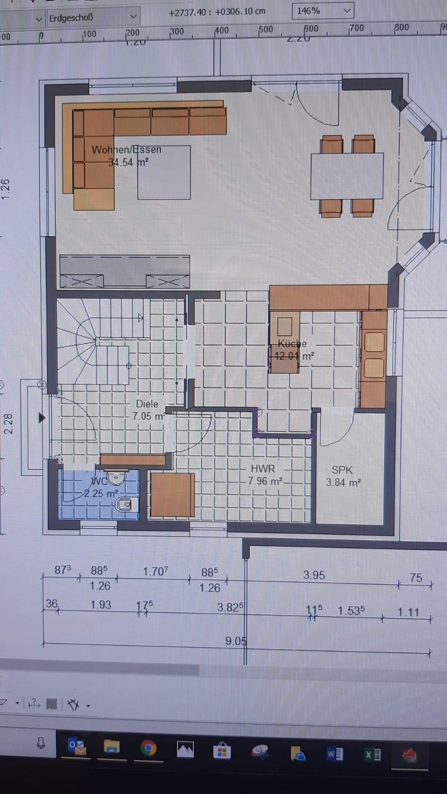

Eny85 schrieb:
The orange square is the air-to-water heat pump
The unit in the utility room was not the one in question, but the one above in the bathroom, which you cannot miss.
Why even take a screenshot of the floor plan with a phone camera—when the laptop can access the internet itself, the view can be seen much more clearly (?)
