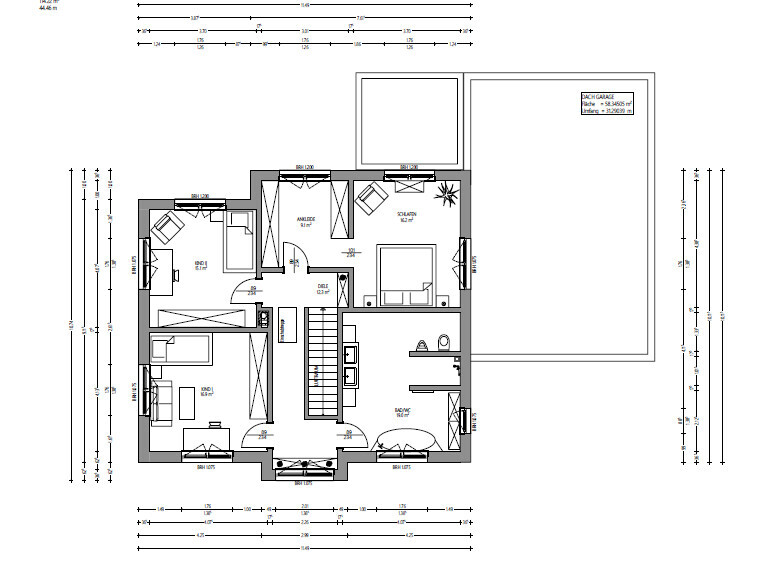

Hello everyone, we are in the final stages of planning our house and would like to get your opinion on our floor plans. The building permit / planning application has not yet been submitted, so changes are still possible.
Urban villa / hipped roof
Plot size: 615 sqm (6620 sq ft)
Orientation: Entrance facing east, garden area southwest
Number of parking spaces: 2 plus a large garage (6 x 6 m) (20 x 20 ft)
Roof type: hipped roof
Style: modern
Owners’ requirements:
Style, roof type, building type: urban villa, modern
Basement, floors: without
Space requirements on ground floor and upper floor: everything shown in the floor plan
Open kitchen
Number of dining seats: up to 10
Oven / stove: yes
Garage, carport: garage
Energy: air-to-water heat pump and possibly an electricity storage system with solar panels
At the moment, we are considering moving the kitchen to the other side and creating a passage to the utility room. This would change the shape of the bathroom, making it longer and narrower, and allow us to enlarge the utility room so it could also serve as a pantry.
The layout upstairs should remain as it is. We know the bathroom is quite large, but if possible we would like to keep it that way. The window arrangement is not finalized yet. We would appreciate any suggestions.

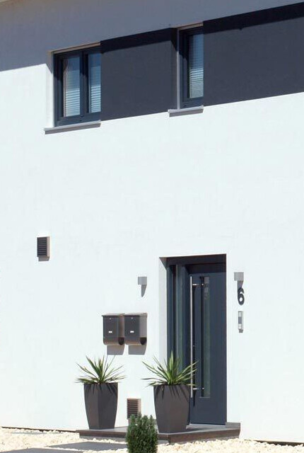

What is that? Well, did I explain that poorly? – Smokey Eyes refer to this delicately shaded dark gray "eyeshadow" effect around the windows, usually when the upper ones are not perfectly aligned above the lower ones.
Well, did I explain that poorly? - Smokey Eyes are these beautiful dark gray "shadows" around the windows, usually when the upper ones are not exactly aligned with the ones below. I think I have never seen anything like that. What do you search for on Google?
kaho674 schrieb:
I think I’ve never seen anything like that before. What do you even google for that? If you have never seen that before, you must be living on a blissful island. You would google something like city villa:
The architect has now changed the room layout. The bathroom was also enlarged (for whatever reason), and the rooms next to the master bedroom were removed. I told him that I don’t want the door from the hallway to the walk-in closet but would prefer to have a door directly into the bedroom again. What do you think?
