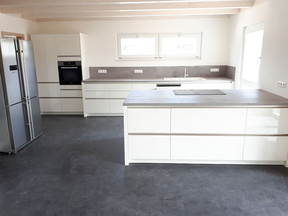

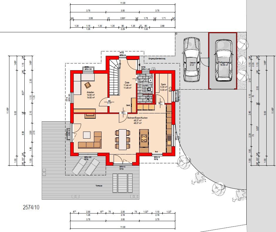

As inspiration, I have attached our floor plan as well as a picture of the kitchen.

Great, thanks. I really like yours, and the upper part is very similar to ours. I also like the option with the bathroom in a different location; although we wouldn’t have direct access from our bedroom anymore, we would have more space in the bathroom since we would need one less door. I have forwarded this to our architect. I also really like the kitchen, although my husband insists on having an island. I thought the L-shaped layout was nice as well. We’ll see what it ends up being.
Your U-shaped kitchen is very large and will therefore be quite expensive. We have just purchased our kitchen and visited several kitchen showrooms. We experienced price differences of 6000 Euros for the same kitchen; however, our kitchen is not as large as yours.
