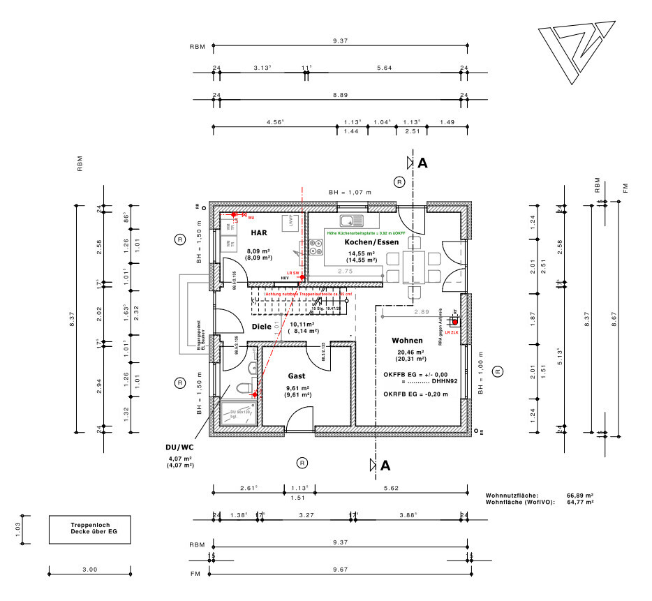

Who created the plan:
What do you particularly like? Why? Kitchen is open but still separated from the living room, reasonable size of children’s rooms, straight staircase
What do you dislike? Why? Open hallway (noise transfers upstairs, and you can see from the entrance door straight into the living room)
Preferred heating system: geothermal, air heat pump
If you have to give up something, which details/features
-can you give up: large master bedroom, large kitchen, large utility room, garage, dressing room?
-can you not give up: guest room
Why did the design turn out as it is now? E.g. Almost all our ideas were implemented on a small living area.
Standard plan from the planner? yes, revised
Which wishes were fulfilled by the architect? Straight staircase, guest room, kitchen in a niche, guest WC with shower, large children’s rooms.

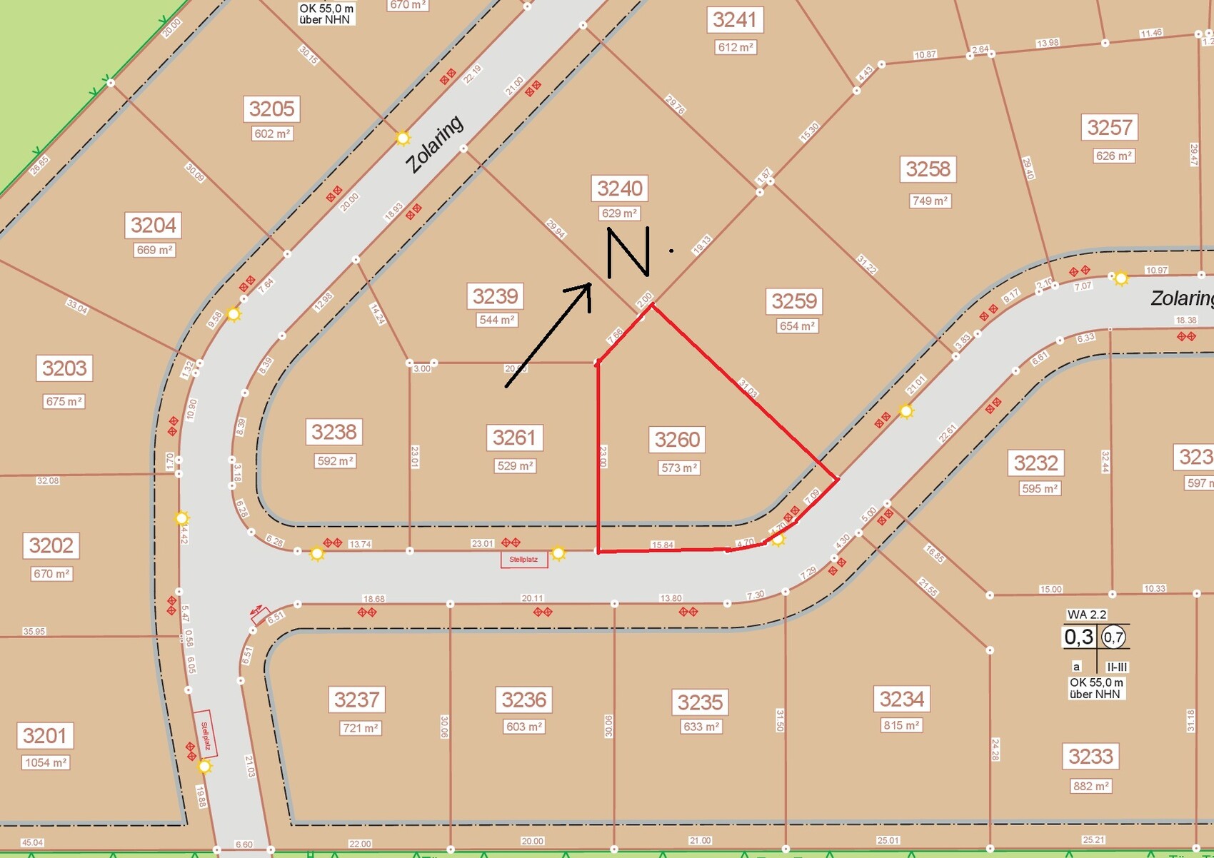

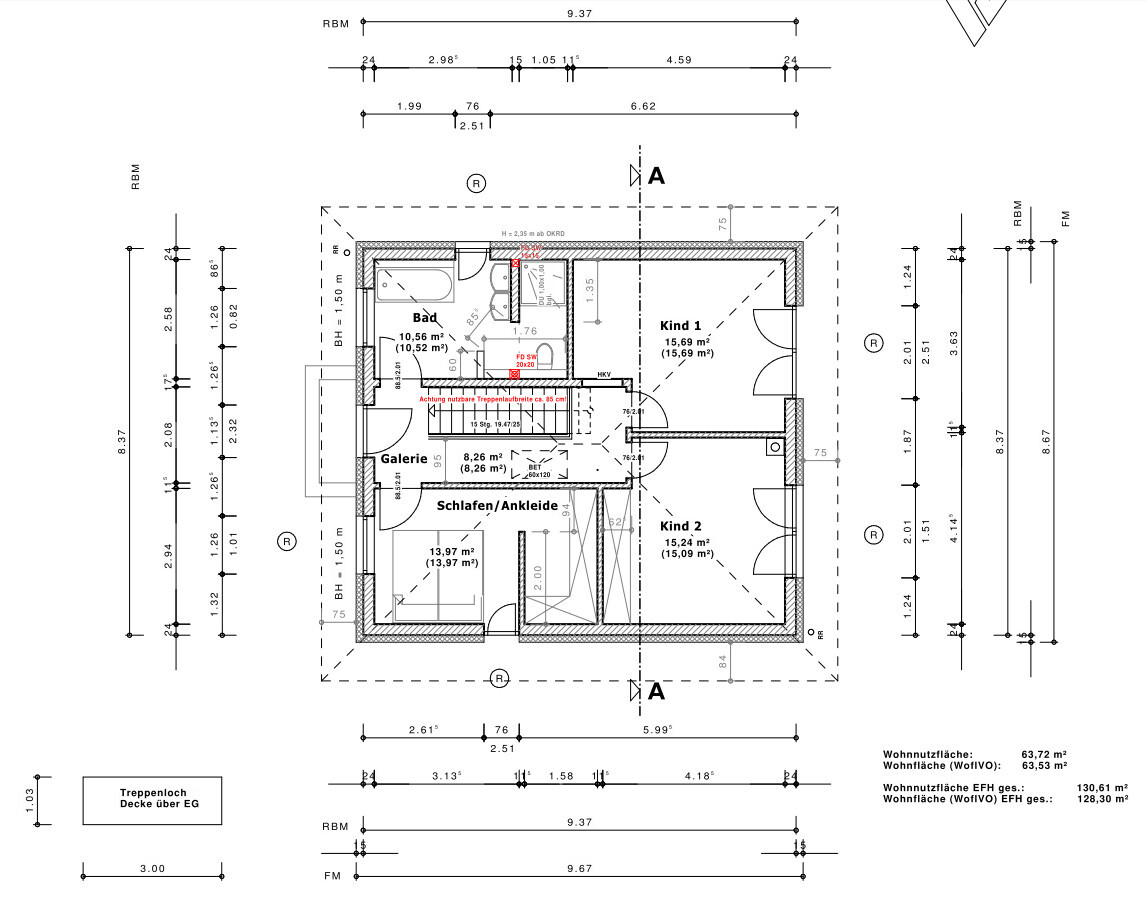

The orientation on the floor plan is incorrect; I marked the correct one on the site plan. The entrance will be planned from the street side. The dining area will be enlarged by shifting the kitchen about 40 cm (16 in) toward the utility room and shortening the stair wall. I am still not satisfied with window sizes and positions. The upper floor bathroom also needs improvement; we have an appointment planned at the bathroom studio.

Marvinius13 Jun 2017 10:33No door between the living room and the main entrance? I find that uncomfortable. A hallway next to the staircase over 3m (10 feet) long but only about 1.0m (3 feet) wide? That will feel very narrow. Your house might be too small to fit a straight staircase.
How should the passage from the hallway to the kitchen be designed? There should ideally be a clear opening of at least 1 m (3.3 feet). Consider planning a lift-and-slide door instead of hinged doors to the terrace, which will likely be more expensive.

Is the table really supposed to be placed as shown? Probably not, right?

Does your dining table really fit in that passage? How wide is the table that is supposed to go there?
What would bother me is that chairs always have to be moved when the patio doors need to be opened.
I would swap the walk-in closet and the bedroom. So the walk-in closet on the right, the bedroom on the left.

Marvinius13 Jun 2017 15:50In the catalog of a high-end supplier, whose name starts with V, there are interesting solutions for straight staircases.
