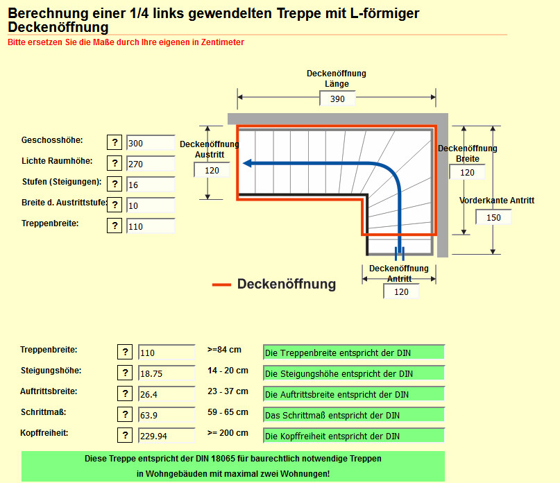

Stairs: The staircase will turn slightly near the bottom to fit the space. We’ve planned 4.3 meters (14 ft) of stairs with a ceiling height of 2.70 meters (8 ft 10 in). Is that enough?

The staircase should be carefully planned to get a better sense of it. For houses of this size, the stairwell opening in the ceiling should be at least 1.20m (4 feet) wide, preferably 1.30m (4 feet 3 inches). The stair landing at the bottom still needs to turn the corner – here about 1.50m (5 feet) is needed. With a ceiling height of 2.70m (8 feet 10 inches) (floor-to-floor height around 3m (10 feet)), 16 risers would result in a total run of approximately 3.90m (13 feet), so the steps have a comfortable size.
Depending on how far the staircase turns at the bottom (where actual steps are required), the doors will fit better or worse. The many outward-opening doors and windows are rather unusual. Is this really intended?
