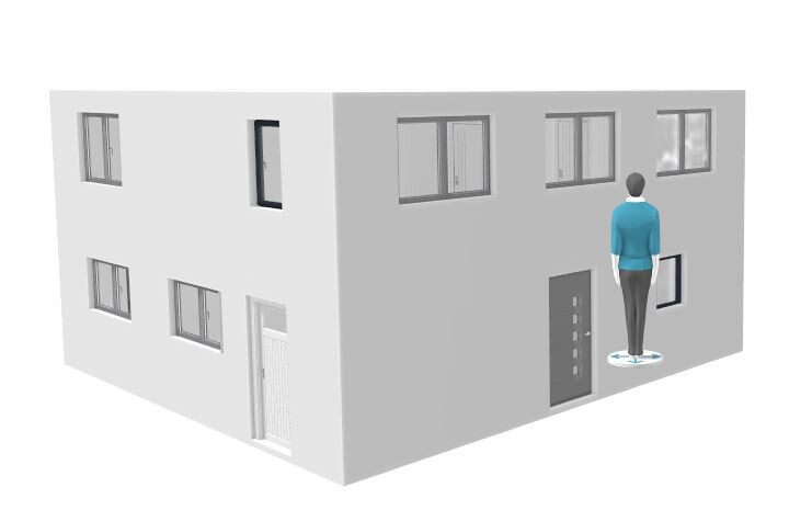

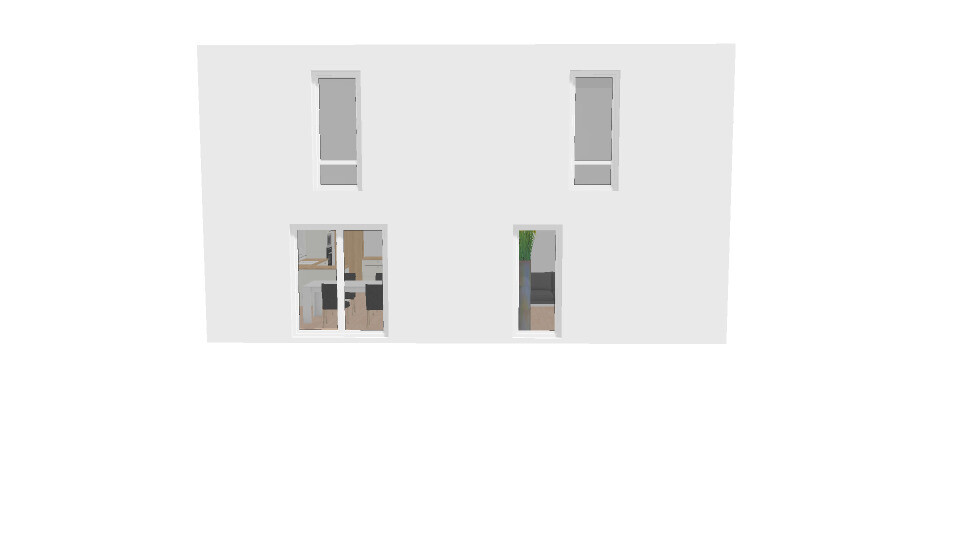

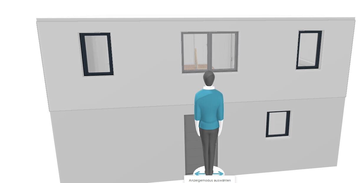

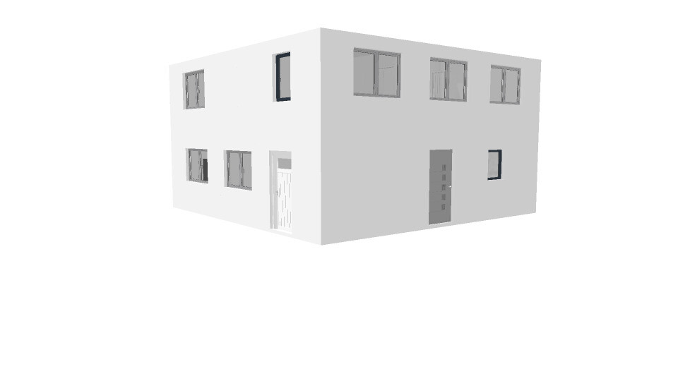

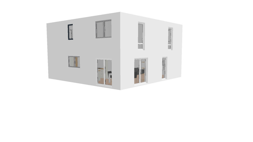

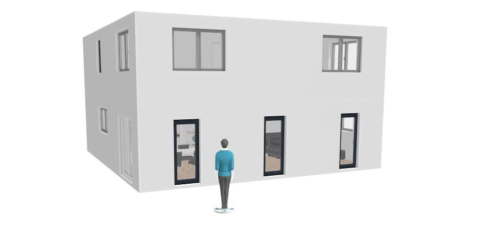

Mottenhausen2 Jul 2019 13:329.60 x 9.60 meters (31.5 x 31.5 feet) is quite tight if you want to include the full room layout (standard plus pantry, office, dressing room) together with a straight staircase. The staircase and hallway area take up 12 sqm (129 sq ft) on the upper floor and 10 sqm (108 sq ft) on the ground floor. That’s 22 sqm (237 sq ft) of unused space, which the rooms elsewhere desperately need.
The exterior views are a disaster (sorry!). The arrangement of the windows should follow intended lines of symmetry rather than being scattered randomly. At least the windows on the ground and upper floors should line up vertically. Symmetry naturally appears aesthetic to our brains; it is part of our nature.
Since this is meant as constructive(!) criticism: take a look at the Town & Country "Stadtvilla 145" or "152". These offer a relatively well-thought-out and refined floor plan on the same or similar overall dimensions.
