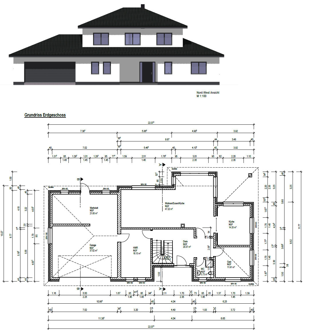

Yes, we already went for a long walk yesterday. However, with unfamiliar houses, you can’t really tell how wide their openings are.
Regarding the threshold: I think it only looks that way because the window installer quickly sketched both examples so we could better visualize them.
Here again is the front view and the floor plan of the hallway.
We’re also not completely sure yet which way the door should open.
EDIT: I have also considered widening the door by about 10cm (4 inches) or so if there is only one side panel. How wide are entrance doors usually?
The door opens as shown, which I believe is correct. For a bright hallway, I would also recommend planning for only one sidelight to reduce the amount of framing. I would maximize the door plus sidelight to fit the available wall space.

Structural opening widths of 101 cm (40 inches) – preferably just behind the reveal – and 113.5 cm (45 inches) are practical. A clear passage width of 100 cm (39 inches) is acceptable; I wouldn’t recommend going more than 10 cm (4 inches) beyond that.
