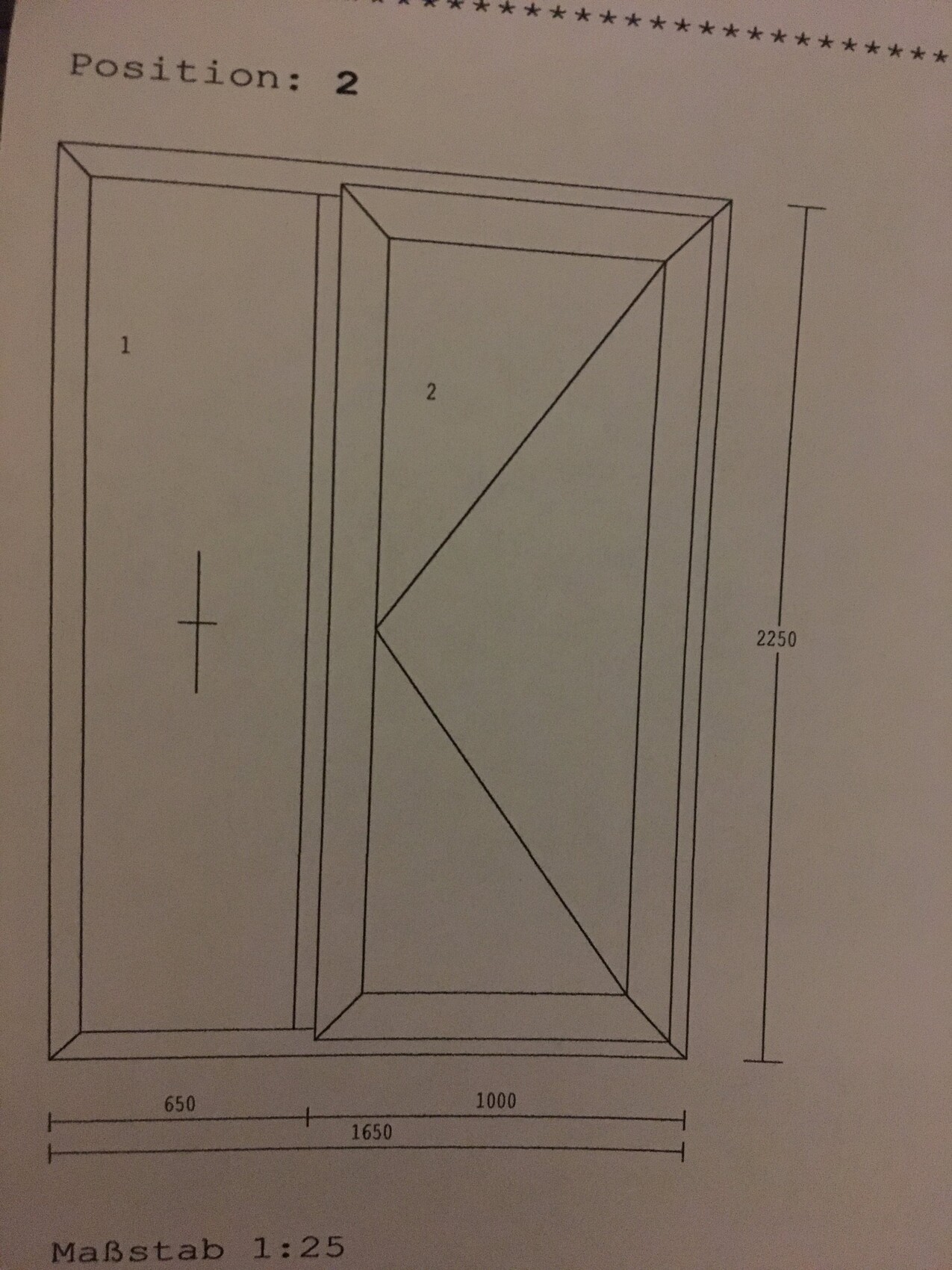

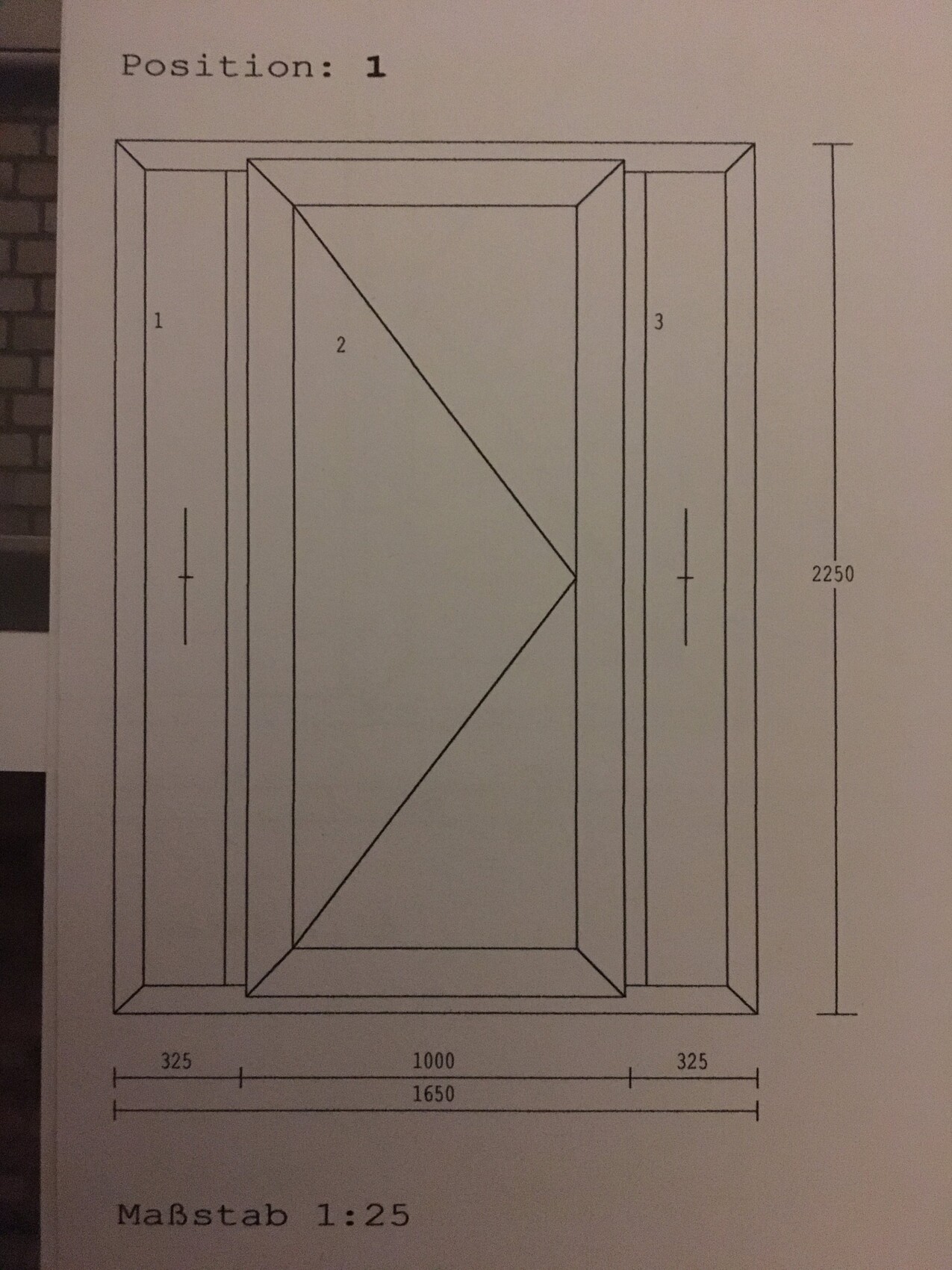

Good evening,
we are now choosing between a door with one sidelight or two. It is difficult for us to imagine how it will look, but we tend to prefer one sidelight.
Technical door passage drawing with dimensions and frame view, position 1
Technical floor plan of a door with dimensions and frame details.
hanse987
3 Oct 2018 21:33
I would choose one side panel. With two side panels, you end up with more frame than glass.
Alex85
3 Oct 2018 22:01
One thing is clear: the width is not enough for two. With 32.5cm (13 inches) minus the frame, there is not much glass left.
Option 2, where I would add another 10cm (4 inches) to the door width if possible.
Snowy36
3 Oct 2018 22:29
I think the proportions don’t work with a single-piece design... in my opinion, the side panel is too wide.
3 Oct 2018 23:14
I would base it on the hallway 😉
11ant4 Oct 2018 00:54
With these dimensions, I would also lean toward having only one side panel (and a few centimeters more door width). The drawing appears to show a patio door without a low threshold (?)
