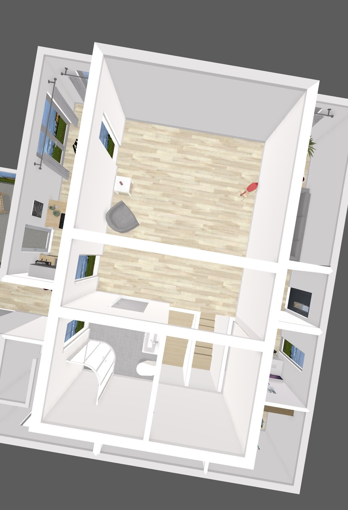

Zweithaus17 Sep 2021 16:40ypg schrieb:
😱 Don’t you see the problem with the staircase??? A staircase has the starting step on the lower floor, where it’s accessible. On the upper floor, it has the landing on the opposite side. I can’t believe someone thinks they understand this when they haven’t even grasped the basic concept of how a staircase connects two floors.
As for the rooms that are 1.80 meters (5 feet 11 inches) wide... 5 square meters (54 square feet)... I can only shake my head. Detention cells have more width and square footage than your “confinement cages.”
The kitchen is another tiny cage. The only reasonable room seems to be the bedroom. The room on the upper floor is intended to be a storage room. The staircase is indeed not functional….
Z
Zweithaus17 Sep 2021 17:00Zweithaus schrieb:
Here is my revised upper floor plan.
However, the ground floor plan would be more important to me for your analysis. Here is the situation for the ground floor. This already makes it unlivable:
5 square meters (54 square feet)... I can only shake my head. Detention cells have more width and square meters (square feet) than your "hold rooms."
The kitchen is also such a small enclosure. The only reasonable room seems to be the bedroom. P
pagoni202017 Sep 2021 17:41I prefer the analog approach rather than simulated versions, where simple problem areas can be overlooked because of fancy visualizations. No one can make sense of the last view of the upper floor...
My advice is to set the computer aside for a moment and take the time to provide us willing participants with all the necessary measurements (hallway width, windows, doors, etc.), properly name each room, and clearly explain what exactly you are aiming for.
It might also be due to my limited imagination, but in the current form, I find it really difficult to engage with this.
