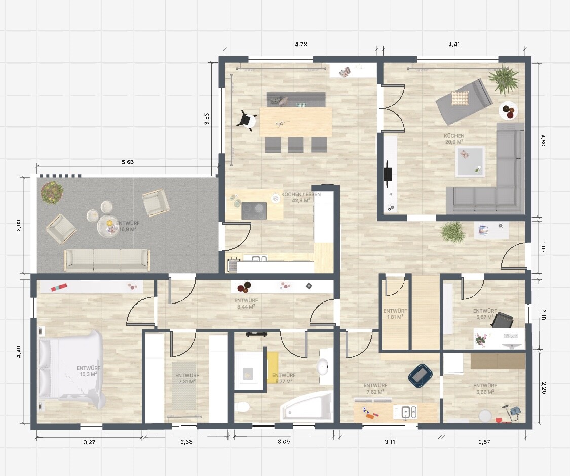

Hello, I hope I have optimized the floor plan.
On the upper floor, there will be a small bathroom with a shower and a children's room.
Floor plan of a residential house: kitchen, dining room, living room, bedroom, bathrooms
kbt09
17 Sep 2021 15:23
On which upper floor? The staircase, which might be roughly indicated there on the ground floor, can only be a maximum of 190 cm (75 inches) wide with walls.
Maybe edit the screenshot by removing the unnecessary top and bottom margins and add the property boundaries with a north arrow to the drawing.

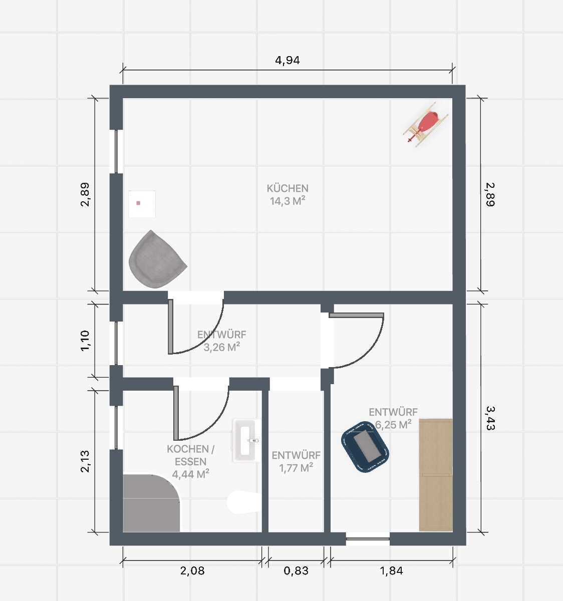

So, once again.
The staircase definitely still needs improvement….
Floor plan of an apartment: Large kitchen (14.3 m2) with seating area, cooking/dining area, and corridors.
Floor plan of an apartment with kitchen, dining area, living room, bedroom, bathroom, and terrace.
kbt09
17 Sep 2021 15:40
Sorry, but where exactly does one arrive on the upper floor? And what type of roof does the building have? Also, what was the site layout and its orientation again?

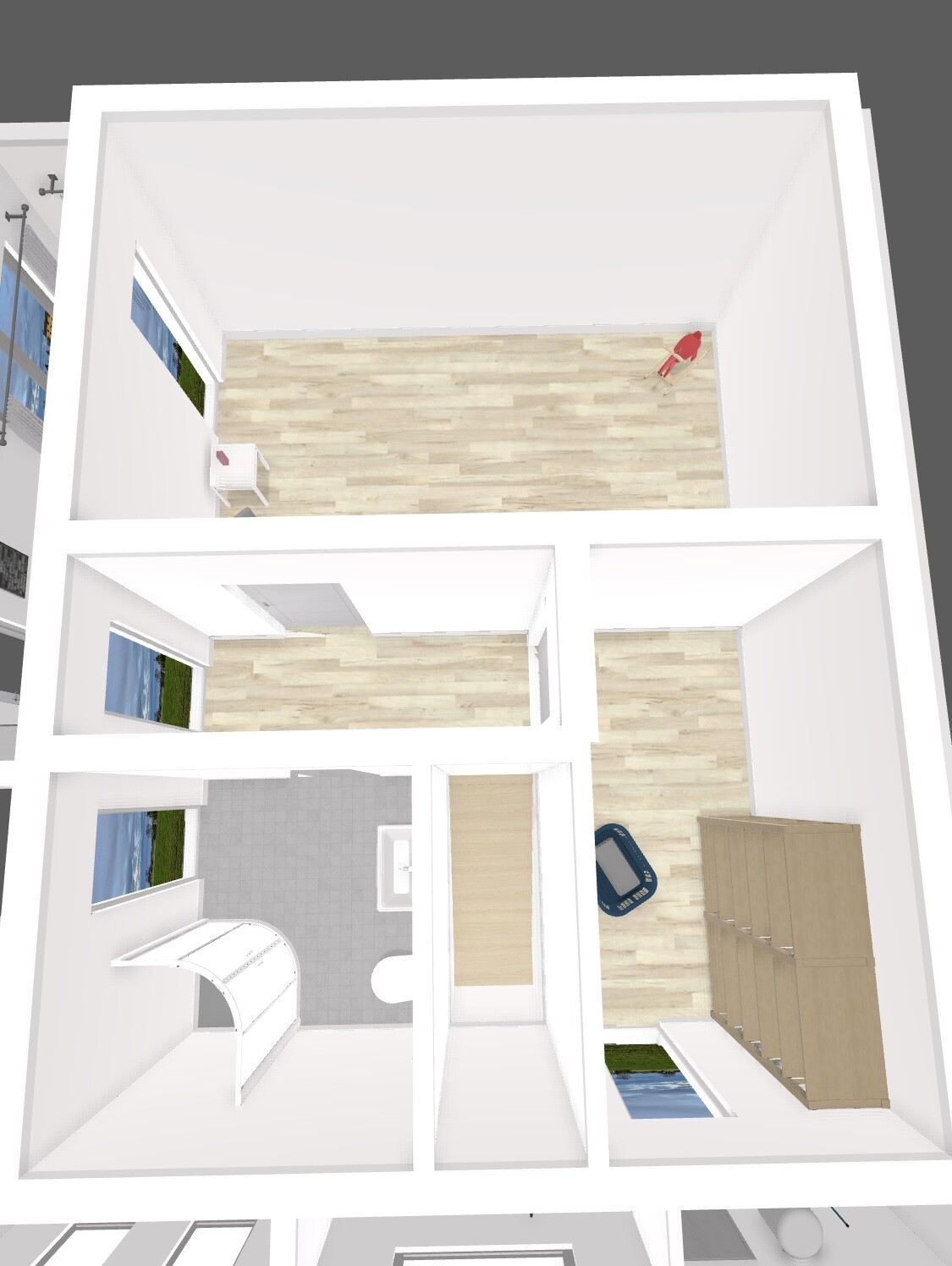

The front door faces north.
The house is planned as a bungalow with a recessed upper floor.
3D top view of an apartment floor plan: Large living room with a red chair, bathroom, hallway, and walk-in closet.
E
Evolith
17 Sep 2021 15:50
Why are you placing the staircase right in the middle of the house? Why not position it between the living room and the office? That way, you would have a nice, open hallway instead of that awkward, cramped space. Besides, a staircase doesn’t necessarily have to be the most visually prominent feature in the house. As it is now, it’s really being put right in everyone’s face.
Also, your living area hallway will be quite dark. If you removed that unnecessary connecting door, it would look better—especially since you’ll probably keep the door open anyway.
