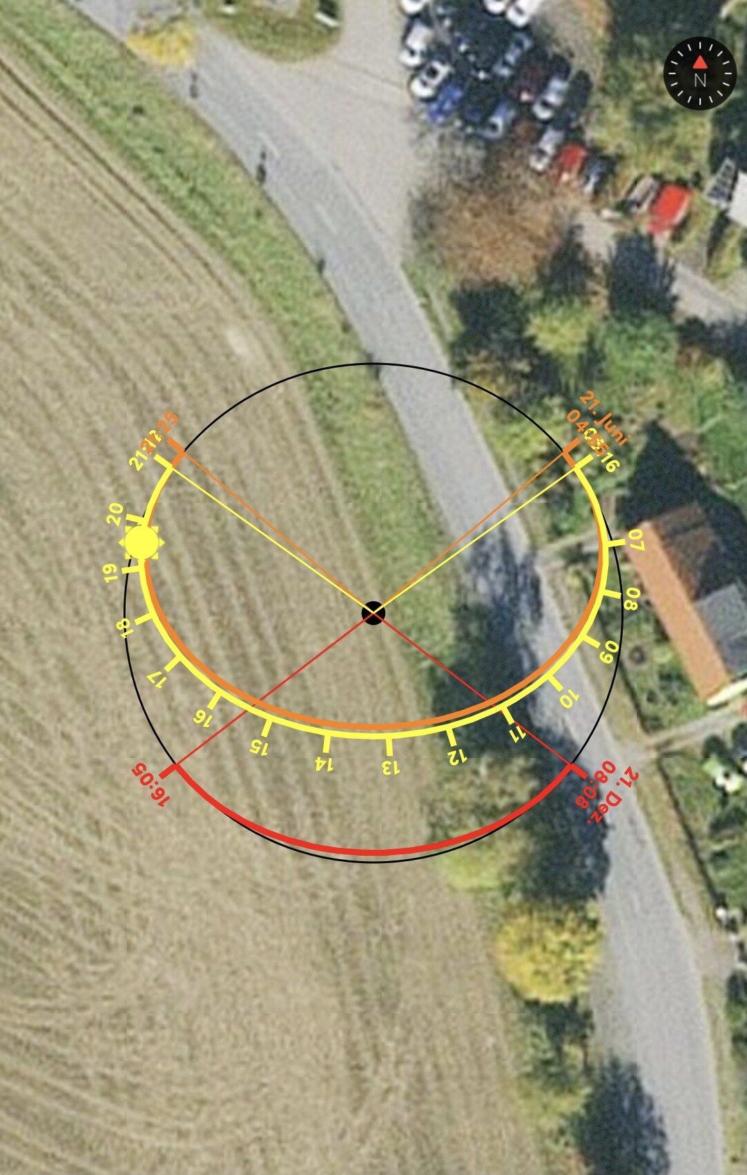

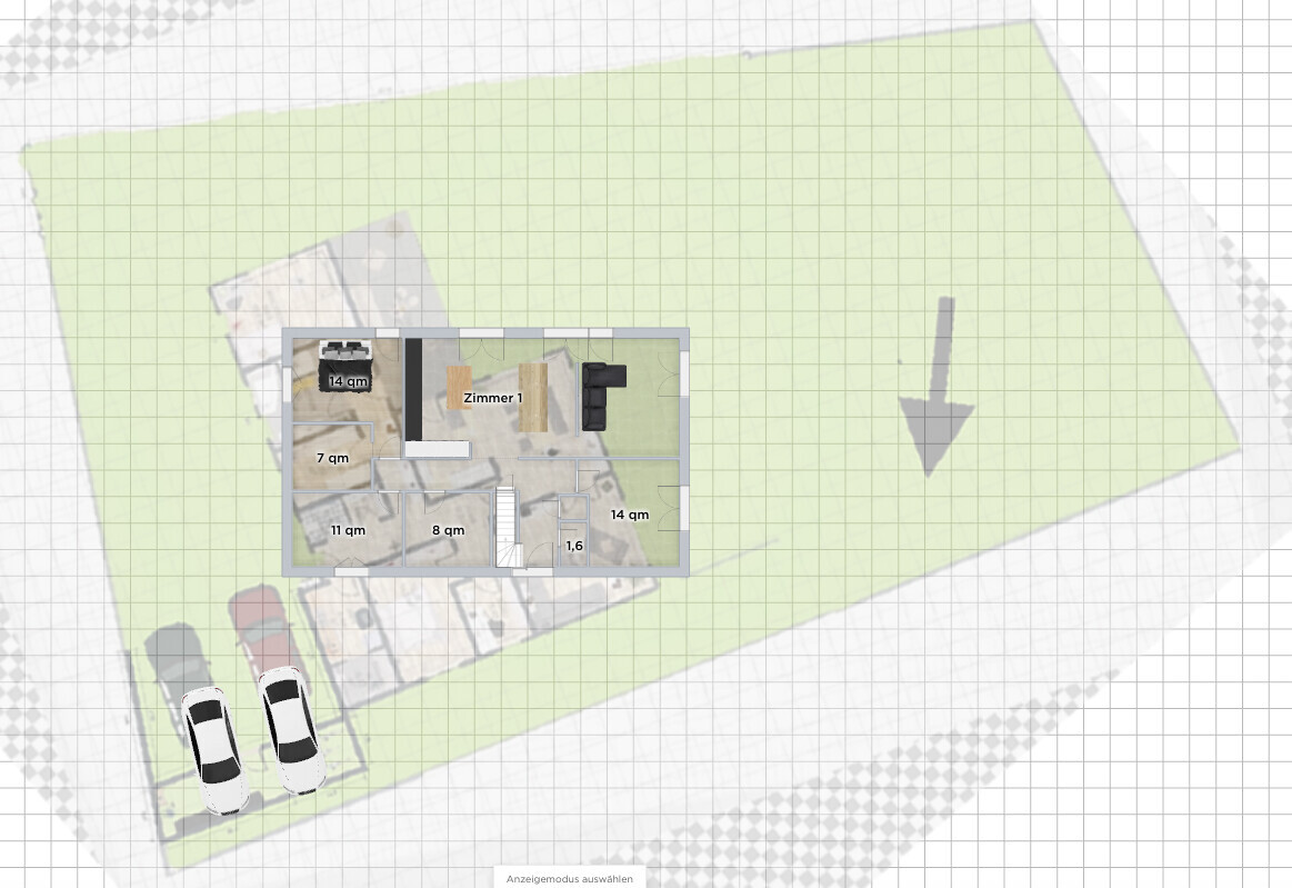

Hello, I would like to hear your opinions. What do you think? Are there any suggestions for improvement? The west side faces open fields, so we wanted the living room to be oriented that way.

Orientation: west
Small office, only for emergencies
3 people aged 38, 38, and 2
No overnight guests
Large kitchen with dining area, separate living room, covered terrace
- Do-it-yourself
We considered all the desired rooms.
Access from terrace directly to kitchen and bathroom.
The main house will have a gable roof to allow attic space for storing boxes. The pull-down staircase can be installed in the long hallway. The part with the covered terrace will have a flat roof. However, we are not sure if having two types of roof will be expensive.

Zweithaus18 Jul 2021 15:18ypg schrieb:
Were the dimensions of the plot mentioned anywhere? The numbers are unreadable both on my phone and computer.
To add up the house measurements and calculate proportions honestly, I’m too lazy. The plot is approximately 28m (92 feet) wide on the street side and 35m (115 feet) long. On the west side, it narrows to 18m (59 feet).
The exact site plan will only be available after the final development and survey at the end of the year.

Zweithaus18 Jul 2021 19:35Here is my response to your questions.
I know... it might look a bit disappointing. But I’m not creating dream houses here in the forum that are unaffordable with the given budget.
The exterior dimensions are approximately 15.40 x 9.40 meters (50.5 x 30.8 feet). About 120 square meters (1,292 square feet) of living space. Adding a finished attic creates a nice children’s room, a shower toilet, a handy storage room, and an attic.
With this budget, you can build out the ground floor and run the utilities upstairs to set up one room (office, later a children’s room).
If you are financially more flexible in about 10 years, a conservatory or sunroom would be suitable. The foundation slab can already be built now, which would then become the terrace.
I haven’t put much effort into the windows yet, as they can be modified later.
I know…it may seem a bit disappointing. But I’m not creating dream houses in this forum that are unaffordable with the given budget.
The exterior dimensions are approximately 15.40 x 9.40 meters (50.5 x 30.8 feet). About 120 square meters (1,292 square feet) of living space. Adding a finished attic creates a nice children’s room, a shower bathroom, a useful storage room, and an attic.
With the budget, you can finish the ground floor and run the wiring upstairs to finish a room there later (office, later children’s room).
If you are more financially flexible in about 10 years, a conservatory or sunroom would be a good option. The slab foundation can already be built now and later converted into a terrace.
I didn’t put much effort into the windows yet; they can be modified as needed.
[ATTACH alt="bungalow-grundriss-3-personen-130qm-bitte-meinungen-511742-1.png"]63912[/ATTACH] Thank you very much! I really think the positioning on the plot is well done. All the rooms are where they belong, so it is very well planned.
Thanks for the suggestion.
Consider whether you could be comfortable with an office in the attic. This would relieve the space situation downstairs and make the hallway design much more pleasant.
Always keep in mind that in a bungalow (or a hybrid like this), you end up walking a lot through the hallways. They should therefore always have good lighting, not be cramped or awkwardly shaped, and look appealing.
