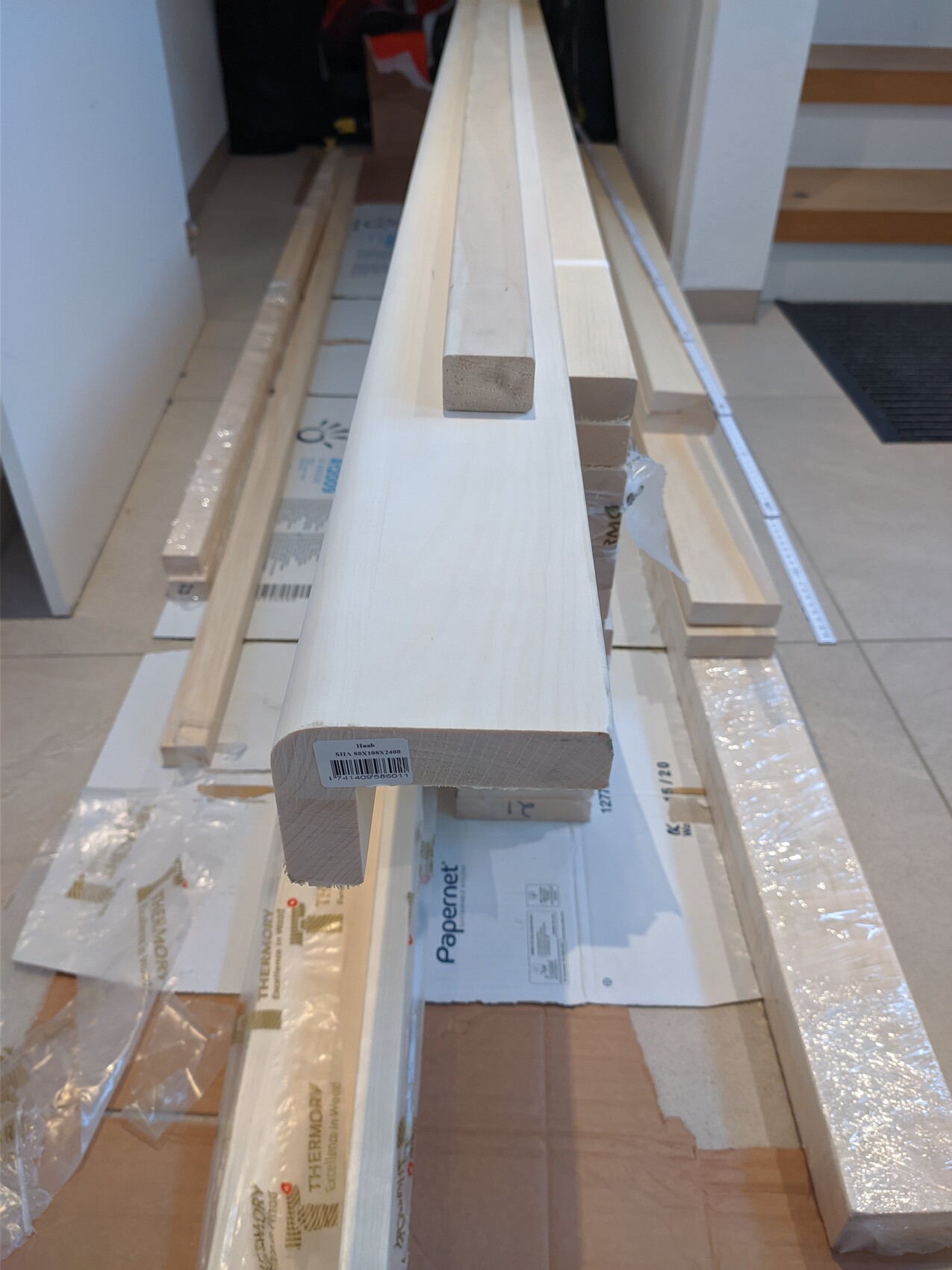

I ordered the bench slats from Saunainter in Estonia because they were the only ones offering such nicely rounded bench slats for the front side of the benches, which really caught my eye.
So, I went ahead and designed the bench construction in 3D using the available bench slats from their selection and calculated the quantities. In the shop, I then put everything together accordingly and requested a discount. Since shipping costs up to €1000 (about $1080) are €100 (about $108), I also ordered sauna stones and the sauna control unit to qualify for the shipping cost.
A discount was granted, and I placed the order as agreed.
To be on the safe side, I paid via PayPal.
That was on 12/04/20. The delivery time was stated as 14 business days, so I assumed the shipment would arrive before Christmas.
When it didn’t arrive, but I was busy working on the cabin anyway, I didn’t initially see a reason to ask about the order status. I’m really not the type to make a fuss immediately, especially since I’m aware of the whole situation with COVID, holidays, and the high demand for sauna materials.
However, after still having no updates by 01/08/21, I contacted the shop by email. I immediately received a reply that the shipment was planned to be sent the following week and whether I could wait until then. I agreed — what else could I do.
By 01/19/21, I still hadn’t heard anything. I was starting to get a little impatient, so in the meantime, I tried calling the hotline without success and then contacted the shop again by email, mentioning the opening of a PayPal buyer protection claim as a last resort. Since I received no reply, I kept trying the German hotline multiple times — I NEVER got through once... 😡
I opened the PayPal case on 01/22 since there was still no communication from their side.

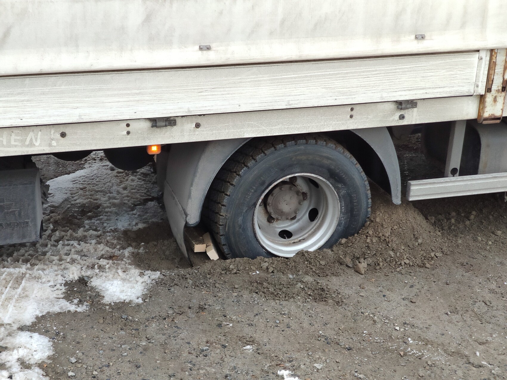

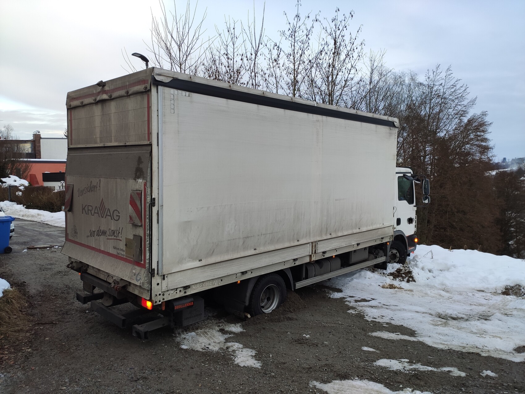

Then, yesterday, there was a knock at the door, and the delivery guy from the freight company was standing there, unannounced.
The friendly driver actually got his truck stuck and partly buried while turning around on our gravel driveway (which was a construction access road; much larger trucks have turned easily before).
After digging out and placing wood under the wheels didn’t work, he had to call a colleague who, with great effort, managed to get him out again.
At one point, I was really worried he might drive the truck down the slope. That wouldn’t have been great for my delivery... 😉
So, I’m happy that everything is finally coming to a good end and accepted the order after 2 hours of truck battles.
And what do I discover when unpacking? That these guys packed me the wrong sauna control unit. 🤨
They sent me the Harvia version for Finnish stoves, not the one I ordered for combi stoves.
Now, I have to continue my dispute with them through PayPal. I have demanded a refund for the control unit, stating that I am happy to return the item if the seller covers the return shipping or provides a shipping label.
I’ll order the control unit elsewhere — I’m definitely not ordering from them again.
The wood looks alright overall, but the pieces vary in color. I hope it won’t be too noticeable or that the color evens out during use.
