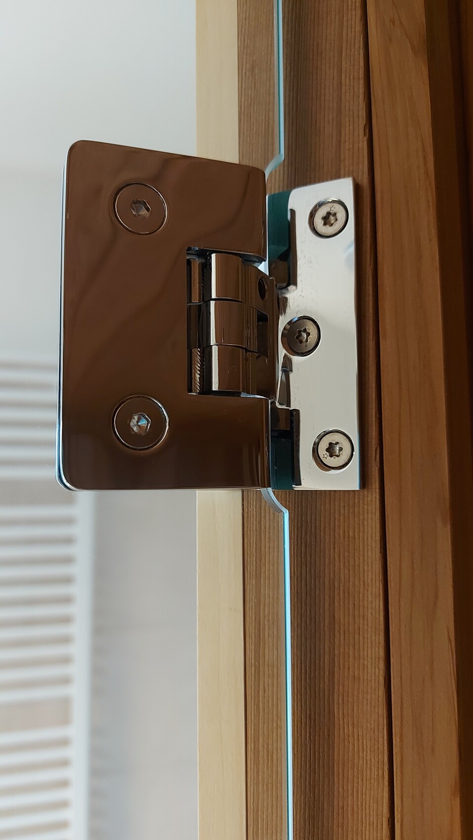

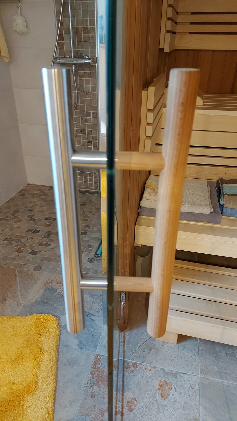

So, I’m back. Could have saved myself the trouble 😀
The seals are not included; the door hinges cost 75€ each. If I want to get some from the internet, I can do that.
As for the handle, he doesn’t have anything to offer anyway, since they are all made of metal, which gets too hot inside. I’m supposed to get something online anyway.
He was confused about the glass; it doesn’t have to be laminated safety glass (LSG / VSG), toughened safety glass (TSG / ESG) 8mm (5/16 inches) is sufficient. This also makes everything much cheaper. The glass alone costs around 300€, plus 1–2 hours of installation. I’m currently estimating a total of about 500€.
So, if anyone has a recommendation for a nice handle and door hinges, please share 😉
