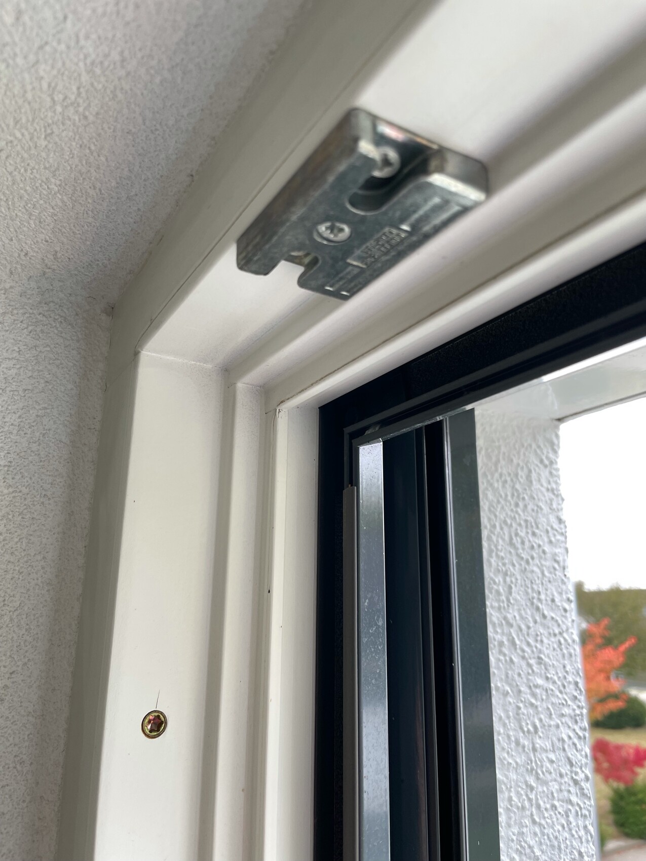

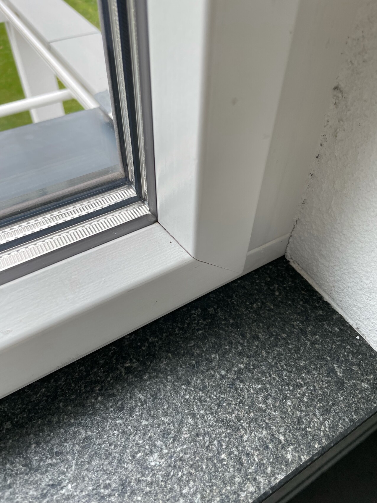

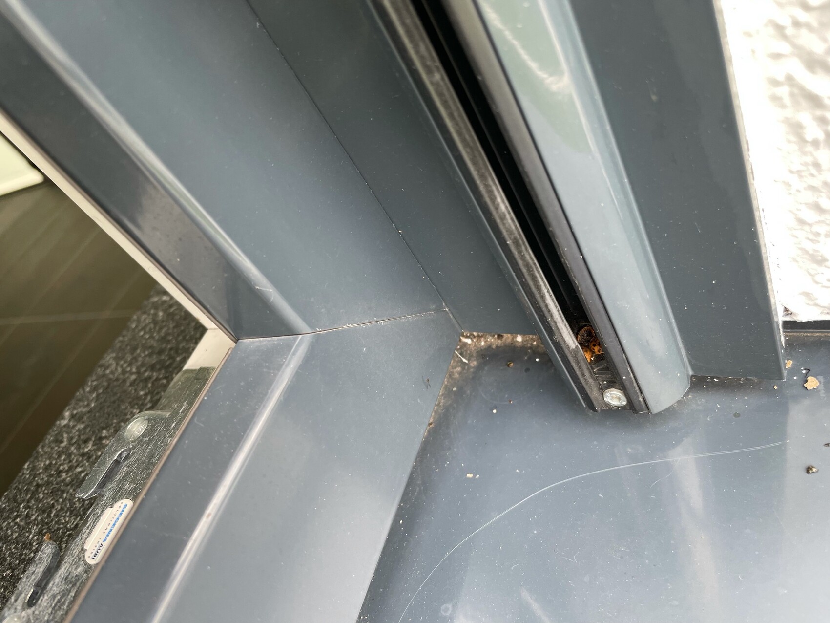

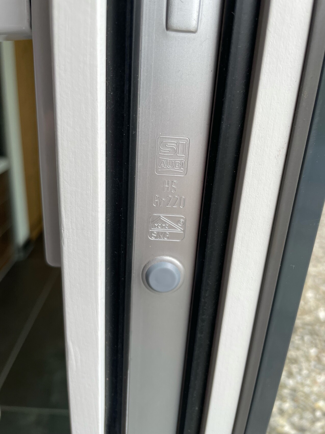

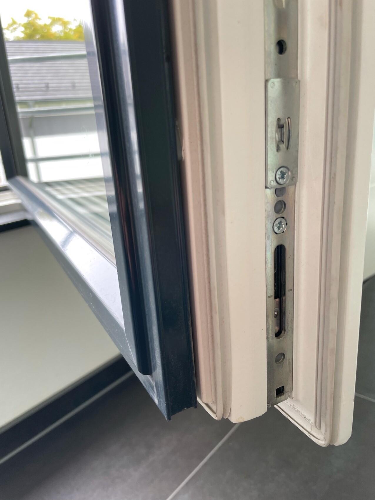

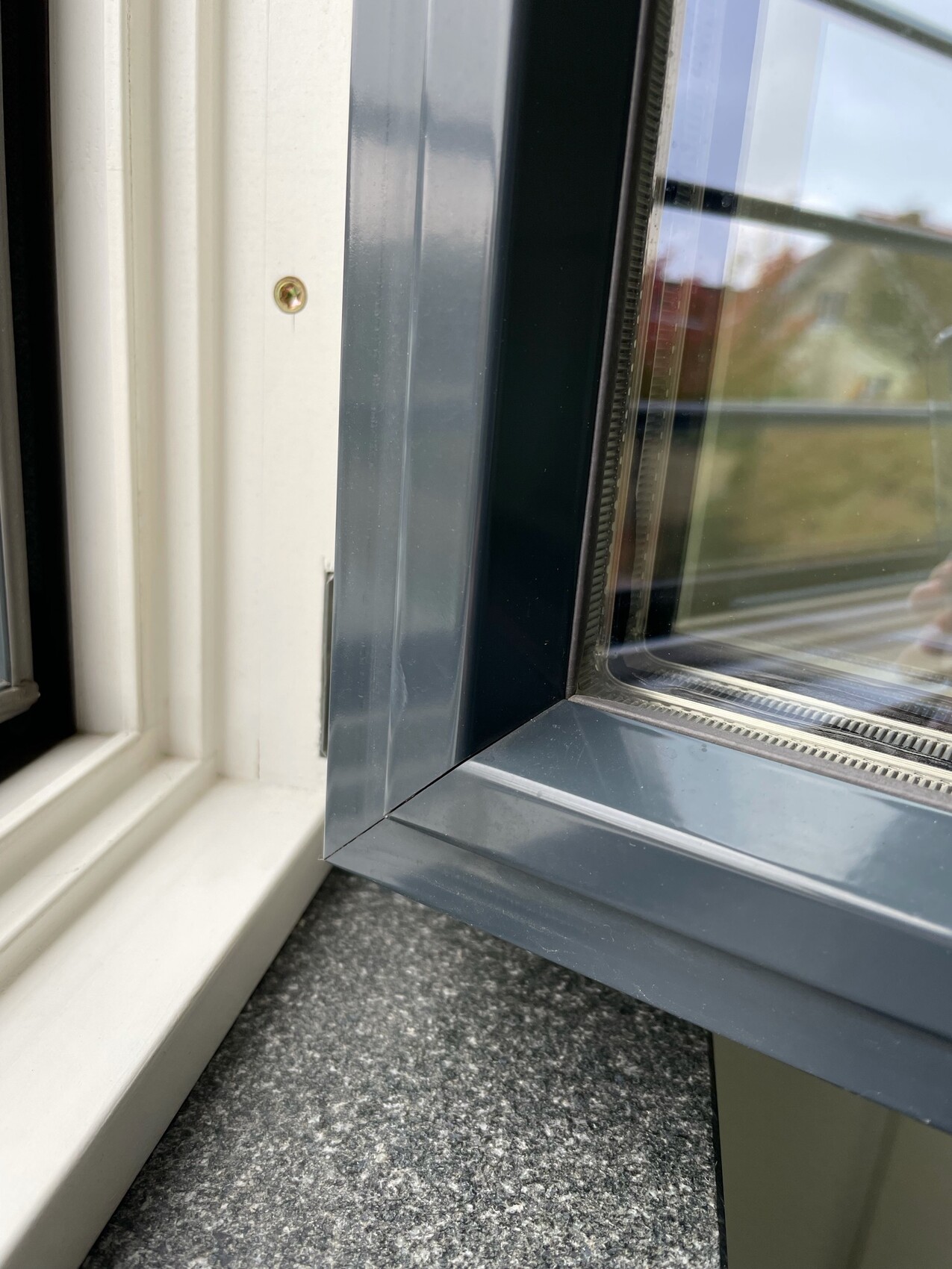

So, yesterday we spontaneously decided to visit the third show home from our preferred homebuilder. It was a good decision since this one actually had wood-aluminum windows installed, and they were even white on the inside, just as we originally WANTED.
Please take a look at this. I have to say, the quality didn’t really impress us that much. The aluminum cover strips don’t seem fully “welded,” but there isn’t much gap either.
The house was built in 2012, so it’s 9 years old now, and while that’s understandable, I actually plan to live in my house for a much longer time. Some of the handles even had a bit of play. There were also cracks visible at the interior corners 😱. That wouldn’t bother us (especially since we decided yesterday to have the windows both inside and outside in black, not anthracite), but if this is more a sign of “not good” quality, that would be quite disappointing.

Did you look at all the pictures? The cracks in the white corners? The brand of the fittings? Is all of that any good?
Then just take those! Thank you! Your encouragement means so much, considering all the decisions we (one) have to make.
I think if something here were completely out of line, a legitimate objection would also arise!?
