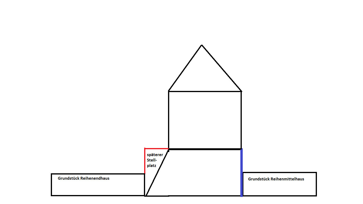

The slope must be graded anyway. You can't just place the house on a flat surface with vertical soil edges. Honestly, I don’t quite understand what you mean.That’s clear. The report says either the slope has to be cut back on the neighbor’s land or support elements must be installed.
For the terraced mid-terrace house, I will probably have to build a retaining wall. However, the question is whether I also need that for the house at the end of the terrace, since there is my 3m (10 feet) wide parking space in between, where I could grade the slope within my own property.
goalkeeper schrieb:
Only the house, meaning the approximately 7x10m (23x33 ft) area, will be filled and compacted, right?At least the house and the terrace, and as @Yosan rightly pointed out, they will also be sloped. Parking spaces next to the house can still be located "in front" of the slope, yes. The parking areas are subjected to considerable load from cars, so the slope needs to be quite stable. A slope of one and a half to one at 60° already requires about 87cm (34 inches) width. Are we talking about the building with or without a basement now?Please tell me the post number where the plot is mentioned.
goalkeeper14 Aug 2019 15:46The blue line on the right represents the retaining wall to the neighboring plot (which is about one meter (3 feet) lower).
To the left of that, there will be about three meters (10 feet) of parking space on my property, followed by about three meters (10 feet) of parking space for the adjacent end terrace house. The area marked in red will be our parking spaces. It would be simpler to wait until the neighbor backfills as well, so that the area can be backfilled together, avoiding the need for the retaining wall. Therefore, the question is whether the red area, where the slope is located, can simply be backfilled.
This scenario is considered without a basement, as originally planned.
Ah, now I understand what you mean. I would first consult an architect, structural engineer, or civil engineer. Cutting directly from the edge of the house could be challenging, especially if a height difference needs to be overcome within just 3m (10 feet). Regarding filling later and placing parking spaces on top, I don’t see any issues as long as suitable soil is used and it is properly compacted.
If the neighbor does not raise their ground level as well, you will need either the slope (in which case you will lose the parking space) or you will need retaining walls; you must have created the parking space by the time you build—regardless of whether the neighbor’s plans are already known or not. If the middle houses in your row do not raise their ground level, your house would have to be built on retaining walls—I assume you don’t mean that seriously, as I see your basement would then be sealed off.
