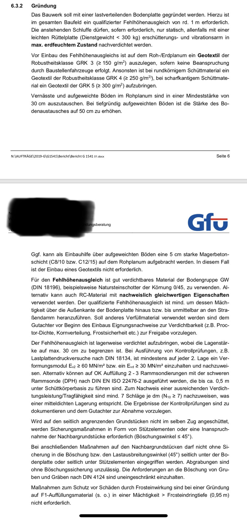

goalkeeper14 Aug 2019 14:45Our soil report has arrived (see attachment). It now recommends backfilling, but with retaining elements on the neighbor’s side or a slope on the neighboring property.
For the middle house, I will probably need to install retaining elements. However, can I simply slope down to the other neighbor since there is about three meters (10 feet) of space there? And can I then fill this slope so that I can create parking spaces above it? Or should retaining elements be installed there as well?

goalkeeper14 Aug 2019 15:1911ant schrieb:
Filling the slope? - I don’t quite understand that.The filling and compaction only applies to the house area, roughly 7x10m (23x33 feet), right? So, the slope can still be cut back on the left side, where our two parking spaces will be located later? This way, the slope would still be on my property towards the other REH neighbor.
