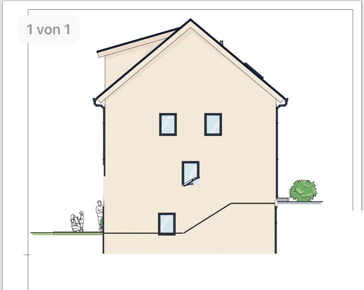

That’s why, with a 1.5m (5 feet) terrain difference between "as-is purchase" and "start of construction," I wouldn’t even consider placing the basement on the current unexcavated plot. Of course, it should be dug in so that the finished floor level of the ground floor matches the new reference zero level on the plan. Only then does it effectively correspond to the previous slab planning.
That’s what I assumed as well. Basically, the elevation now is roughly like this, right?:
View of a two-story house with a pitched roof, windows, stairs, and two people in the garden on the left
Just the question remains how to access the terrace. You either need stairs going up from the basement or stairs going down from the upper floor, if the garden level is left unchanged.
