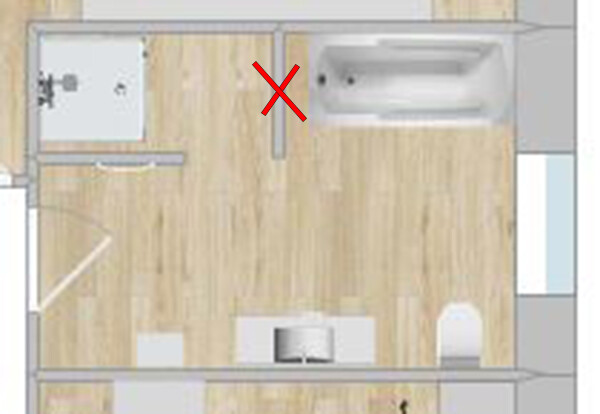

kaho67428 Nov 2017 17:26
Although I don’t find the wall between the bathtub and the shower necessary, it would allow more light in the shower area.
A corner bathtub might also look nice in this example.
Grundriss eines kleinen Badezimmers mit Waschbecken links, Badewanne rechts;Toilette unten rechts;X
RobsonMKK28 Nov 2017 17:30
If you now change the unnecessary T into an L, it will fit.
