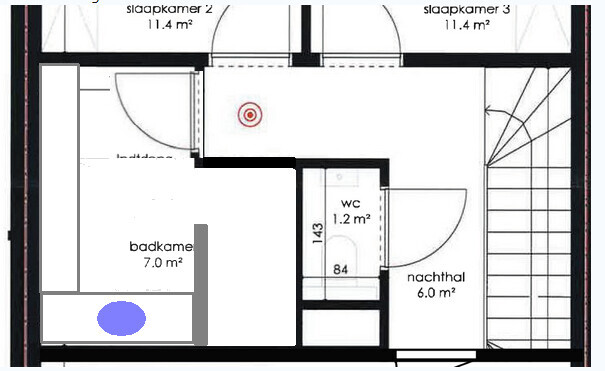

I am currently planning the bathroom (here, it’s called "badkamer"). Unfortunately, the bathroom has a difficult layout. There is a niche measuring 160cm (63 inches) in length and about 100cm (39 inches) in width. Would it be possible to install a walk-in shower there without flooding the bathroom when in use? 160cm (63 inches) in length seems quite short to me, as there would only be a glass partition of 110cm (43 inches). The shower entrance would be on the long side.
Or does anyone have other ideas for this bathroom? It should include a shower and one or two basins. Additionally, a radiator and possibly a cabinet for storage are needed.

Definitely a good idea to move the door:
So, like this ... All installations can then be placed along the lower wall:
On the left, there can still be storage at sink height, so no tall cabinets, unless you need that space.
This might cost a bit more because the door needs to be moved, but it allows the shower to be built with a wall and no door quite easily.

Bertram1006 Jan 2020 22:28UPS, relocating the door would cost 3000 euros. But I have found someone who can do it. The only concern I still have is whether this can be done easily or if there might be a structural issue at the new door location. In that case, it would probably be difficult to use a general handyman.
Is the wall only 11cm (4.3 inches) thick there? Generally, I wouldn’t see a problem with that. If the builder is offering it to you for 3000 euros (with what justification, actually?), it should at least be technically feasible.
What about the water connections? Especially the flush-to-floor shower drain? Is that that straightforward, or could it perhaps be included in the 3000 euros?
Although 3000 euros is quite a lot, in doubt I would bite the bullet and choose everything from a single source. That way, no one can later try to pass on potential mistakes to someone else.

Bertram1006 Jan 2020 22:50Yes, according to the plan, this is a thinner wall (I believe 11 or 13cm (4.3 or 5.1 inches)).
The contractor charges for the complete package: creating new plans, removing old materials, blocking up the door opening, building a new one, installing the door, re-plastering, and labor hours. Oh, and a quick-build wall at the end of the shower is also included. Still, I find it quite expensive.

Clarify whether the installation or setup of the connection for the flush-level shower is included.
If that is the complete package, I would pay the 3000 euros. Because handling everything as separate jobs costs money, and especially time. You also have to dispose of the debris from the demolition.

Bertram1006 Jan 2020 22:56Yes, the connection installation for the shower is included. A shower tray is required for the shower; unfortunately, a continuous floor won’t be done. I can still plan the connections myself.
I think I will commission the shower and the connection for the washbasin in the locations you suggested. It will initially be awkward when entering the bathroom, but once the door is repositioned, it should be fine. The contractor said that moving an interior door costs about 1000 euros.
